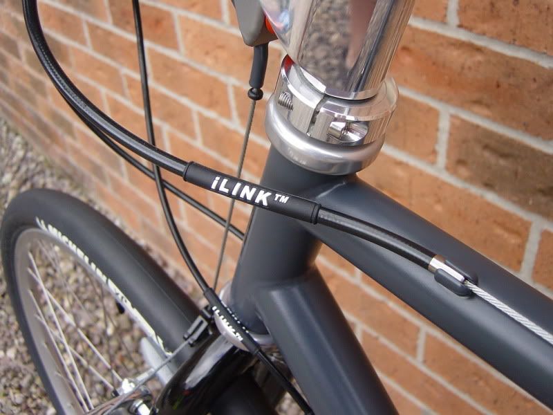

I never got on with my DX headset, kept coming loose ...
One of these would have fixed it though :
