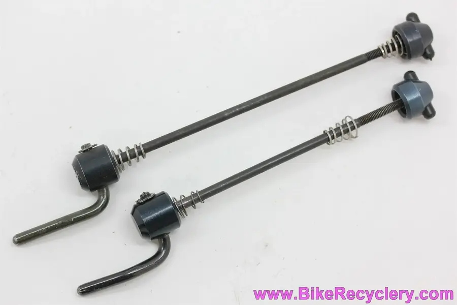

Has anyone ever taken one apart in order to replace the axle? You see I bought a road version on eBay on the cheap, assuming it would simply be a case of unscrewing both sides from the spindle, but of course... it seems like the side with the actual QR on is bonded somehow to the axle itself?
Thus thwarting my attempt to switch the actual QR parts over to another axle I had lying around.
I've read of plenty of people doing this on here before, with various other skewers, so wrongly assumed it'd be easy/fine with the AC kind!

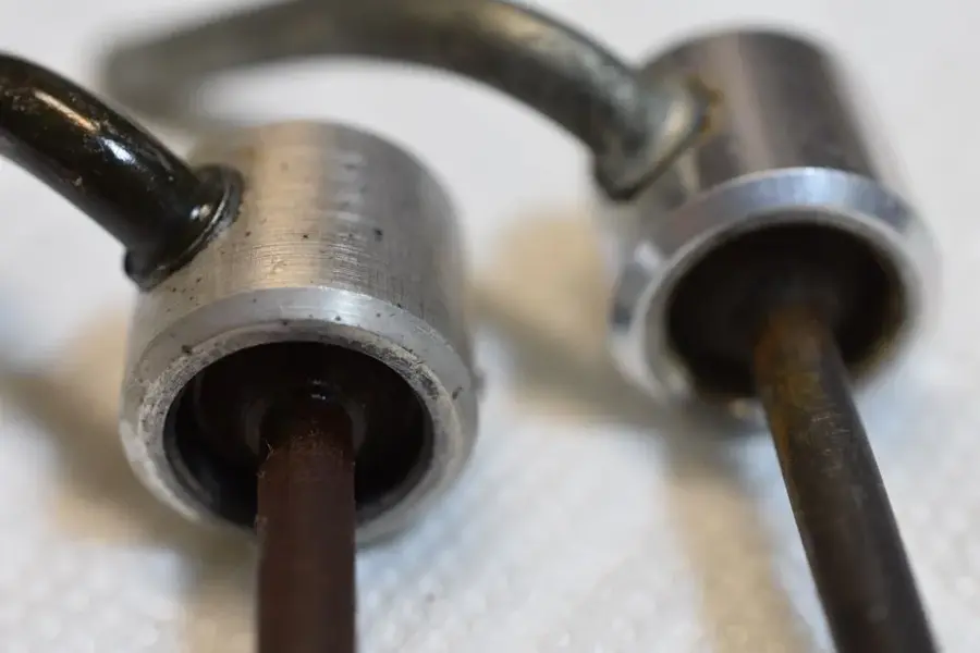

The QR handle itself passes through the main body, and is secured on the other side by one of those little pin clamp things. What's the right word for these!? And what kind of tool releases them!?! I've never really had to mess with one before!
You can just about make out what I mean here (most clearly on the left hand side of the middle one):
1990s_anodized_retro_mtb_parts_cook_bros_ringle_american_classic_1720__58242.1573261920.JPG

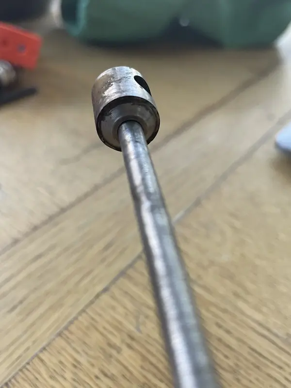

Anyway, assuming I can take all that apart, does anyone know if doing so will somehow allow me to unscrew the end from the threaded axle? You can sort of see where it joins here, and how it appears to be bonded rather than threaded:
If it is bonded, I assume I've just wasted $20?
Which is fine, because it was an experiment to see if I could figure out a way to gather an AC QR set on the cheap anyway!
Unless someone here knows, or has any other suggestions of ways I could try to release the end from the axle...

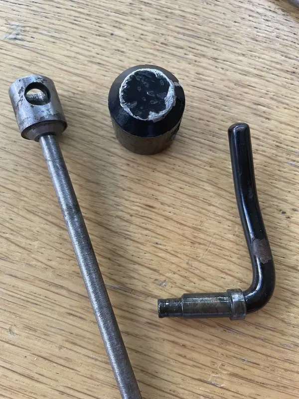

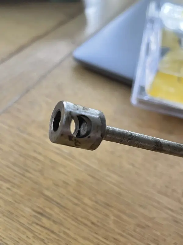

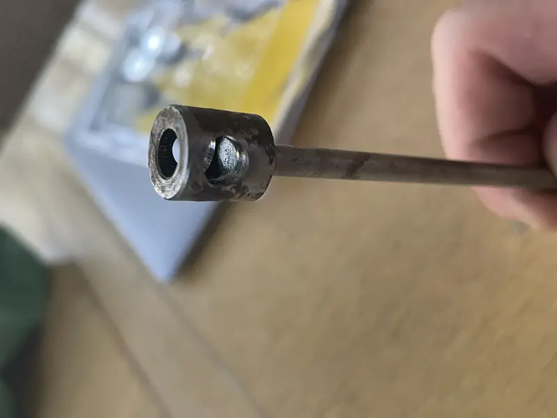

So bought the tool, took the clip off, took it apart, and it still appears the rod/axle is bonded somehow to that little nubbin up there, where the QR handle fixes through. I was hoping it would just unscrew from there, but for love nor money I can't get it to budge, and see no sign of any threads besides. It's kind of hard to get a good photo, but...
If its not bonded, well, then it's still not coming off!
Anyone? Looking more and more like I won't be able to make use of this bargain find...
