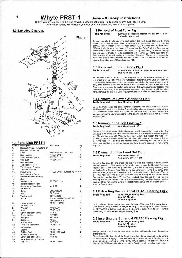

Hi All PRST experts.
I have a 4 that i am about to attempt a spherical bearing change. Is there a step by step on the web anywhere so i don't fall into any holes with this service job
And FYI i have owned a PRST1 and a 4. Great bikes. Was always told to run the rear shock at the same psi pressure as my weight in pounds and the front at 75% of that. Always worked well for me.
I also flipped the stem, and ran a crud guard on the front wheel to increase the shock service time.
I'd appreciate your help with the bearing change.
Thanks D
Hello Mr Gudge.
Changing the spherical bearing isn't difficult. You need to undo the bolt through the spherical bearing, and remove it, then let the forks pivot away from the rest of the bike.
Undo the front shock lower nuts inside the Y shaped lower wishbone 8mm I think. You might need a longer reach socket to get to them, and you might need two of them to stop the threaded stud that the shock mounts to turning. Then use an allen key to undo the allen screws holding the lower wishbone to the frame, and remove the threaded stud that goes through the bearings.
You should now have the Y shaped piece free of the bike, containing the spherical bearing.
On the left side of the bearing, you should see a small hole, containing a grub screw? Undo this, and remove it.
Now, support the sides of the bearing housing and use an appropriately sized socket to press out the spherical bearing. Remember to only push on the outer part of the bearing, not the middle, otherwise you will ruin it.
Just reverse this procedure to fit it all back together again.

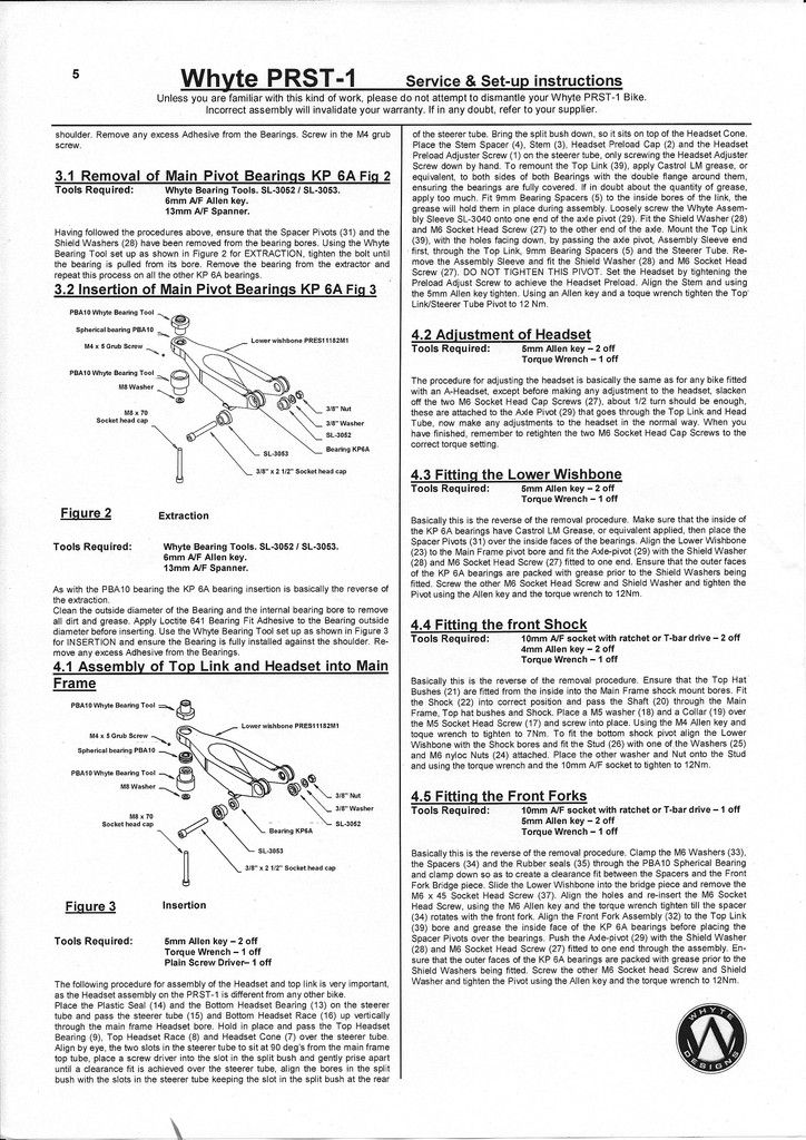

Hi, I'm sure the original manual said about bedding in the spherical bearing with non setting compound, can't remember what I used. I'll have a look when I get home to make sure I'm not talking out of my a...
Re: Prst4
I think I read that somewhere too. Bearing glue??? Not sure what that is, but would appreciate any advise
Hope those 2 pages help, the bearing adhesive I used was Bondloc B641 Bearing Fit.
