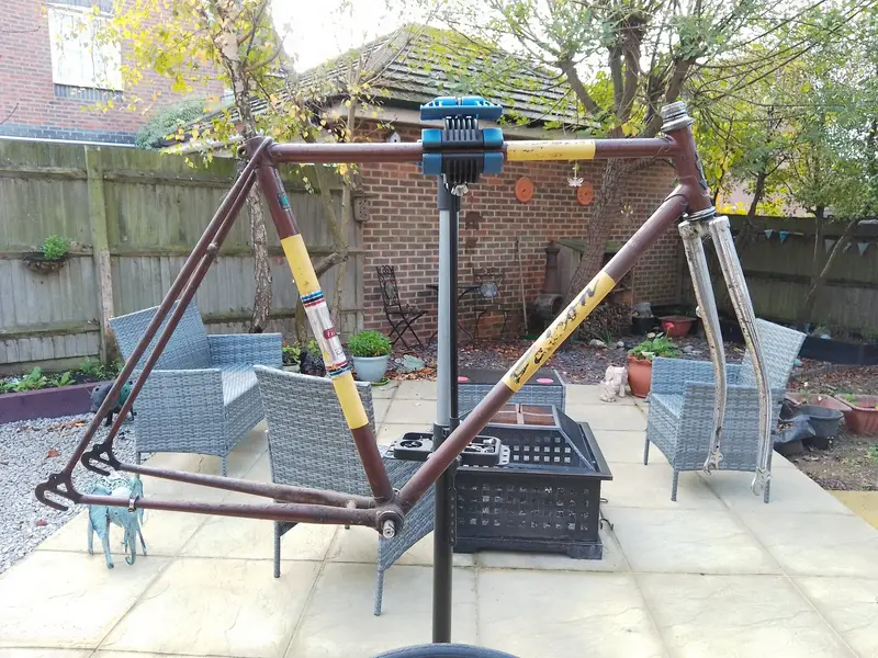

First stop was this Falcon 531 frame, but its a bit too good but also too scruffy even for this build.

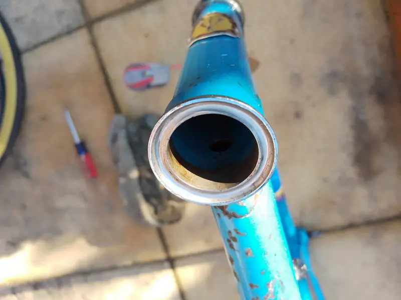

On the BSA all the bearings were as dry and tight as could be so that was the first job but the cheap bearing shells cleaned up well enough
So back together and bearings all cleaned and greased a bit of assembly started.

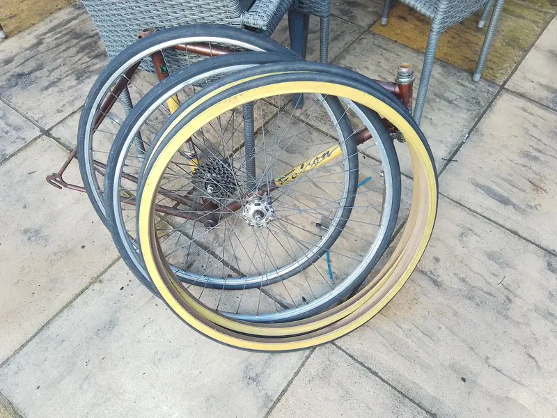

Last bit of the jigsaw is gumwall tyres.

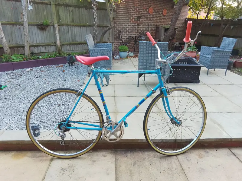

And finally the tracker is born.
Not one of my longest builds but hey ho its sued up a load of old bits and I reckon it will turn heads while i'm out on it.
