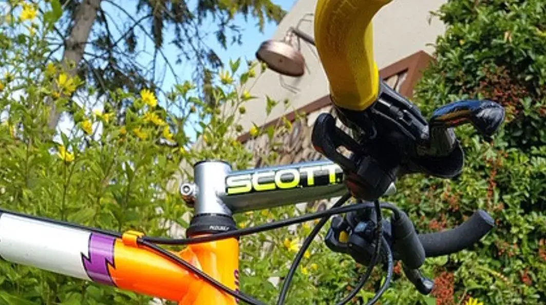

So I think I am going to call this done. I've had to stop myself over cleaning most of the parts as I wanted the parts to reflect the patina of the frame...
I bought some different Scott pedals in the end with the cast logo.
I was really chuffed to find some Scott USA bar end plugs
The spec is as follows:
Frame: 1992 Scott Super Evolution 17.5"
Forks: Scott Unishock LF
Rims: Mavic M231CR 32 Hole
Hubs: XT M730
Tyres: Ritchey Megabite ZMax Tanwall
Stem: Scott 130mm
Top cap: Scott USA
Bars: Scott AT2
Grips. Scott AT4 and Scott tribar grips
Shifters and groupset: Shimano XT M735
Brakes: Scott Pederson Self energising cantilevers
Pads: Scott Matthauser
Pedals: Scott SPD
Seatpost: Ritchey Microadjust
Saddle: Scott Branded
Rear Cassette: Sunrace 11-28 Alloy
Skewers: Shimano XT
Headset: Ritchey Aheadset 1 1/8
I need to get a few rides in to fettle it so it's ready for Mayhem 2020 just the annoying problem of the left shifter not springing back into position. If anybody knows anyone who is brave enough to take the pod apart and service it please let me know

I always thought the SE brakes were for rear only for some reason :?
Mark
You already know what I think about this build, so hopefully nobody will get the hump if I ask a THM style random question
What the hell do you get up to in the garden?
Do you really take al-fresco showers :shock: as there’s a out door shower head in one of your pics, must be bloody chilly most of the year
Mark
You are not alone in thinking that,the rears obviously "energise " in the other direction and look subtley different..which is a good job as you wouldn’t want them on the wrong way round :shock:

Nice build. I hope to find some of that neoprene bar cover for my (naked) AT-2 bars.
Keep checking eBay. That's where I found mine. You can still get yellow AT4 grips on ebay at the moment
