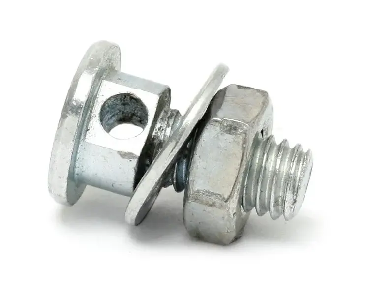

Richard, maybe a pinch bolt from a brake caliper might work? They often have one side quite "flat" to not catch on anything, and the other side has a domed nut. something like this maybe? (just a pic found quickly on the itnternet, there are better looking ones out there!) It might not look quite right, but I think you could get it to work and not look too "wrong"!

Go for same idea as shimano saddle bolt?

Fouling-You need to make sure that during operation there will be clearance between whatever 'bolt' secures your cable, and the back of the band that attaches the mech to the seat tube. For that reason, a pinch-bolt might have to go in from the other side, 'cause the flat 'head' is less likely to foul than the other end with the nut. Pinch bolt is probably too fat to go through the hole anyway- and if you want to use one you'd be better off filing away the shaft of the bolt, or drilling a cable-sized hole in a bolt that does fit in the hole, rather than drilling the hole in the mech arm bigger, 'cause you may one day say to yourself: "F🤬🤬k this pinch bolt- I'm going to re-tap the thread in the hole in the mech arm instead", but because you drilled it out to take the fat pinch bolt, there's hardly ant metal left to tap...

Failing that, as a stop-gap, get a bolt of smaller diameter that will pass through the hole without the threads engaging at all. Get a nut and washer that fit the bolt, and you'll probably get away with trapping the cable between the washer and the mech arm. You may need three hands.. :| That's just one reason why you are better off re-tapping the hole to accept a slightly larger diameter bolt. If you can drill a cable-sized hole in the bolt you might get by with two hands..
