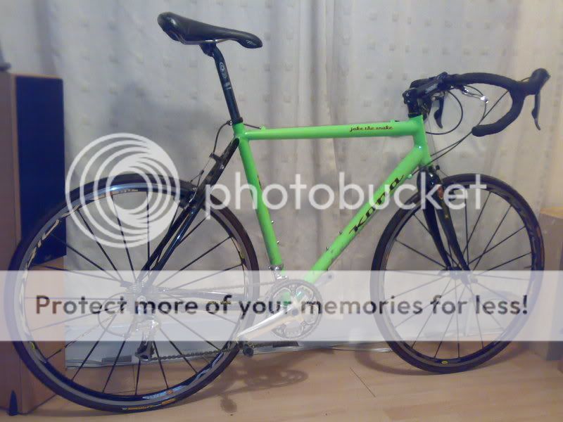

I'm one of the taller members but some of your bikes are huge. There are at least 3 members here whose bikes are too big for me to ride! And that comes from trying them at RB meets.
Large frames don't need to be gates. Its important to have other parts in proportion - stem, seatpost, and tyres. Skinny tyres can make a big bike look huge!
Lets see your big road bikes. I'm toying with buying a Colnago Master Pui (Art Deco) but the combination of 61cm frame and skinny tubes does makes it look gateish. Bigger than my modern Trek :shock:
