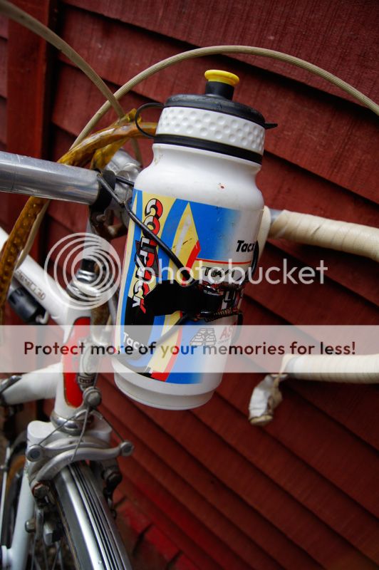

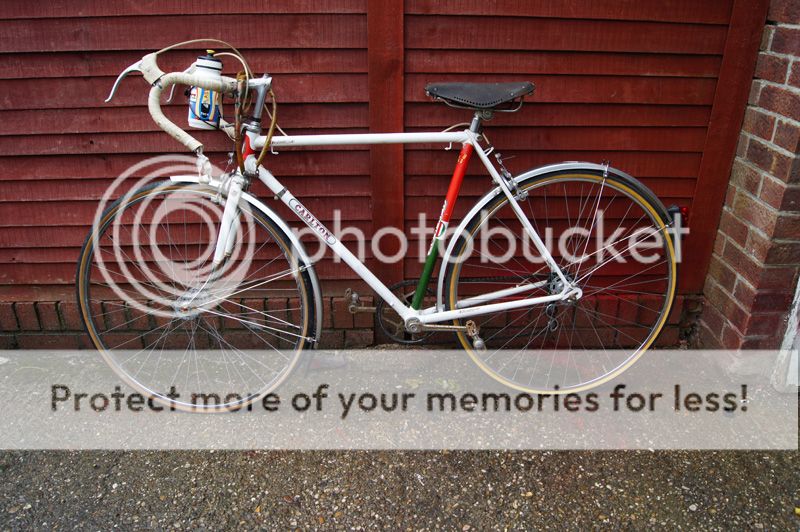

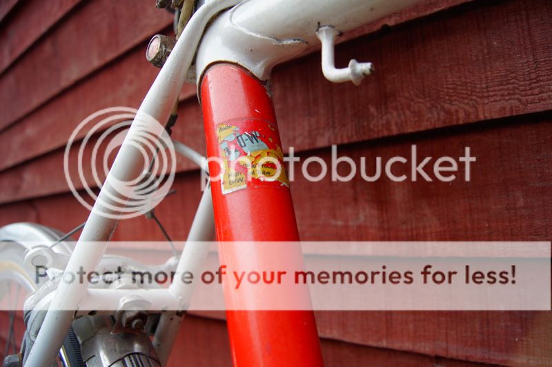

Time for some pics while i start the strip down.
Just needs some loving that one. I look forward to seeing it restored.
Nice one there, I would have guessed older than 1971 but I guess the original owner should know. Have fun and keep it as original as possible.
Nice,
Paint doesn't look too bad.
You'll be surprised how well it will clean up with some tin foil and WD40 or water, Autosol, wire wool and maybe some wet and dry.
That will look amazing once a bit of elbow grease has been applied. Love the paint scheme. Very nice bike!

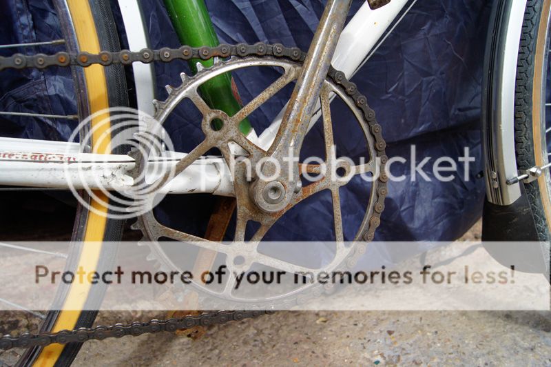

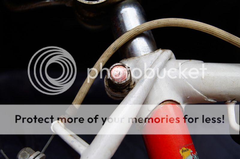

Thanks for the replies, I have just stripped the bike, well apart from the drive side crank, the cotter is well stuck. Apart from that it came apart no problem, the stem and seat post were nicely greased. The rims have very little rust and should clean up easily. On closer inspection the paint has been touched up quite roughly with a brush in places.

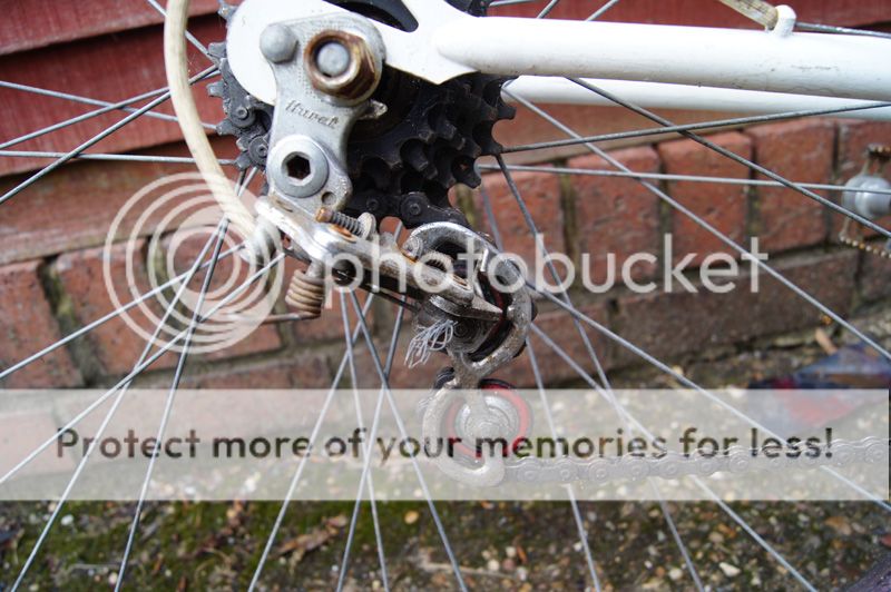

If i can get the bits that should be shiny gleaming again i will be happy, new cables and bar tape are a given. I think the rear mech has a part missing, there is a looped spring that provides the tension but i cant see where the loop should go.

The lateral movement spring just needs pushing back behind the grooved pin on the main mech body. As the gents have said here, plenty of elbow grease and hard work will pay dividends here, its not a high end machine but the paint job makes it very distinctive. A real bargain for £20.
Thanks for that, I knew the loop would not fit over the pin but didnt think of tucking it behind. I like cheap fixes. :D
