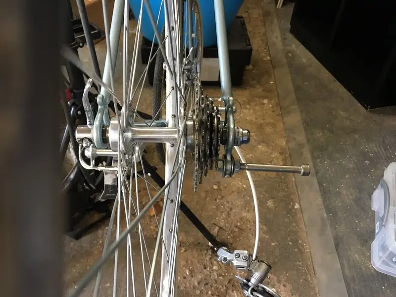

What did I miss? A bent derailleur hanger, that’s what. I off course spotted it as soon as I put the bike back together, thought I’d chance it for a while with the 6-speed close ratio freewheel cogs that had come with the bike & this was ok-ish, but as soon as I swapped that out with a catalogue correct Regina 28T 5 speed I was immediately in trouble.
So, what to do, I’d witnessed my Dad straighten out a hanger/dropout way back in the early 80’s so I thought I’d give it a go……Christ its unnerving! :shock:
So, I inserted a 100mm long 8mm bolt through the 10mm fine thread hole, with some repair washers either side, tightened the whole thing up, then slipped a length of stainless pipe over the bolt to gain some mechanical advantage…… she moved easier than I’d thought, no drama, no fuss, and the result? A rear derailleur as vertical as I’m ever going to get it, and no paint damage! :D

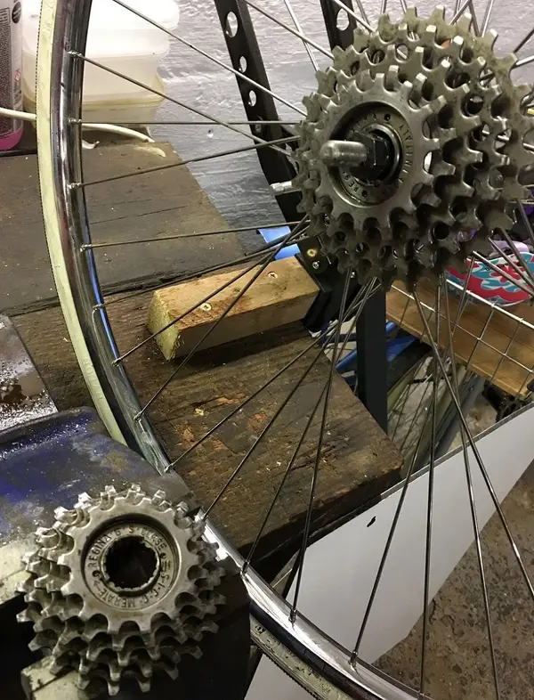

Recently I have been trying to push our Jim just a little further and faster on our training loop, but to go much further we have to work our way up and over a number of steep ‘wolds’, some I’m afraid are just a little too steep for Jim to complete on this heavy little Electron, so, what to do. I don’t want to turn this Superfive into a 10 speed, so I thought I’d have a go at the freewheel instead.
She was wearing a catalogue correct Regina Corsa 14, 16, 18, 20, 24. But now she’s dressed in a slightly older Regina Extra 14, 16, 20, 24, 28. I don’t think I will tell him, just let him find out for himself when he next reaches his dismount spot… ;)
