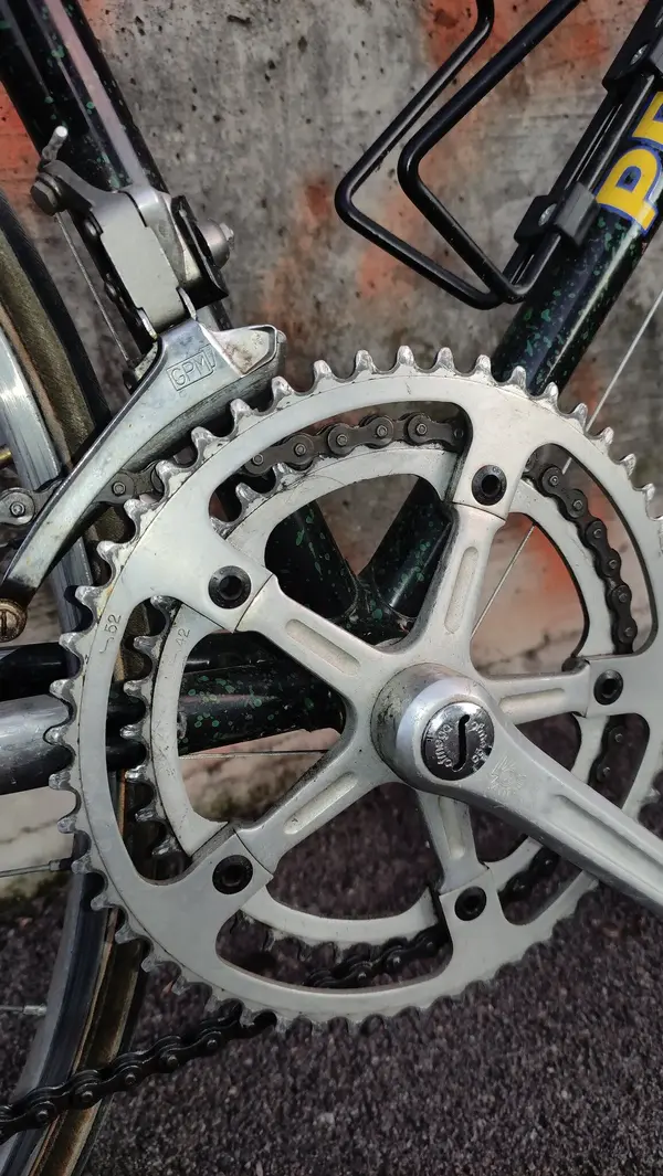

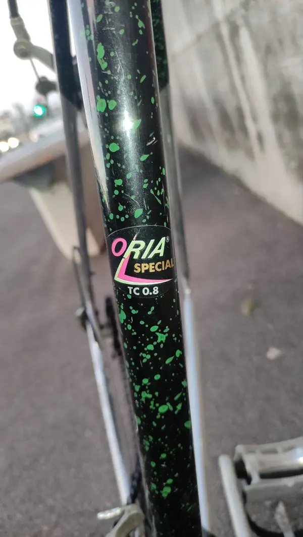

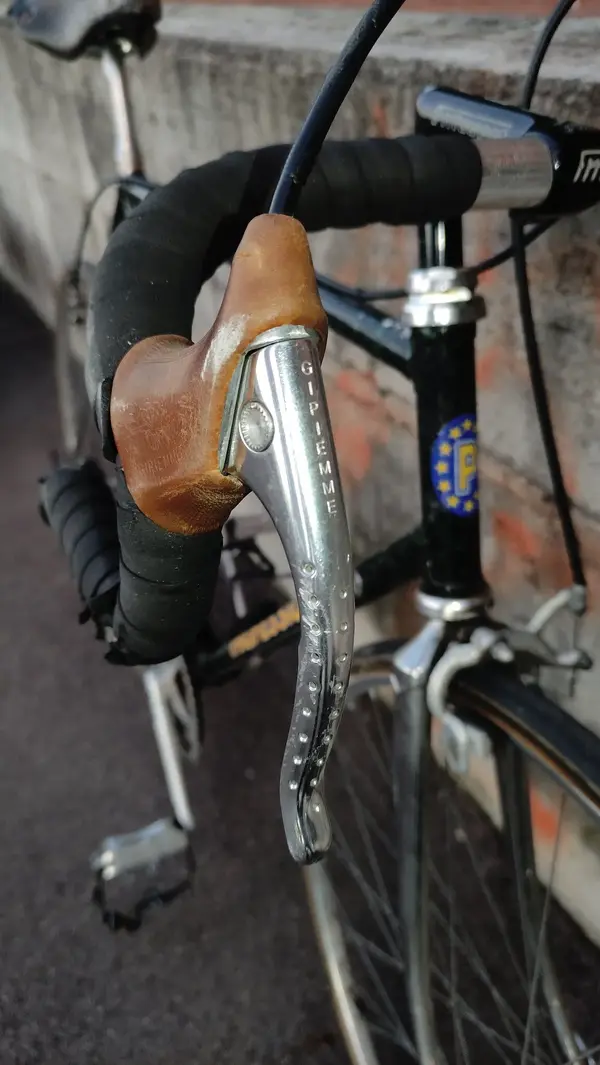

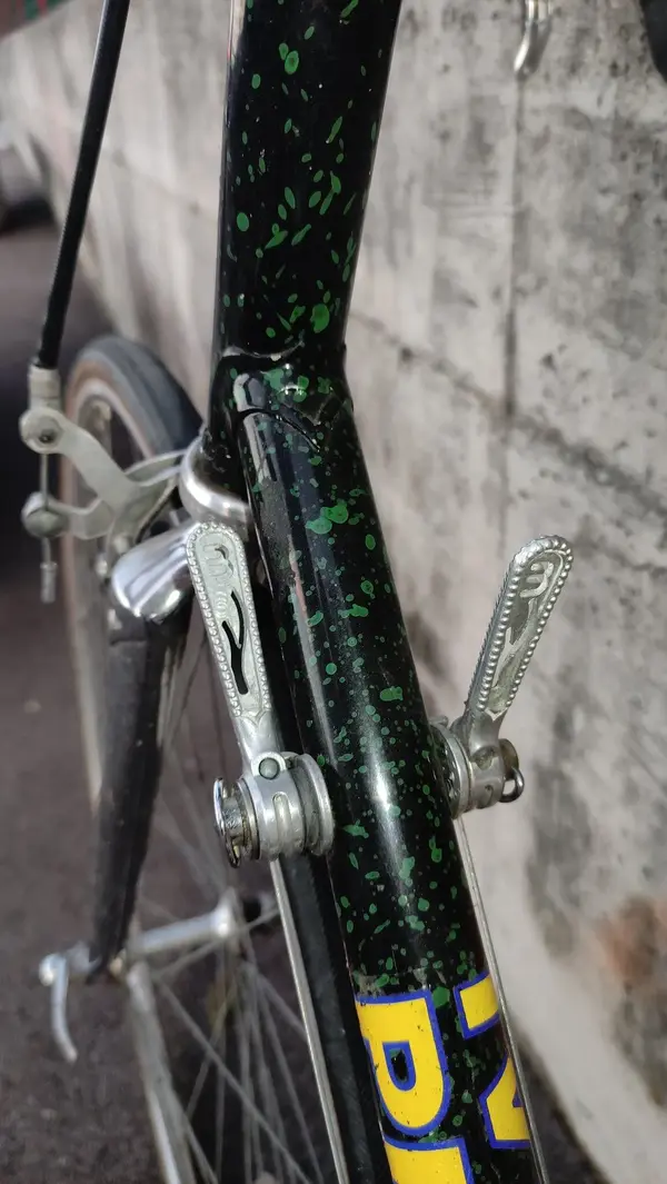

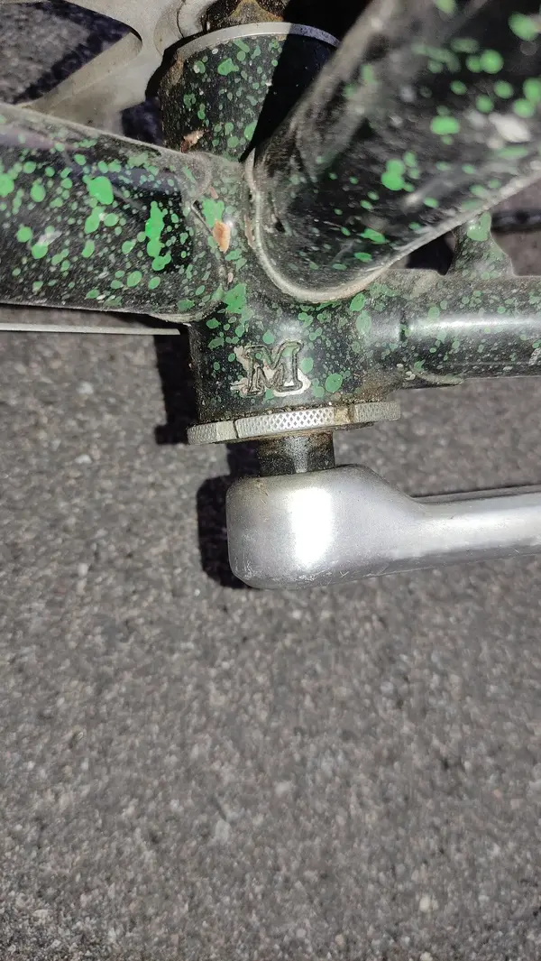

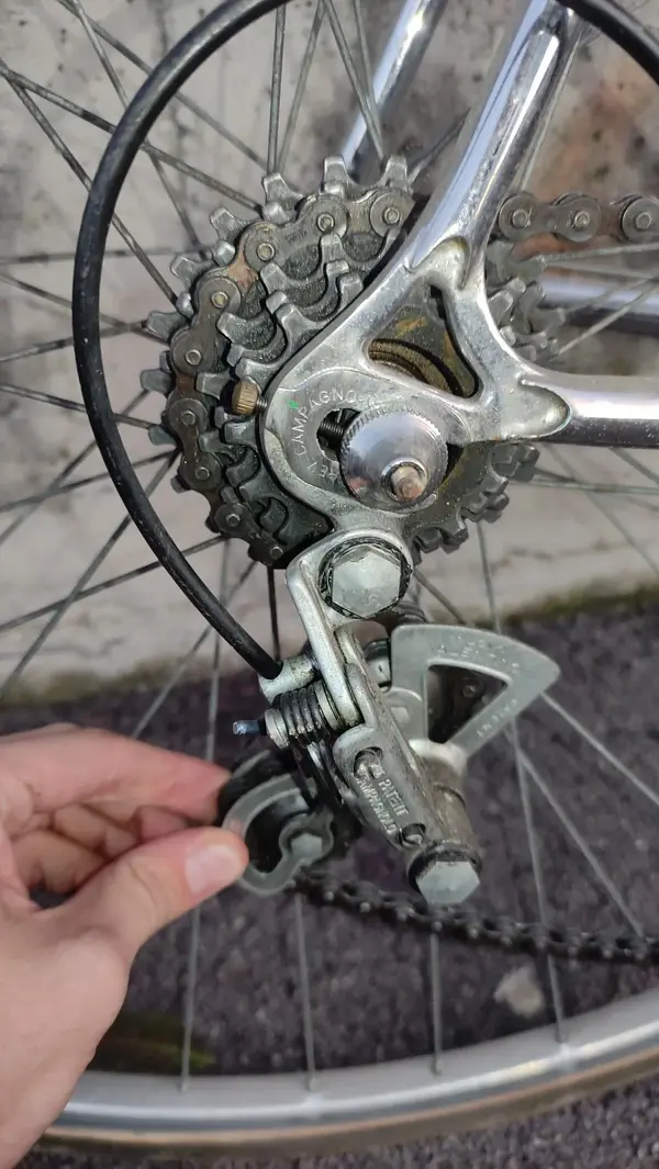

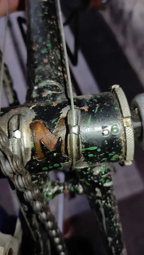

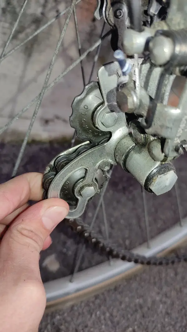

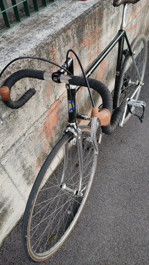

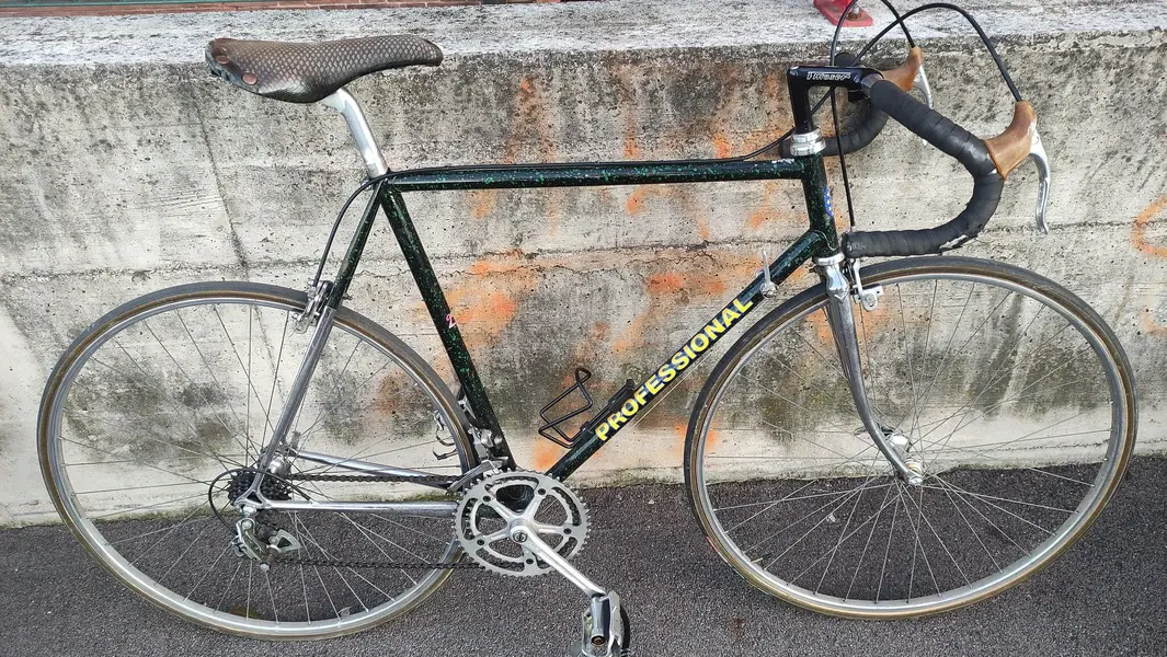

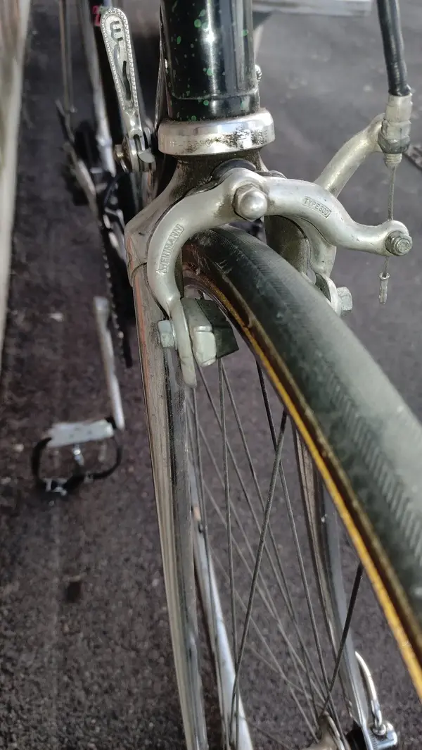

Hello! Can you please help me recognize model of this F Moser bicycle that has many branded parts, especially Campagnolo. Is it rare? I will clean it as soon as possible 😖

I doubt that is a Moser. Yes, there's the stem engraving but you could buy such stems from many places back in the 1980s.
The 'M' engraving and cut outs elsewhere aren't the Moser pattern which was more stylized, didn't have serifs and sloped more to the right.
What is this bike then? 😱 Is this ORIA Special TC 0.8 high quality frame?
Odd place to put an Oria decal, usually near the seat cluster and on the forks. The M rings a bell but not Moser,? Masi, I'd rather have a Masi lol
Scalloped stays at the dropouts might help identify. Is the panto in the shifters Gazelle (not the frame)
Can you please explain what I should look for? English is not my mother tongue 😁
ORIA was pretty good tubing though was almost unknown outside of Italy. Special TC is not one of their tube sets which I recognise.
The frame certainly looks to have some quality to it but looks to me as if it's been refinished. I'd not pin much faith in the ORIA label either as they are available in various aftermarket decal sets.
