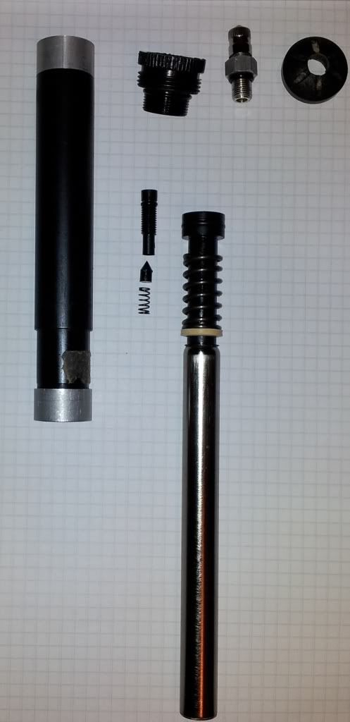

Just to finish this thread off, attached is a photo of a disassembled cart. I didn't have to remove the insert out of the rod, it was just burred over badly, so I just filed it to the same diameter as the rod so it would fit through the seals.
It's nice and simple inside with just a needle valve for damping.
I shall knock some drawings up for others future reference, and soon start a new diy damper thread.

I appreciate that I'm resurrecting an old thread here, but did you happen to take note of the dimensions of the o-ring/seals of the unit when dismantled? Thanks.
