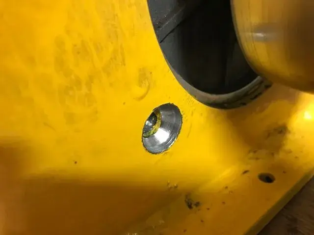

Thanks for all the replies fellas. I could have saved some of you some time if I'd shown you a bit more - the wheel is a direct drive on a 2" wide grinding belt.. The motor itself is a flange mount 2hp job, and the wheel isn't far enough onto the shaft. Any secondary motor plates would add to the problem.

One final thought: is it possible to rotate the motor mounting angle to change the orientation of the bolts so that one (or better still two) is inside the loop of the belt and therefore not likely to touch the side of the belt?
I'll need to check the other bolts don't then become a problem, but this may be the simplest solution...

This is what I was dealing with, the main aim was to get the wheel 10mm further onto the motor shaft.
Take an M12 countersunk bolt and grind off the very edge.
Abuse a £3 19mm countersink bit, going slow and cool.
Bingo.
I'd class it as 'hack' not 'bodge' and I currently celebrating my smugness with Rum.
