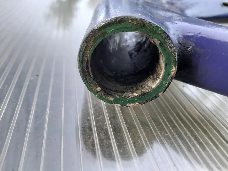

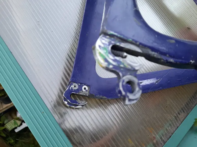

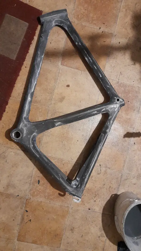

Paint removal in progress. Established it's a Donnay. The fork serial no. suggests it was made after the Merckx Donnay. Still looking for a photo of it when it was young to see what decals it had.

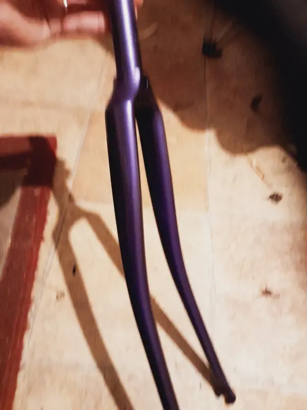

I have the fork repainted and got hold of a nice 600 groupset.

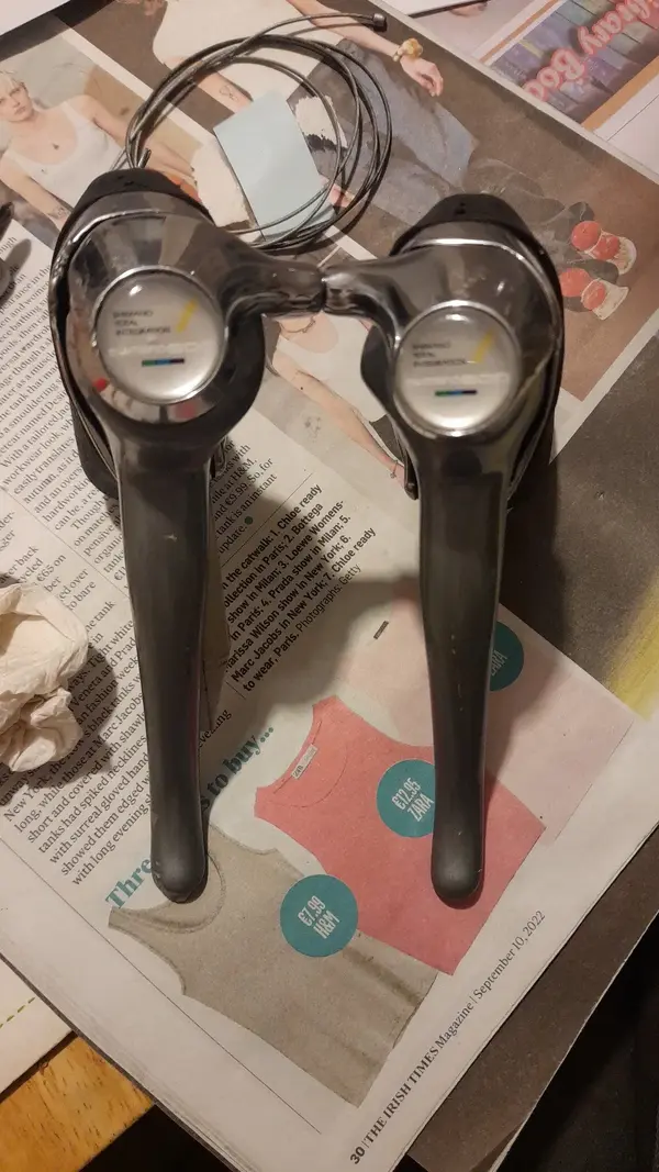

I dismantled the levers to get them working again. It was tricky but I did a pair of RSX shifters after and found it easier second time around. Innards are very similar. Then I fitted new repro resin decals from ebay.

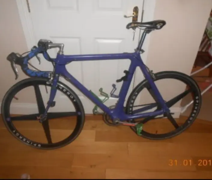

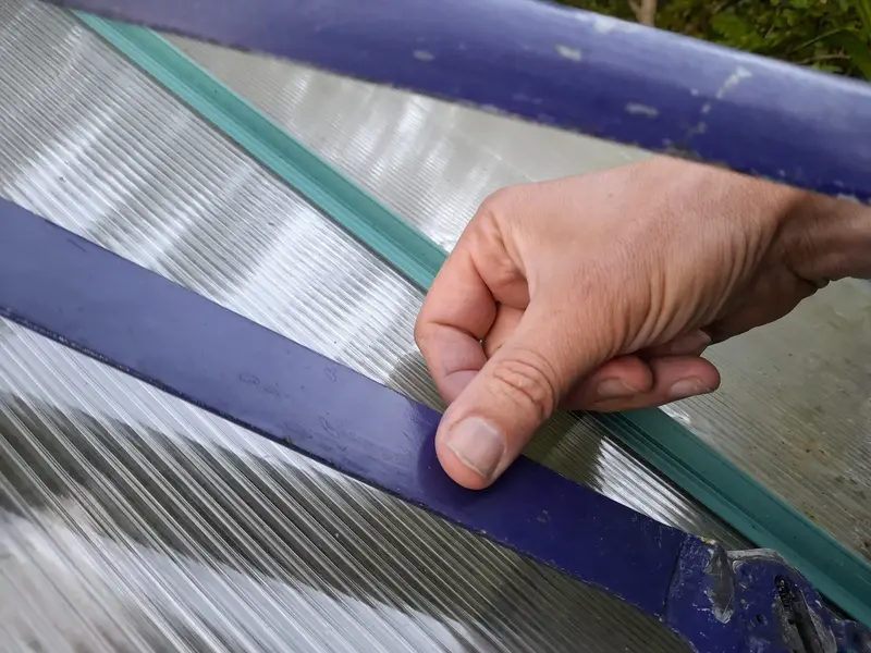

Frame was away for carbon repair. Back soon. It will go all purple then I'll have to make up some decals. I'll post more photos when I have them.

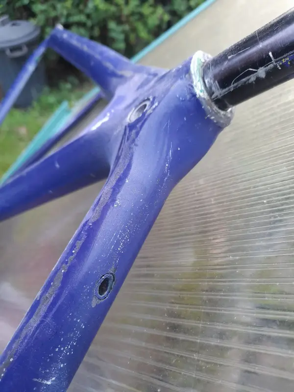

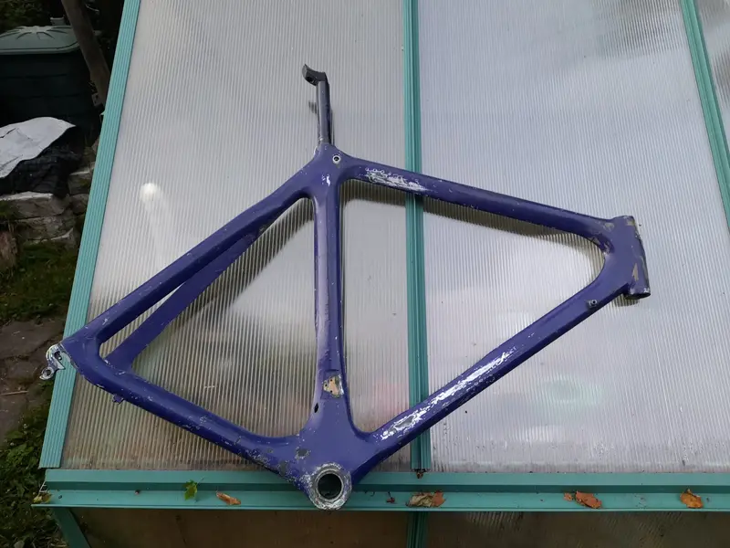

To the best of my knowledge it was all purple when new. There was little trace of tbe purple after several others had painted and repained it over the years. The fork strangly retained all the layers of paint added while the frame seems to have been sanded.
There was a small crack where the two halves of the frame were joined. The crack was at tge top of the seat tube from flexing of the seat post. Back in 1993 the frame had an aluminium liner in the seat tube. This was because back then they were careful with carbon. The end result is that the crack was never going to progress beyond 7mm or so. I wanted it checked to be sure.
For decals I thinking of red and white DONNAY and maybe a "Carbon Technology" on the top tube. I'm still hoping someone will dig out a photo of it when it was new. See the links I included in the first post of this thread.
