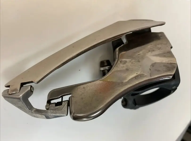

Here’s a photo from the eBay ad of what’s on its way. The outer and inner plates look like chrome plated steel, is the inner one actually nickel plated alloy?
