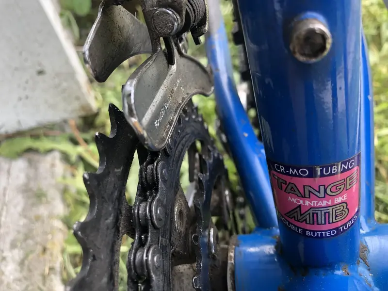

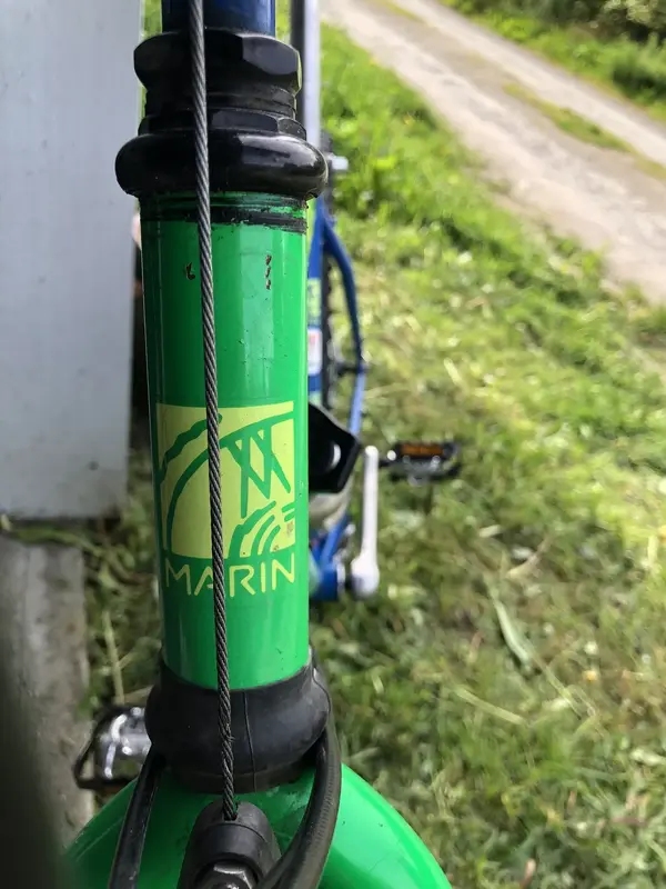

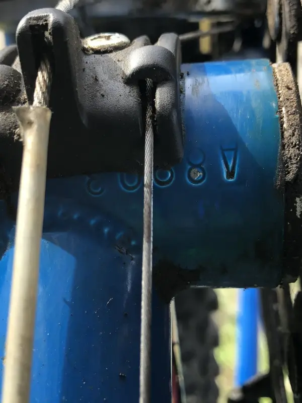

Thanks for putting this together. I just picked up a Marin at a used bike store, I think it is an 88 Palisades, based on the info you posted (thanks again) but there is only 5 digits with mine - the letter A, followed by 4 numbers. What do you think? Would love your opinion. I picked it up to be my gravel/sand camping bike - my touring bike can’t get wide enough tires on it for off-road camping.

Thats a nice rare beast.
Throughout the whole marin code system, the first 5 characters are the most significant, in any case.
The rest appear to reflect info around colour scheme, production details or Wednesday's lotto numbers.
Enjoy your bike!
