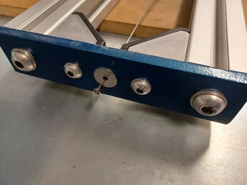

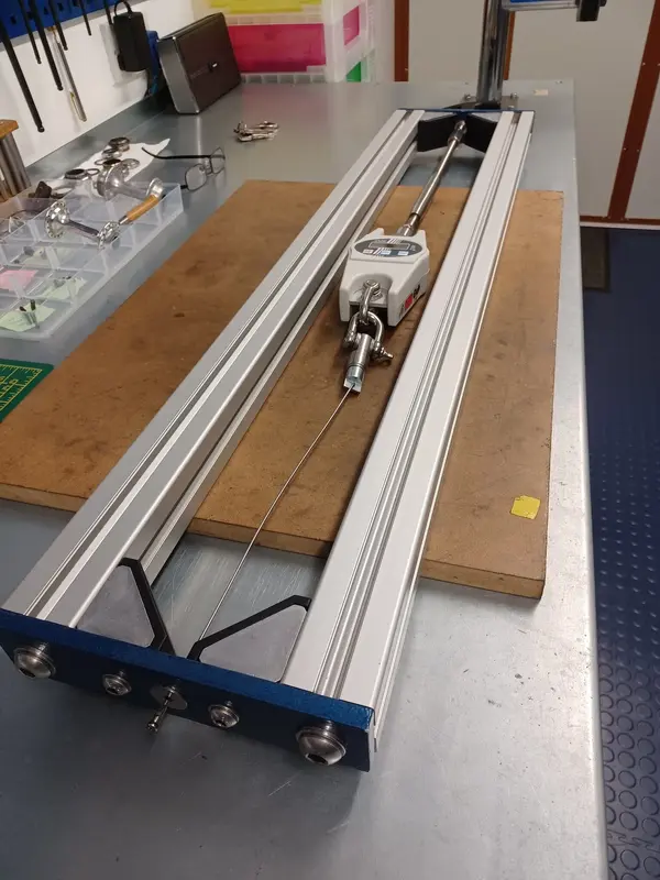

I knocked up this tension gauge a while back using a crane scale.
Just need to thread in one of the old spokes.
And try to replicate the angle of the spoke when it will be sitting in the wheel jig.
Then crank up the tension in approx. 10kg increments taking readings as you go.

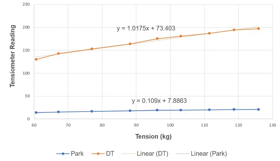

Once done, you can then plug the numbers into Excel and approximate the readings to a linear graph.
The linear approximation can then be used to calculate a bespoke tension chart.

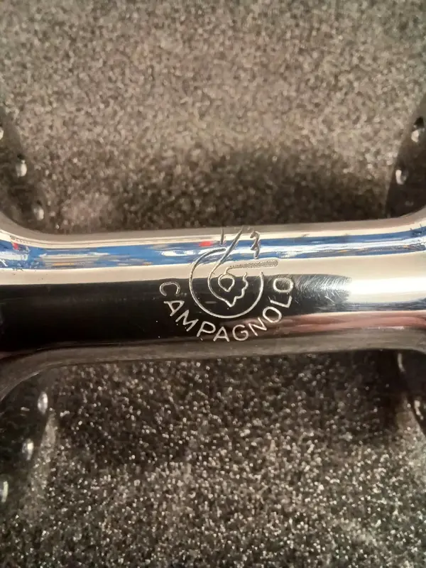

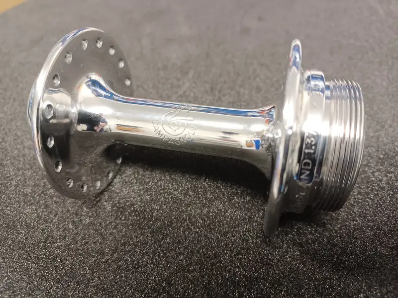

One wheel down and the next one started.
This went through 400, 600, 800, 1000, 1200, 1500, 2000 and 2500 grit sandpaper and a lot of elbow grease. Followed by the buffing wheel and finished off with Autosol. Unfortunately there were a couple of gouges which I couldn't get out, but happy enough with the final result.
