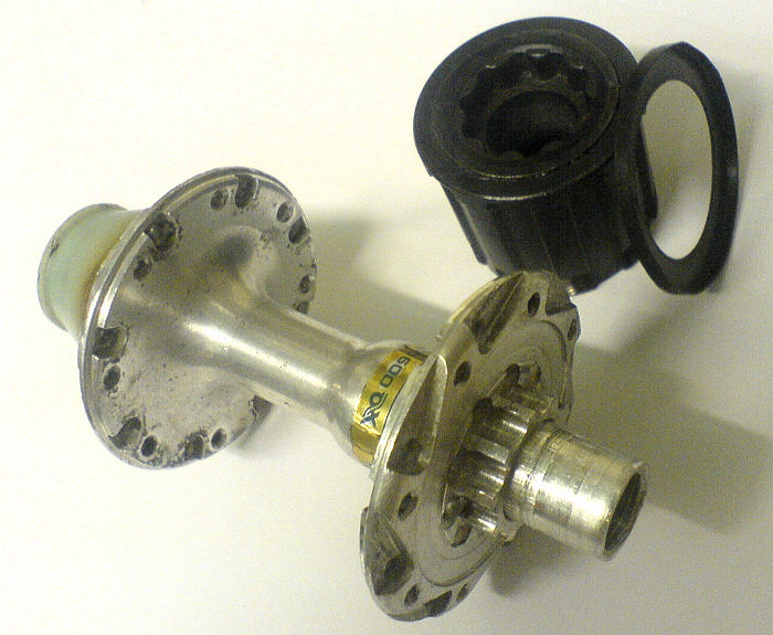

after all that it appears after taking the axel apart and cleaning all the gunk out i have found that the hubs must be an earlier model than i previously thought looking at sheldon browns site this is the construction of the freehub.
So next question is how the hell do you get this off?!?!
