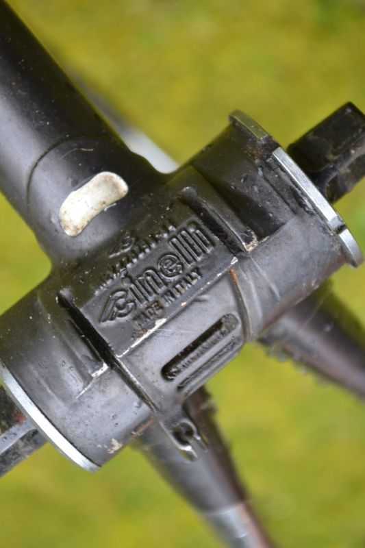

SLX tubing, Cinelli spoiler bottom bracket with slots cut in it, external cable routing and no model name decal.
I'm thinking genuine team issue... not sure what year though.
