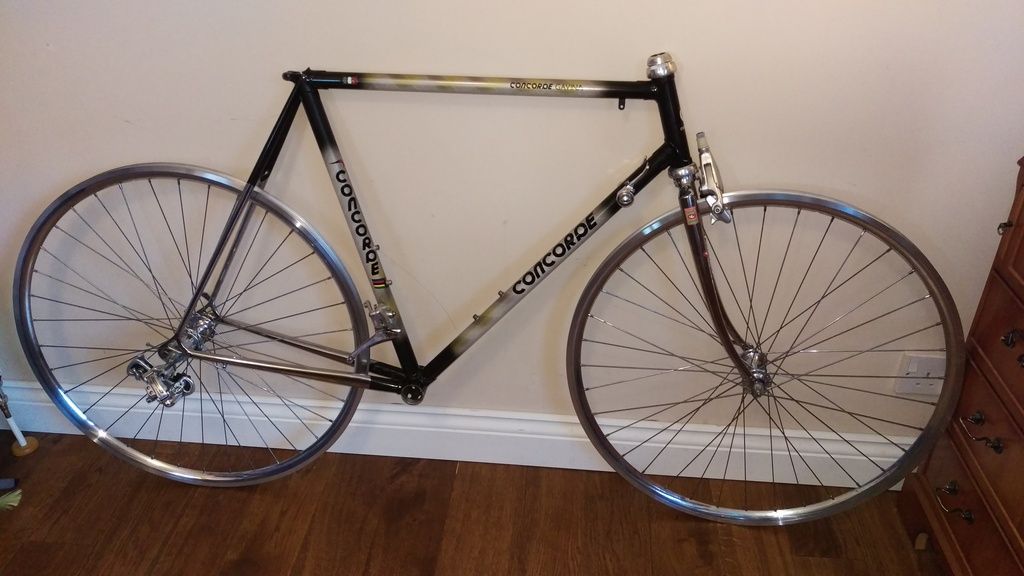

Woke up a bit early this morning, so just got started. Will do the hard bits when I get back.

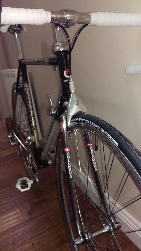

I can confirm that setting up Delta brakes is a faff.

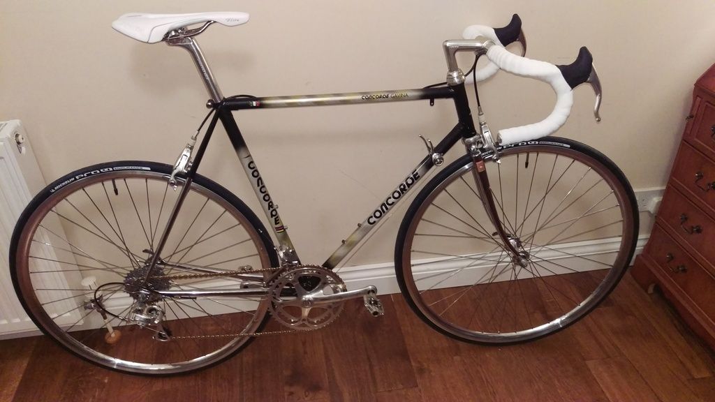

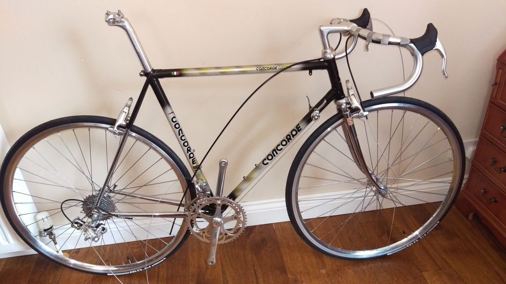

And we're done!
The 10 speed indexed shifting from the down tube levers works well and feels great on the stand. Might be a few days until it's gets a test drive.
Wow, that looks great.
Also, I like your choice of tyres, I have them on a lot of my bikes.

And so... the spec sheet:
Frame: Columbus SL tubing with Columbus dropouts c. 1989
Fork: Columbus chrome
Headset: Campagnolo Chorus
Stem: Nitto Dynamic
Handlebar: Nito B105
Bar Tape: Charge U Bend (£1.99 a pack!)
Brake Levers: Campagnolo Chorus
Brake Calipers:Campagnolo Delta 2nd Generation
Brake Pads:Campagnolo in pre-2000 shoes
Brake Cables: Campagnolo ultra shift
Shifters: Campagnolo Record downtube converted to 10 speed
Front Derailleur: Campagnolo Chorus 1st generation
Rear Derailleur: Campagnolo Chorus 10 Speed (early model)
Derailleur Cables: Campagnolo
Cassette: Campagnolo 12-29
Chain: KMC X10L Ti-N
Cranks: Campagnolo Chorus 1st Generation
Chainrings: Campagnolo 52/42
Bottom Bracket: Campagnolo Centaur square taper 111mm
Pedals: Crank Bros. Candy 2
Wheels Handbuilt by Jackosbournesnr
Rims: H Plus Son Archetype (debadged) 36/36
Hubs: Campagnolo Athena
Hub Skewers:Campagnolo Athena
Nipples: DT Swiss 12 & 14mm
Spokes: ACI Alpina DB 2/1.7/2
Tyres: Michelin Pro 4 Endurance 23mm
Tubes: Michelin Ultra Light (came free with the tyres)
Saddle: Selle Italia Flite Flow
Seatpost: Nitto S83
Seatpost Binder: Campagnolo
Weight: 10.00 kg

Cheers Neil.
Pro 4 's are great all round road tyres and because of the deals available on them they're also brilliant value for money.

Cracking Job Ken nice job on the polishing it's brought the paint out lovely :cool:

Cheers Clive.
There's still more polishing to do. Its nearly there though!
I also forgot about the seatstay decals and the Columbus SL sticker. The Go-faster stripes suggested by NeilM arrived in the post today, so I now have everything I need.
I'm thinking I'll ride this down on the April run as it looks like it should take a 25mm tyre and I can probably bung a triple on it with about 10 minutes work. I don't think my knees would be too happy riding loaded up Lake District climbs on a 42 chainring.
Theoretically, all it needs is a 1mm spacer under the drive side BB cup and assuming the front mech can cope capacity-wise, a quick tweak of the limit screws. I'll give it a full test ride with both setups at the weekend.
