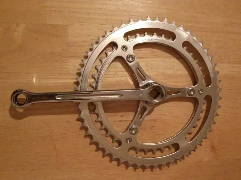

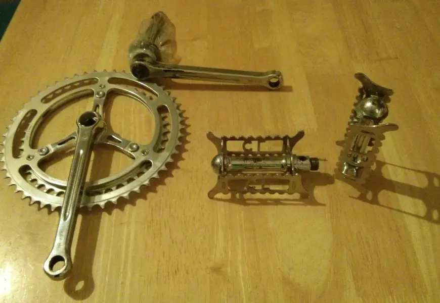

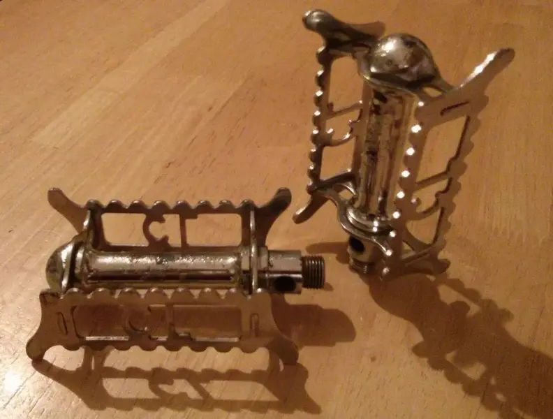

Update: Cleaned pedals and chain set
Hard to describe how much cleaning has gone into this! Ive stripped both the chain set and pedals, god they took some effort to remove! The Chainset has come up a treat, particularly the drive side, it looks almost brand new. The left hand crank has cleaned up well considering the damage to the chrome. The Chater Lea pedals now run smooth and true, and Ive removed the rust, considering they are late 40's early 50's they are a credit to the quality of manufacture. I've also stripped, polished and regreased the Mavic G40's on campag record hubs.
