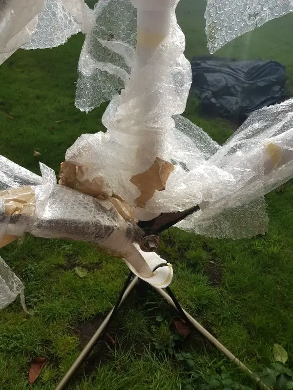

Been a bit busy the last couple of days doing more bike mechanic certification, so jumped back on this late this afternoon.
Finished off the seat tube, but still chopped a bit off the Deda seatpost I'd bought to fit. Sadly I don't have the leg length of Mike Muz 67, so part of the graphic is concealed beneath the lug.
Was hoping the bottom bracket wouldn't need tapped, but after filling it with seat tube swarf, I thought I'd better... by god it needed it! Last time I chased bb threads this bad it was after some seized cups had been melted out of the shell.
Anyway... having splashed out on a new Chorus bb I was delighted when it threaded in smoothly.
As you can see, I still haven't taken the bubble wrap off yet. I gave the fork a wiggle and the headset deffo needs serviced...hopefully a quick clean and some fresh grease and new balls will have it as smooth as the proverbial infants derriere.
Thought I'd keep the grassy theme in the photos, so moved the stand out of the workshop :p
