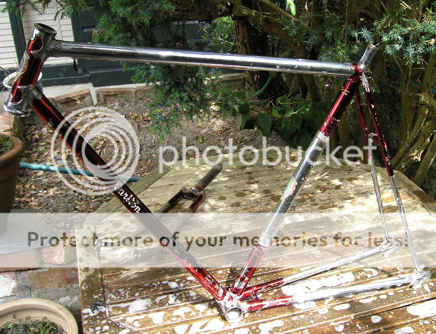

Stripped the frame down today, just one tricky cotter pin to deal with. Everything else OK. Under to insulating tape on the machine is virtually new chrome, some of the paint came away with this stuff, but not too much. I'll use some sort of white decal band to make sure the transitions from paint to chrome are neat. The frame must have looked stunning when new.

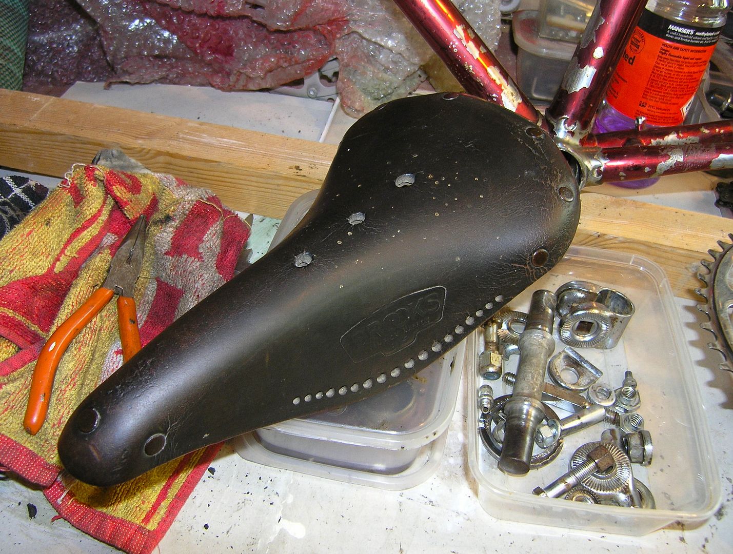

Stripped the rest of the components of the frame today, just the forks to remove. Started to do an initial clean of components and the frame itself. Taken the perished tyres off - they had rubber flaking off them they were so gone. Will need new rim tape though. Both wheels are true, the front one having the faintest 'wobble' in it. I have also started the B15 saddle on a course of Proofide each day to get the leather in a presentable and usable condition before tensioning up again. Here are a few pictures form today...

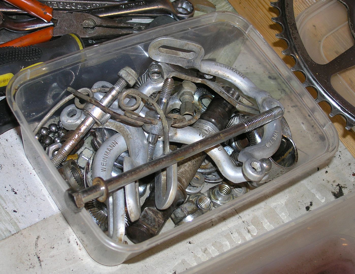

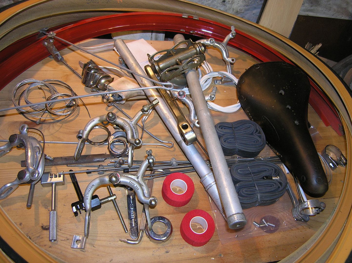

Some of my components to choose from if necessary...

Bits and bobs, with the BB bearings soaking in meths...

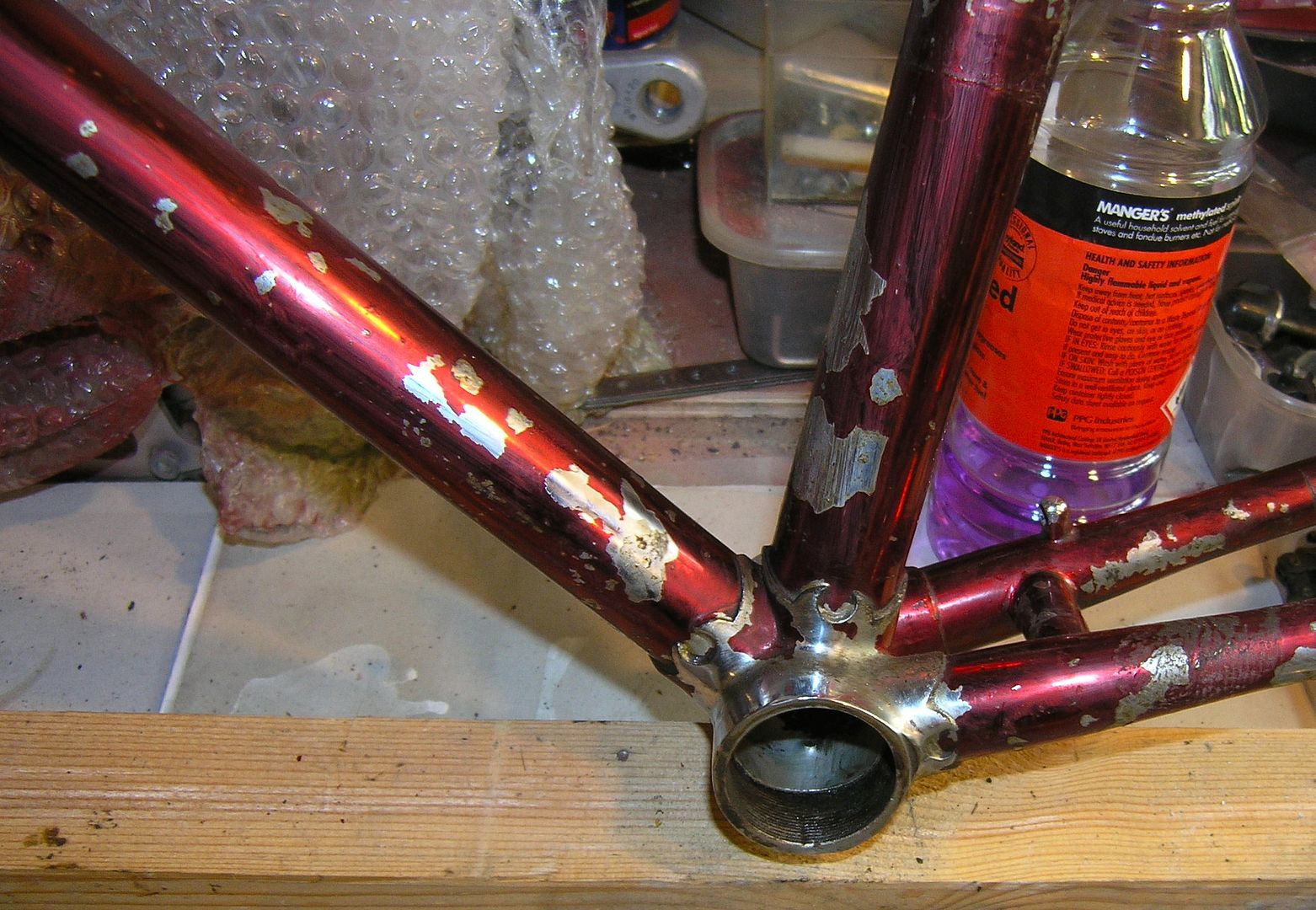

The BB area has a lot of paint loss...
Im keeping the paint as is, its a shame the Acryllichrome finish was not more durable...
The saddle leather is starting to respond to some intense Proofide treatment...

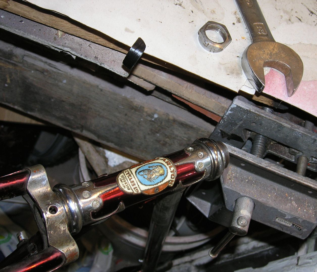

Took the forks off today. Steering took one hell of an effort to loosen, in the end I resorted to strong arm tactics with the aid of vice and 30mm spanner. Clearly not been removed since the bike was built. Cleaned the frame down now so i can assess what I can do for it. Will no doubt be using a lot of aluminium foil on the chrome....
Some pics for them thats interested.

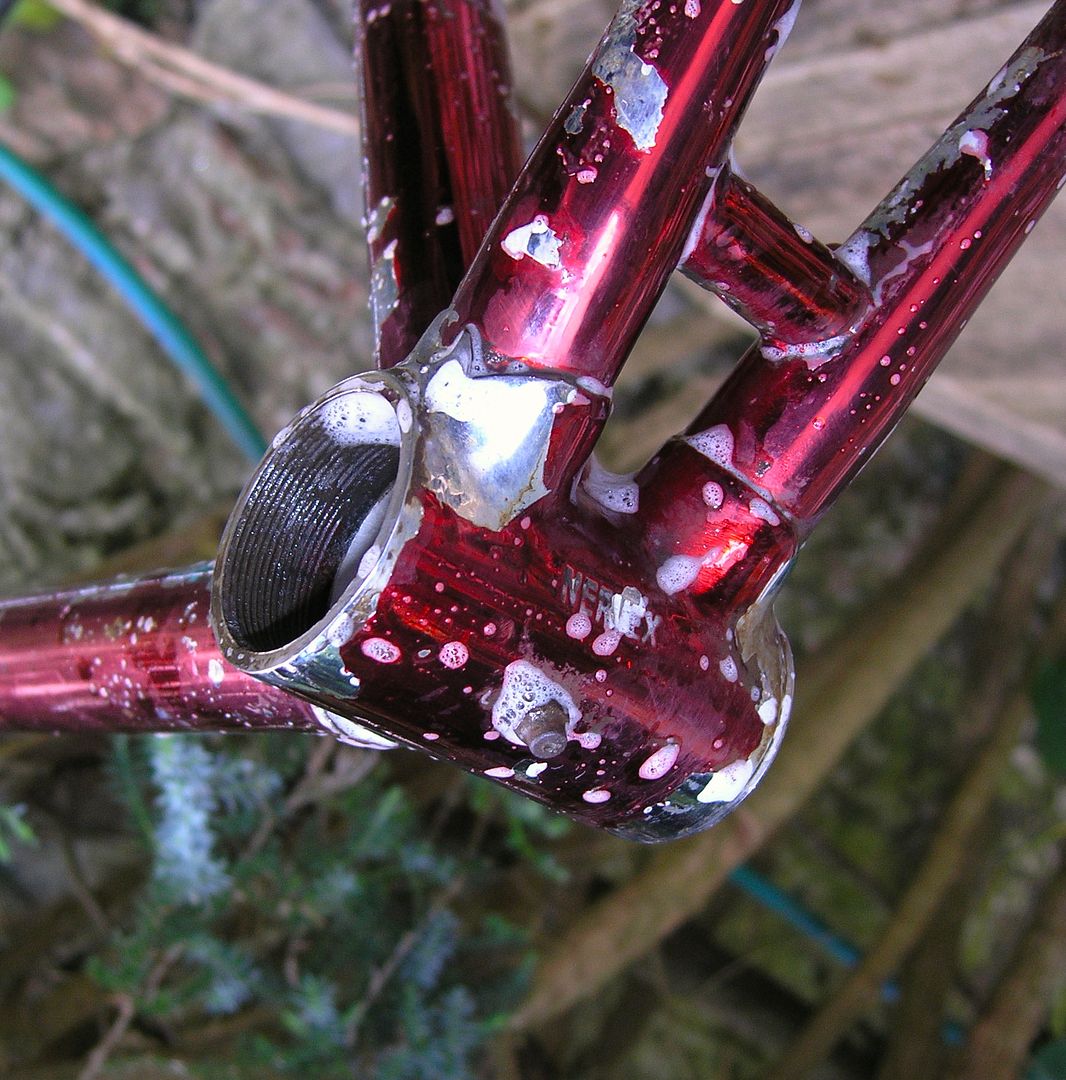

The bottom bracket shell is stamped Nervex, no doubt alluding to the lug pattern used. The shell also has a grease nipple.

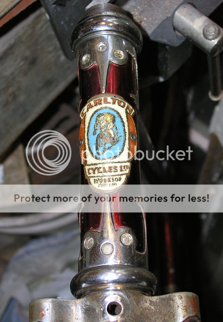

Capella lugs on the headstock, very small frames used a cut down version of these.
This bugger shifted in the end. Wedging the forks in a vice and heaving on the lock nut did the trick...
