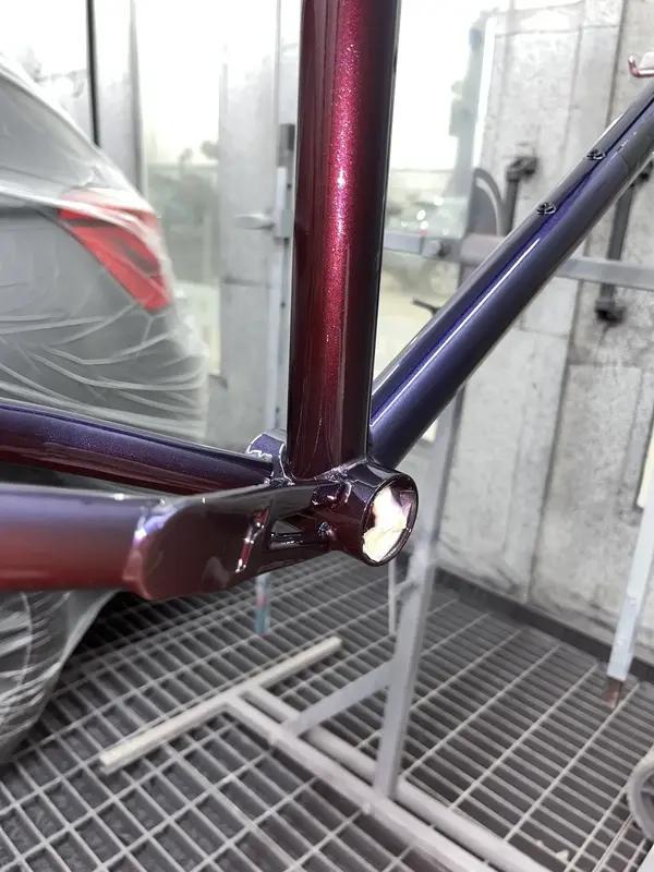

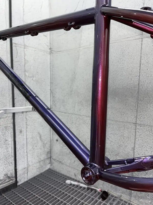

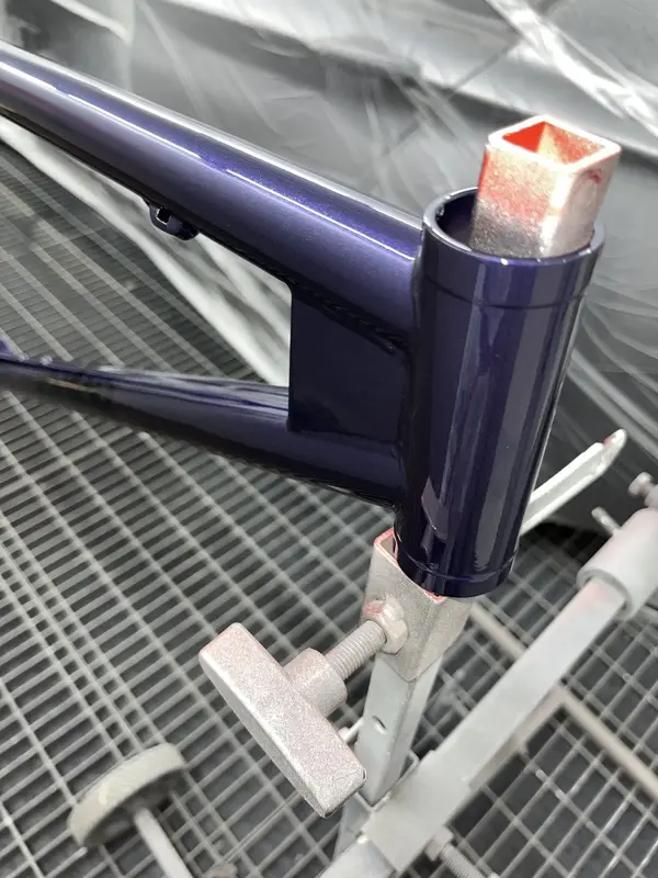

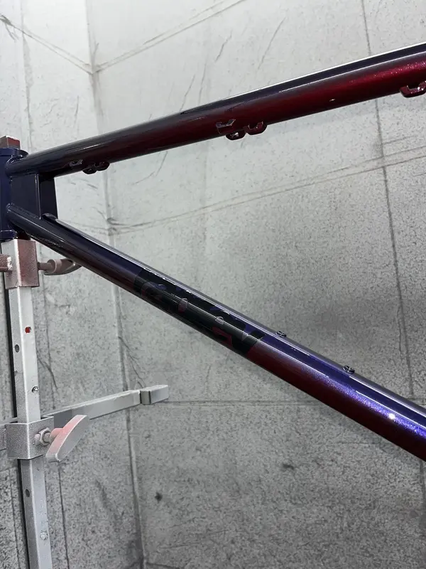

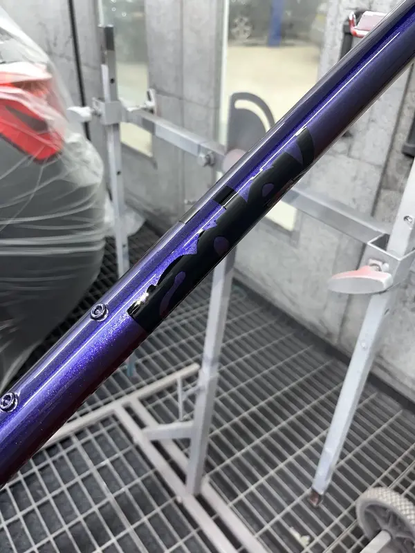

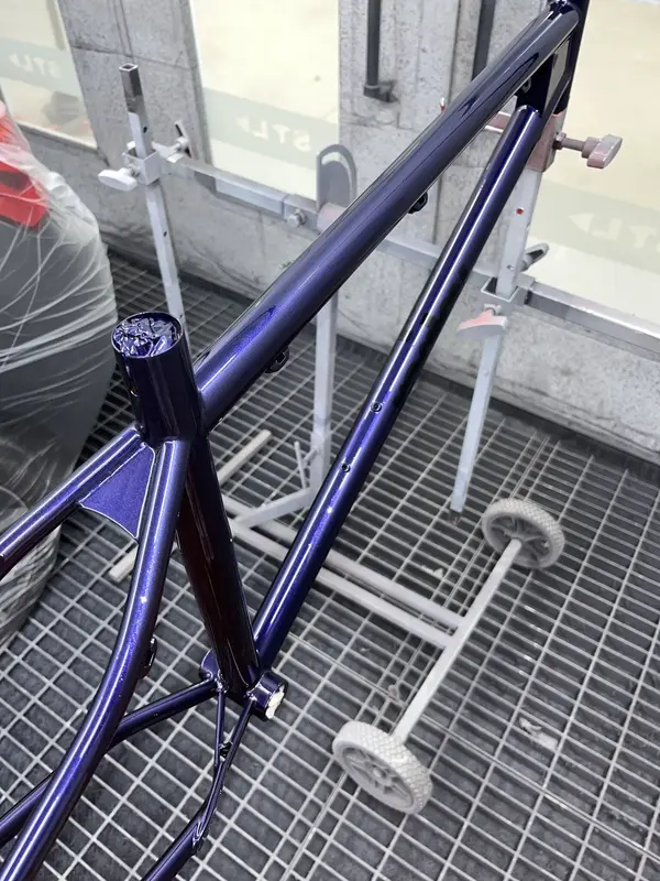

The frame has been scotched down again and new down tube decals put on ready for another 2 coats of clear coat tomorrow.

Did you sand back completely to bare metal or were there places you left the original paint on? Just wondering how you managed to sand around the cable guide fittings and around the tube joints/welds as I've always found that fiddly and time consuming.
I just sanded the main parts back and feathered the paint out around the cable guides and hard to reach areas so that there wasn’t a noticeable edge. Then used red scotch on the parts with paint left on.
Hope this helps
Kyle
Thanks for the reply. Looking at some videos on YouTube they're always saying to remove all the old paint as it could affect the new paint (colour bleeding through), so not always the case?
I wouldn’t worry about that to be honest. As long as you feather the paint edges so there is no step it shouldn’t be a problem. I just used a ‘wet on wet’ primer that doesn’t need sanding and didn’t have any visible edges where there was old paint still on the frame.

Looks brilliant but not keen on the black stickers
maybe a lighter grey colour or silver
