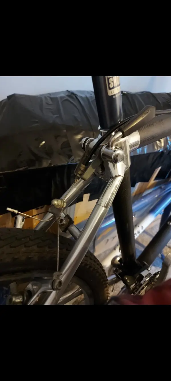

I have seen a Pro carbon and wonder if it is safe to ride after nearly 30 years old? Will the adhesive still hold the carbon fibre tubes to the aluminium lugs.
If any member has one of these frames then I would like to hear from them.

Any pictures of your British eagle ?
I confused between Brittish Ragle and Raleigh… Sorry
