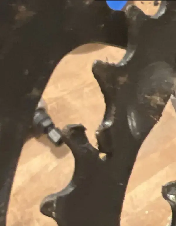

The middle ring (which is likely the one you would want to use in a 1 x 7 set-up) is shagged, chuck it in the bin
**EDIT** my mistake, I’ll get me coat…😬
Ok cool. So those teeth bent in are deliberate? In that case, I just need a shorter crank arm. She’s a 170, and gets knee pain. it’s 175.

Middle ring is fine, it is supposed to be like that, if you look closely there are other teeth that are twisted to aid shifting up and down
That tooth on the middle ring looks properly knackered to me too, you should be able to get a replacement easily enough
Nope the middle ring is fine

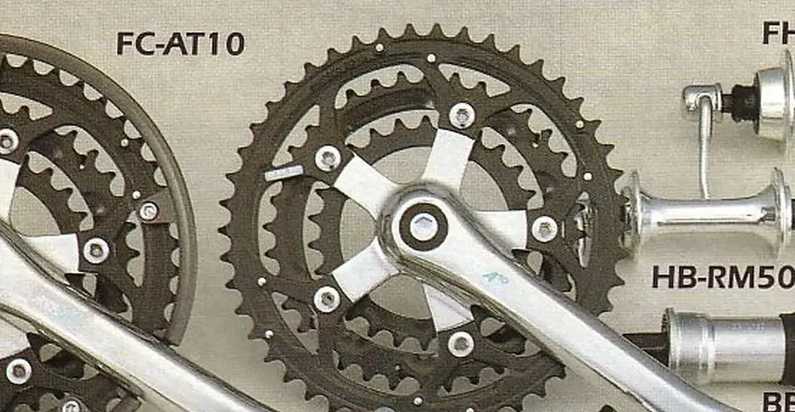

Those are the low end pressed steel rings
If you look the pressed bulge in the ring leads the chain up to that split tooth when shifting up
It's the same about 3 or 4 times around the ring
That's how they achieve fab shifting on the cheap pressed steel rings.
Peachys crop is a little misleading as it shown the previous split tooth and the next bulge.
It's what makes Shimano great
<sighs>
I wonder how many 'worn' chainrings get replaced unnecessarily because 'the internet says so'
Here how a new one looks
