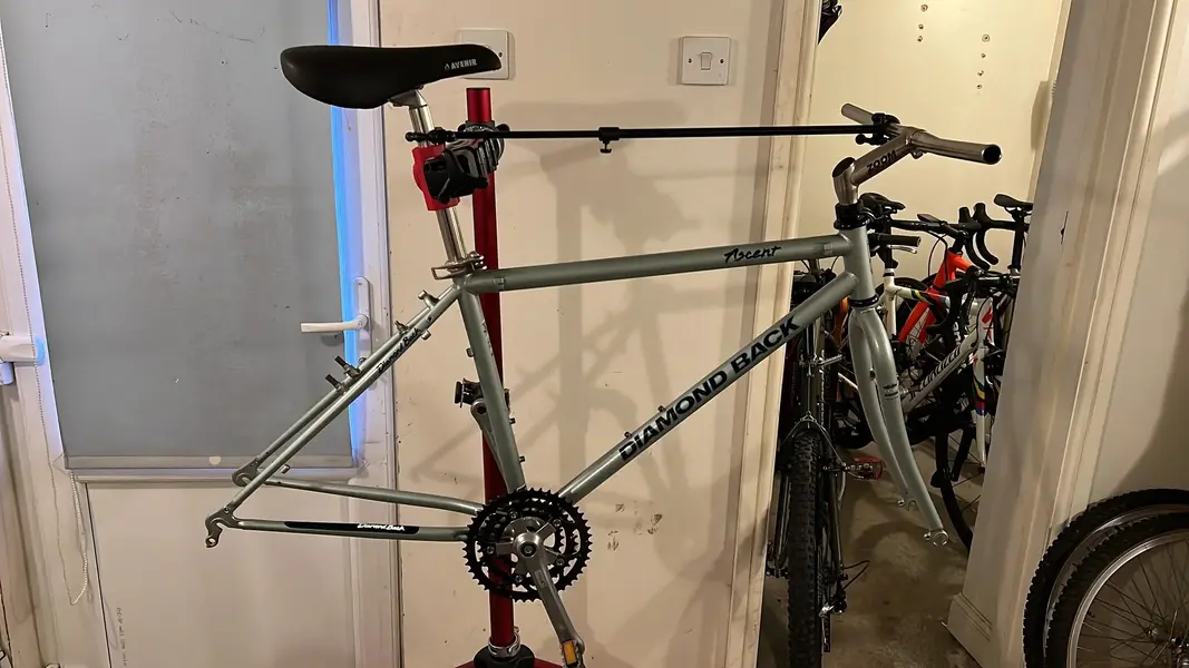

Bike build: Converting to a 10 speed
Nope the middle ring is fine
Those are the low end pressed steel rings
If you look the pressed bulge in the ring leads the chain up to that split tooth when shifting up
It's the same about 3 or 4 times around the ring
That's how they achieve fab shifting on the cheap pressed steel rings.

Go easy for this built: Altus onwards works fine. 7x3 is enought even for beginners. a 28-11 casette is perfect match for a 22-32-42 front 3 chainrings. Little money on this you will need.
Brakes ... some V´s works much better than cantilevers. A normal shimano M600 is good enough and they are cheap because all people goes for the XT 739 and it is the same but without the paralelogram. Second hand set and some fresh cool stop pads. Don´t go for chinese cheap stuff, they are horrible to adjust and perform poor. (I did, bad idea)

I like to tinker, and want to customise a bit. I’m trying to find a good middle ground between it looking the nuts, and not desirable to steal… pretty tough, but after cleaning up a bit there’s less that ‘needs’ doing. New shifters being the only main thing, but will sort a new cassette, chain just to get it all running well… the misses also saw some tan billy bonkers wheels she loves, but I’m pushing back on those!
Regards the shifters (sorry if you've already said) are they Shimano triggers that are not engaging properly? Generally I find Shimano ones pretty darn reliable, if they are not engaging or only higher 4 gears shifting then it's probably sticky pawls in the shifter which can be sorted with a blast of carb/brake cleaner or if you want to do it proper way, remove the covers and physically work the pawls with a small pick and aim the cleaner directly at them - be carefull not to pry them back too far as they are spring loaded and it can damage the spring.
Number of 8 speed Shimano freehubs (the black hubs with red '8' printed on them) and shifters i've seen gummed up come through the workshop - the grease of that era basically turns to wax over time.
