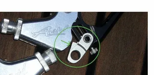

Absolutely superb levers, but the ‘V chip’ version only just pulls enough cable for V brakes. Fine if you don’t mind a squishy feel with loads of modulation, but disappointing if you want something more solid feeling

Don’t get me wrong, they should be ok. I like my brakes with a soft feel but lots of folk prefer them more on/off, which to me feels wooden.
With Paul Motolites for example the Avids still feel spongy set to the maximum cable-pull, but they’re acceptable (and Very powerful)

i do actually have a spare set with v chip, but not looking to sell at the moment. if that changes i'll let you know.

personally if you are mixing v and canti, i'd go with v specific levers to get full stopping on the v brake and try dialing back the cable pull on the lever for the canti since they are adjustable.
from what i recall, the v chip did very little to increase the cable pull needed and left the braking somewhat spongy for v brakes.
I’m beginning to think you’re right - it’s a better compromise to just go with v brake levers.
