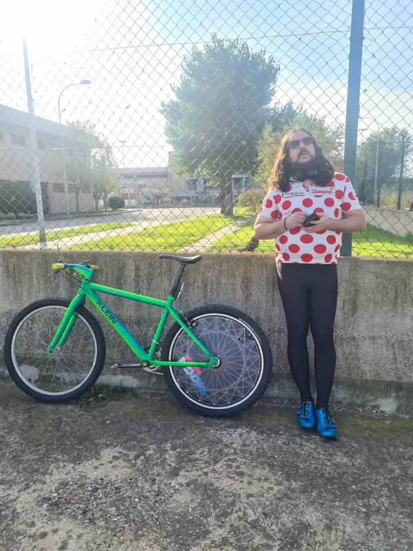

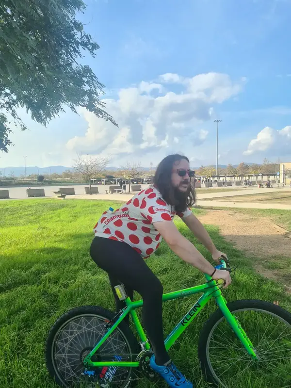

Some kilometres until rear wheel said stop. It is a little bent. I didn't want to ride more than about 20-25km, from Sagrada Familia to Barcelona Airport to see my taxi friends. I went back in a taxi.
I fell to the ground 1 time, , my balance lost to the right, I did not have time to take my foot off the pedal and I fell, haha, a small scratch on my hand and a few laughs with my colleagues.
During the ride, most of the time by road (to know how the bike goes) feedback was so happy, so rememebering whil, still enjoynig the time, today, with a beatufil morning, many people of course loioking at the bike, but riding was.. no words.. so beauty, so special
Now its time to wait for new wheels, and to see if real wheel can be rapired or not, for that I will need a very specialized mechanic and here almost no hone wants to do the jod. I will post a video later shoing how the wheel goes from one side to the other side while spining.

Where is the front wheel brake? In off-road terrain braking is done with about 80% front brake, which is why some modern bikes with disc brakes have larger discs in front than rear.
still pending to decide wich one to buy, may be from one member from here, maybe to grafton directy, maybe will be waiting for new stock on Pauls as there was and still no more stock on those Paul canti "Tourism"
Maybe it’s the picture angle but the rear brake pad on the drive side looks well out of alignment.
I changed and used the kool pads from Paul instead of the lighter ones by Steinbach, I tuned a lot of time the pads, the issue is with the rim. I will show you later in a video, I hope in about a few hours
The pad looks twisted from the side. Nothing to do with the rim surely. Looks almost like it’s touching the tyre at it’s highest point
Here's he video about the issue with the wheel, or rim ? not sure where the problem may came
