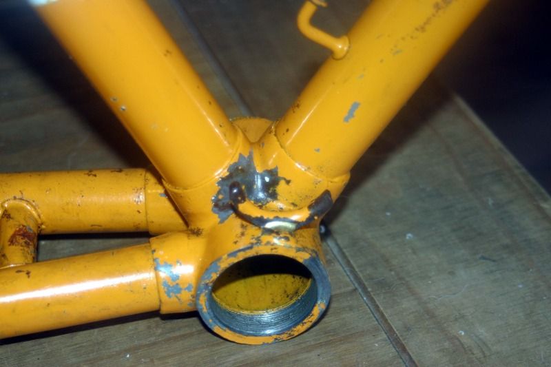

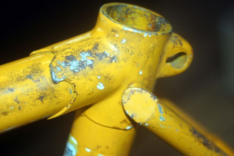

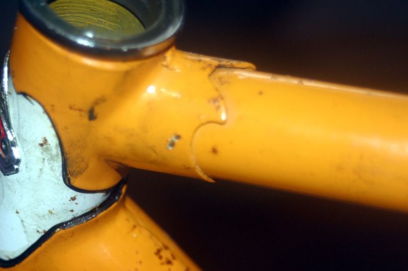

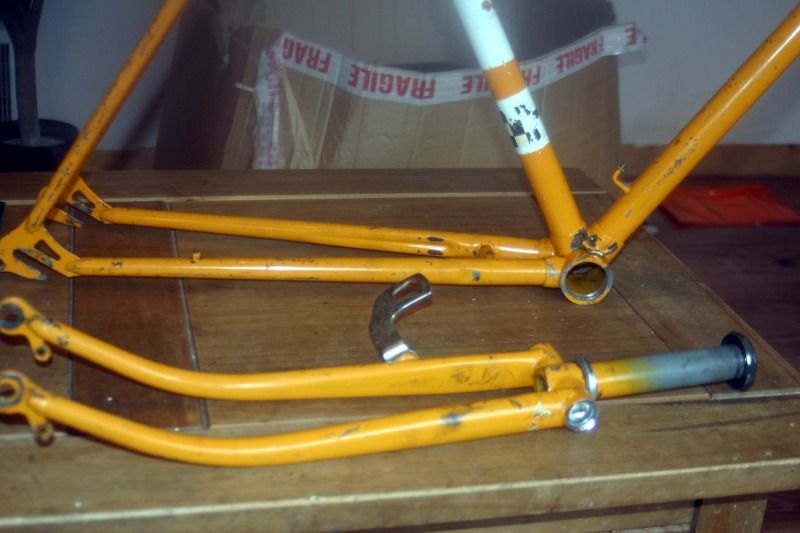

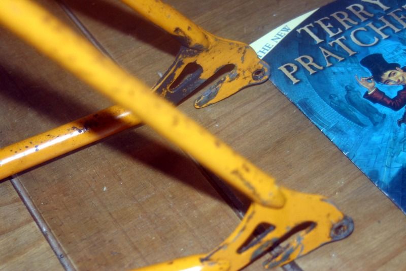

Im sure I measured it correctly,Ive just checked again from the centre and rearmost part of the dropouts to the bottom of the brake bridge/bottom of fork.If I put some decent pics of the frame on tomorrow would you chaps be kind enough to have a good look,if so would you need pics of any part in particular,thanks
Try the front wheel in it, the rear wheel will require a 10mm extra spread (probably 135mm) so would be a bugger to fit....
Slot the front in and it'll give you a good idea of what size wheel you'll be needing.

Right then,sorry to be a pain but Ive tried a 26 wheel in front and back and the results are
front leaves 85mm from centre of brake bridge to rim
rear leaves 90mm

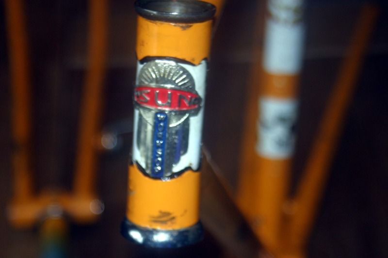

Ive had a measure of the frame and it is a 20 1/2 inch frame which weighs 3.5kg with forks and judging by the description in that catalogue scan I must assume from the colour that its a Strada.Cant find a frame number anywhere though and the seat tube decals are dead but can make out the Truwel decal and something about world team pursuit championship lol.
S bearing in mind the distances from brake bolt hole to rim on the 26" wheel can it take 27" wheels?Im itching to get started after removing a knackered cottered crank and stuck bottom bracket cup yeaterday,cheers
