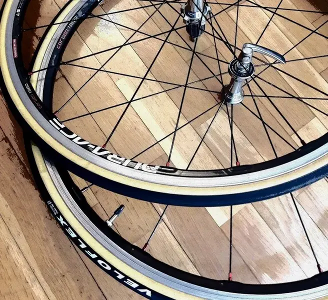

Got a good deal on a pair of light DA 7850.. One or two years ahead of the frame period but they are very nice and light. I'll keep the 7700 groupset on the rest. Looking forward to test the Veloflex masters ;)
Veloflex are very responsive & lively Tyre compared to the dead feeling of any continental Tyre so you made a good choice..
