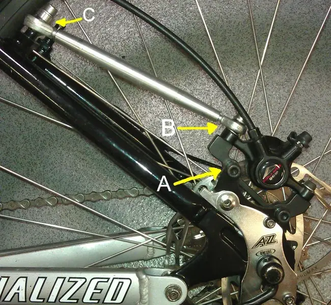

that is a lot of travel you got up front there - and im sceptical about adding a 130mm fork to my FSR.... :shock:
otherwise a nice rebuild there.
may i suggest, for the rear brake adapter, i would use something to distribute the stress from the rear dropout of the seat stay by attaching a 'strut brace' from point 'A'&'B' up to the rear brake mount 'C' (as per the original sharkfin disc adapter design) - you dont wont your front AND rear end splitting......mon Dieu!
par exemple, the image below shows a threaded rod with 2 x rose joints bolted to either end. costs around £5 (~€7)....
