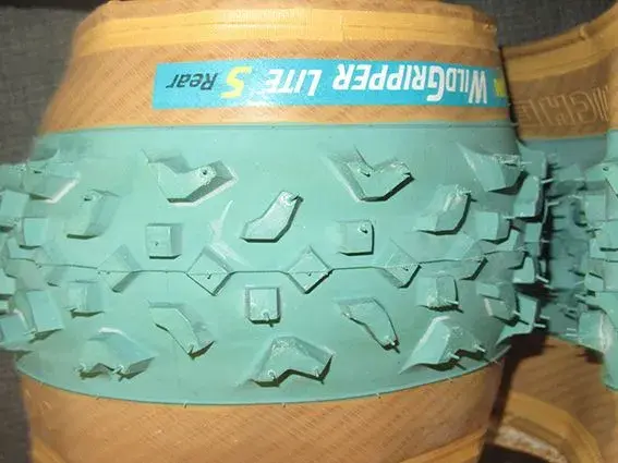

Have managed to secure a fresh set of Lite S Michelin Wildgrippers or pairing with a white pair of Panaracer Dart / Smoke for Summer that I also have stored away.

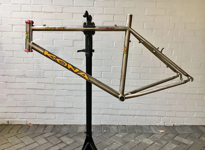

Blank canvas
>Cuts zip tie<

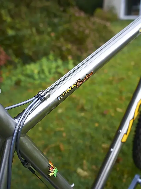

Well I'm aroused. And I've just noticed she's got 98 cable routing so I guess she was made in the second half of the production run.
Re: 97’ Kona Hei Hei
Yes indeed featuring the 3-stripes. Bottom bracket now out which was a lump of junk.

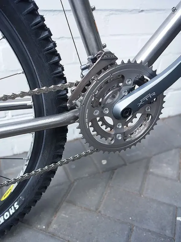

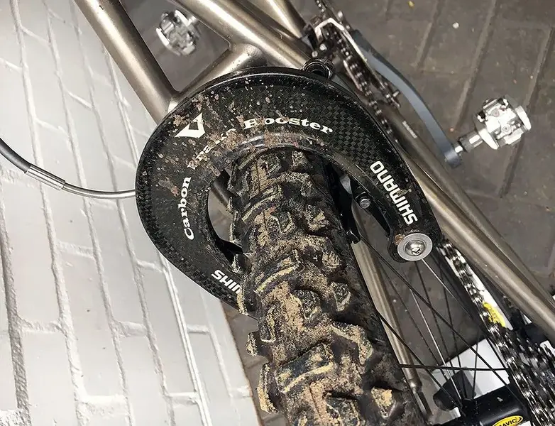

A shorter control-tech stem was also sourced to quicken up the steering, with braking enhancement via some NOS ceramic Cross-Max rims, in lieu of previous Mavic 217 sunsets, paired with an XTR SM-M950 carbon booster and a fresh set of KoolStop pads.
Lastly, some spacers were installed to the BB shell to help improve the chain-line across to the smallest cog in using the M950 Octalink BB.
