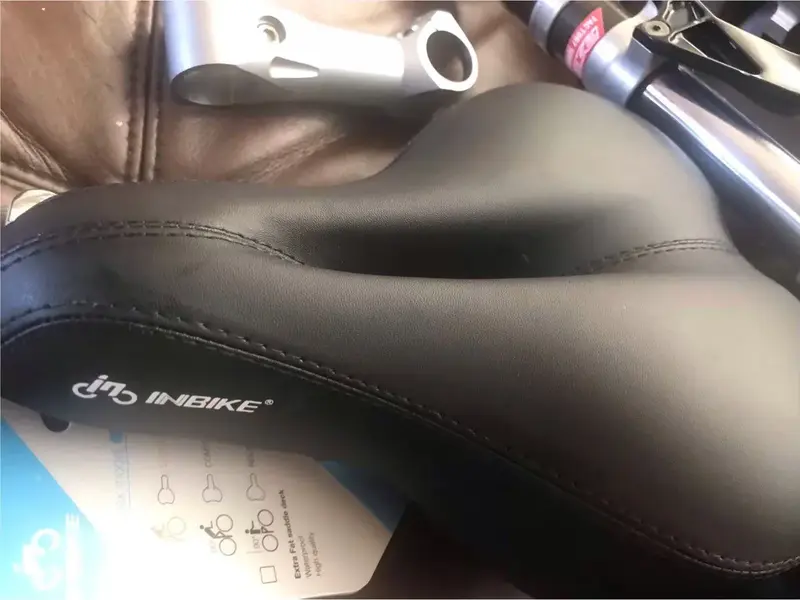

Collect bike from my grandads tomorrow and 1st item to make sure I don’t immediately regret it and never use it again has arrived. Discounted on amazon I have one of the inbike saddles which I hope will prevent any injury from being a heavy sod, canny grumble as a few group tests for heavy riders put it top or near top and was down to £17

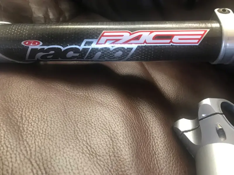

Other bits to go on are a new headset (well a ritchey one bought on here), Recently serviced pace rc36 evo 3 and a pace stem are to go on (elastomers will be old and fecked and tbh can’t seem to get hard elastomers anywhere) so hopefully the evo 3 should give me some useful suspension travel and suit a heavier weight without really changing the overall look of the bike as it was when I bought it.

New bits

Nice stem. Forks look in good nick too. Agree about the elastomer ones. Had them myself but even if you can find them, the hard ones reduce travel down to about 40mm.

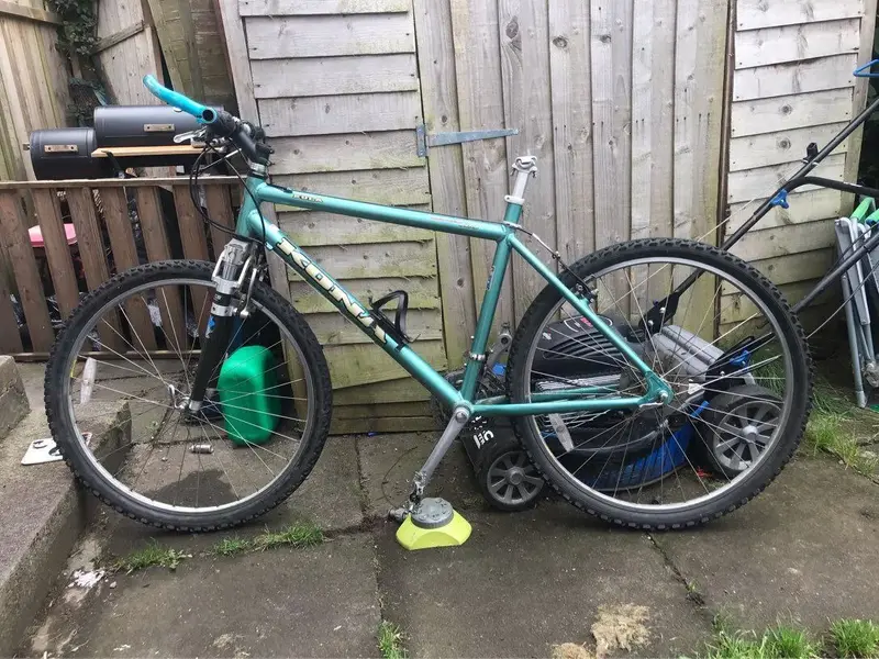

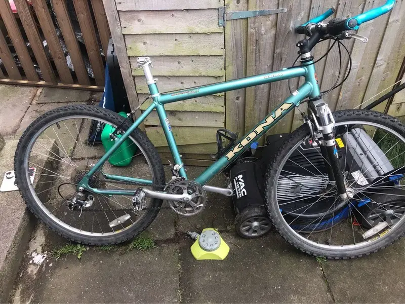

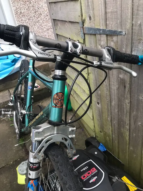

And to the bike as it stands (seatpost low, stem short etc as my mum was using it and well she’s a short arse and it was too big).
Not cleaned or given any attention apart from giving my mum her saddle.
That’s to come as got cleaning stuff, lubrication and grease etc.
