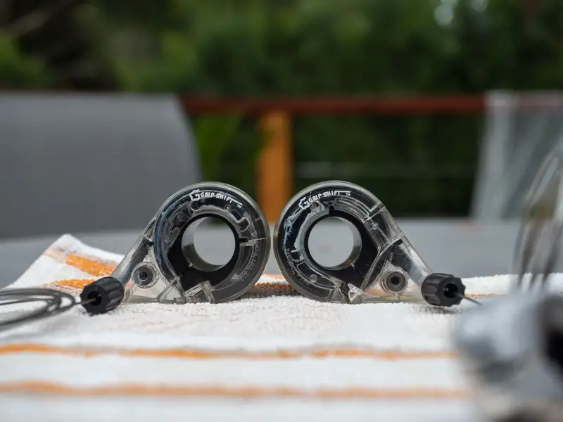

> Gearing: Let's just say GripShift never sparked joy.

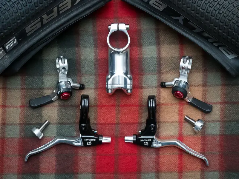

Proposed Spec
Basics
Butted Cromo Frame, DiaCompe Headset, 'Zenith' 70mm stem and 3ttt Xtreme Flat Bars
Braking

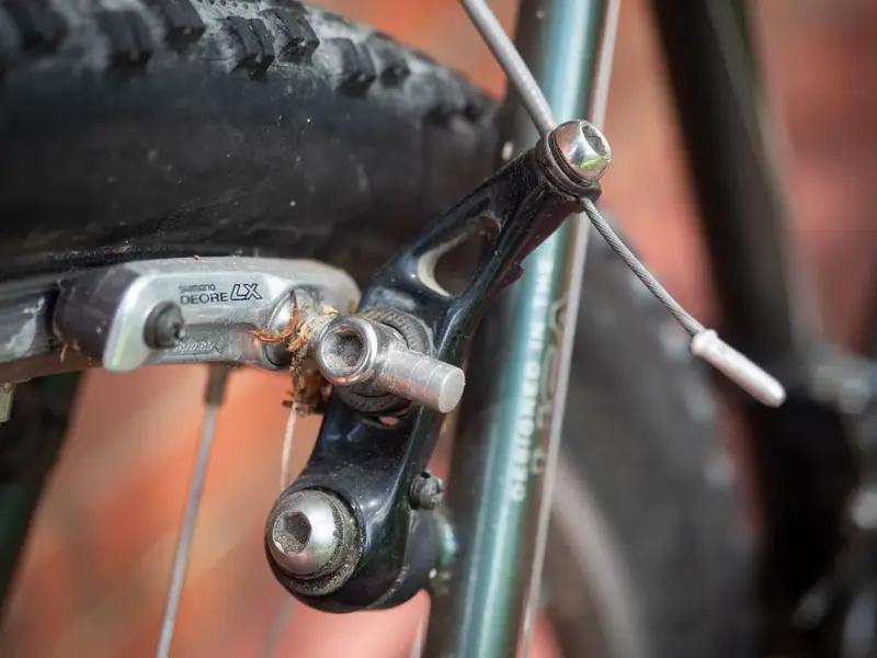

Shimano LX M563 Cantilevers mated to Dia Compe SS-6 levers.
Pads are dried up rim-eaters so I'll use some Jagwire jobbies untill I can source Shimano M/65T cartridges
Drivechain

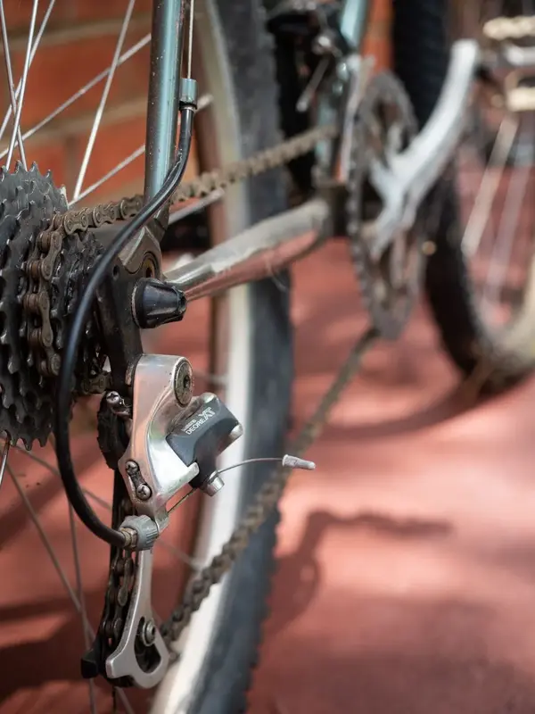

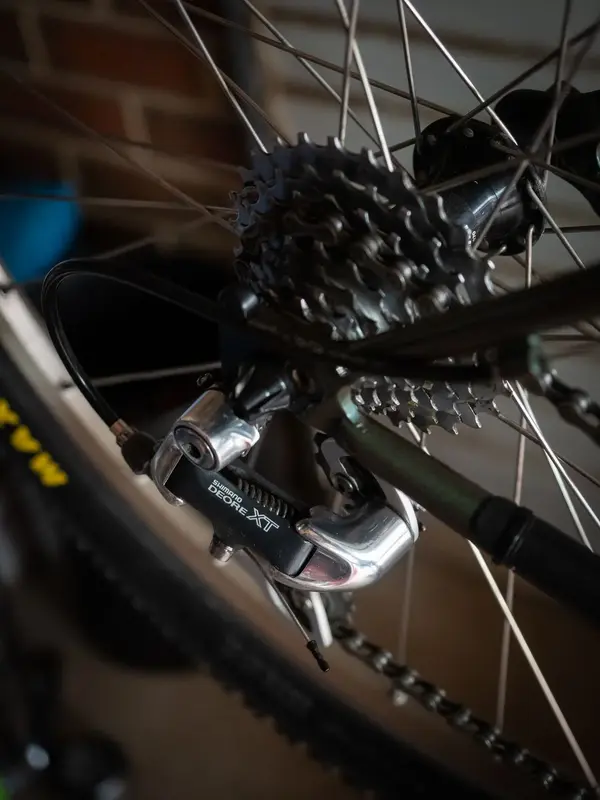

Shimano LX M563 (F) and Shimano XT M739 (R) derailleurs mated to MicroShift SL-T08 Thumbies.
Cranks Shimano LX M563 with Shimano UN52 BB
Chain and Cassette and Rings: Original Shimano 8-speed
Crank Bolts: Specialties TA (Self-extracting crank bolts are my favourite bicycle component)
Pedals: Original EXT-Pro (for show) and Wellgo V8 copies (for use)

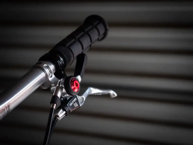

The Avid SD7 levers are not stock and were an addition by me (long before an understanding of pull ratios...)
These pads are not doing the rims any favours either.

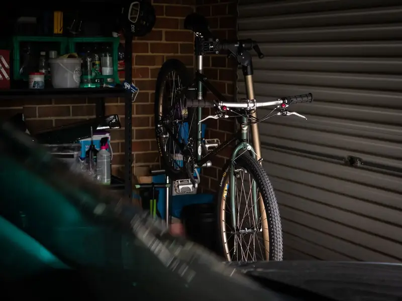

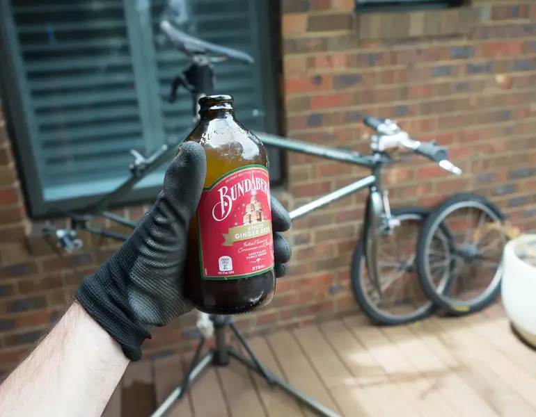

Part II:

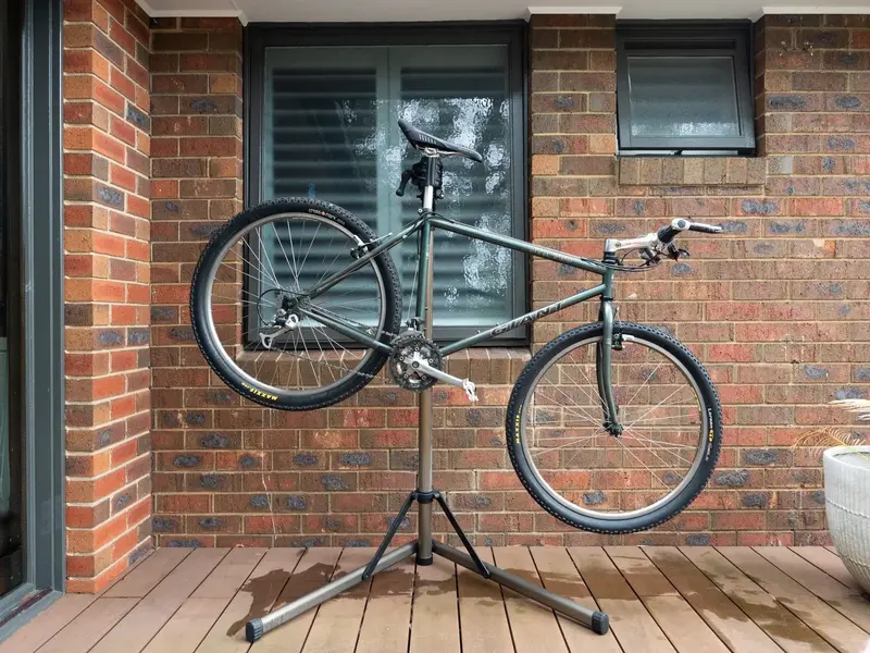

In the workstand.
Up yer get.

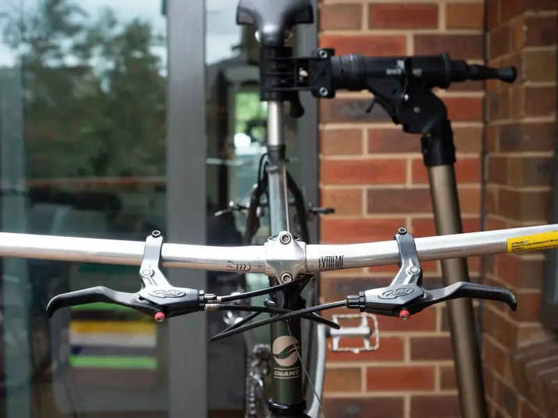

I love these levers but even with the adjusters, the mechanical advantage isn't appropriate for the cantilevers.
Bye lads.
This bike still has all its sticker.
Thanks for reading!

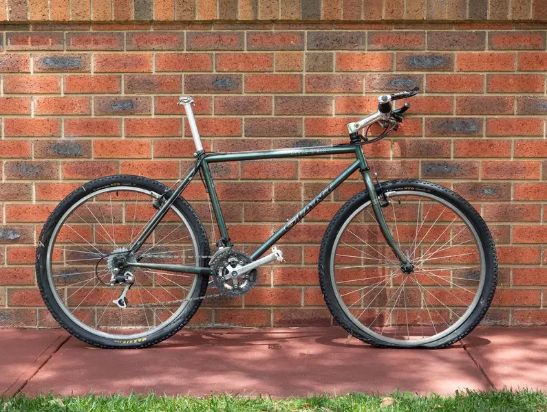

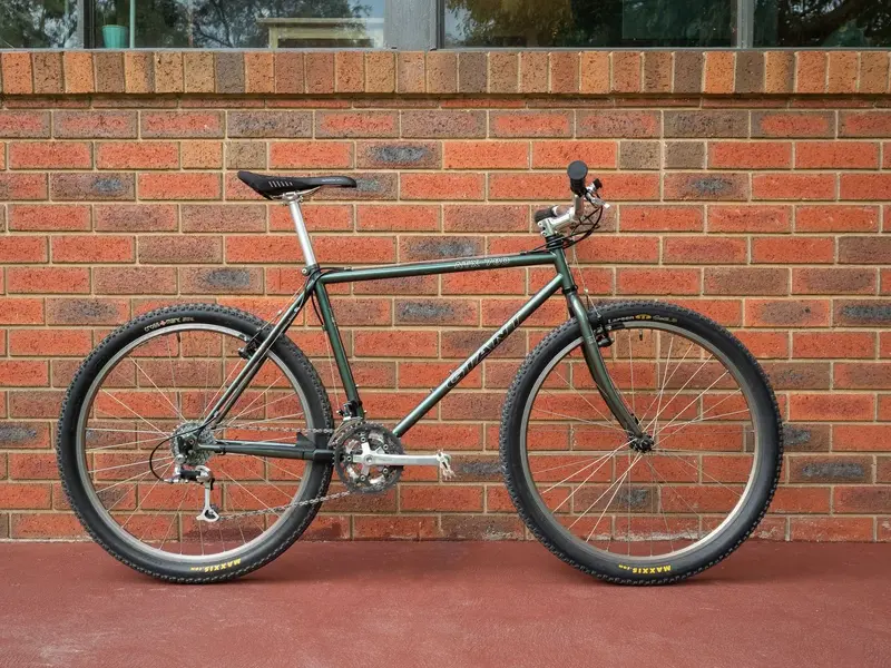

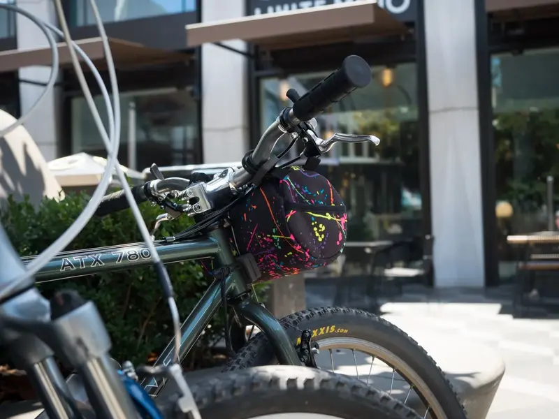

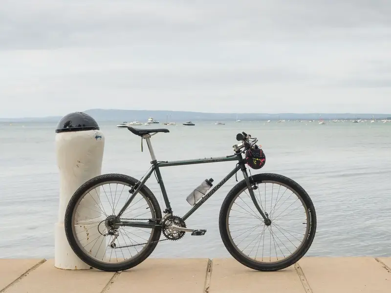

Well the bike cleaned up an absolute treat! I can't believe how good the paint turned out - I can't stop looking at it!

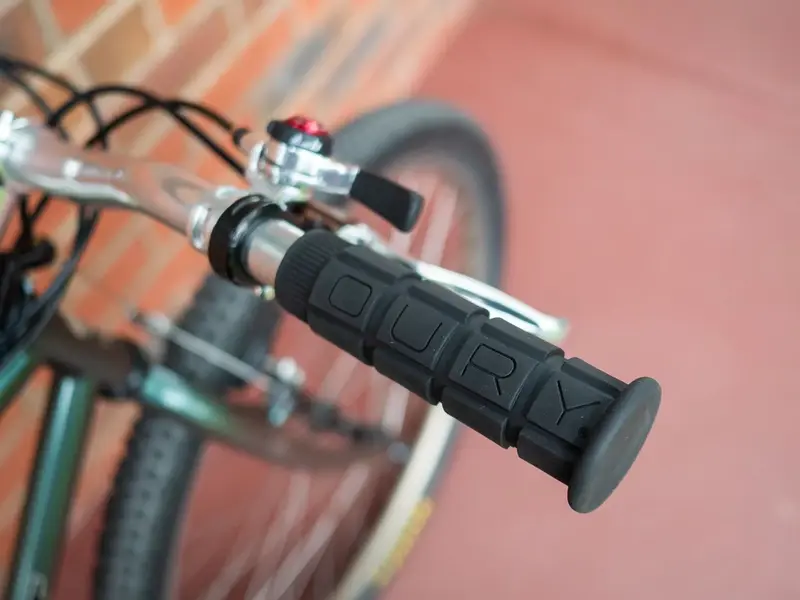

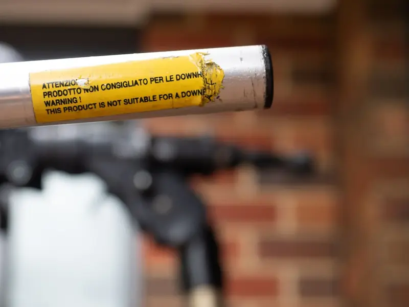

I originally intended on running the original 3ttt flat bar without the bar ends but it looked a little strange with the short stem. Looking through the parts bin, I found a generic black Giant riser bar witha 25.4mm clamp and using some oven cleaner + steel wool, was able to strip the anodising to bare aluminium and polish to match the rest of the cockpit. It's not perfect but I'm really happy with the outcome.

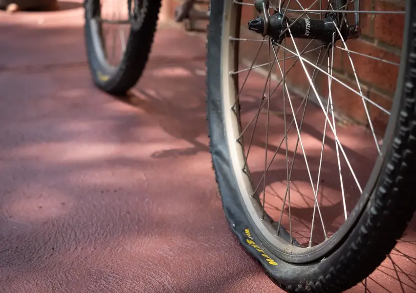

One little hurdle was the brake pads; the 65mm LX cartridges were very hard and not at all doing the rim braking surface any favours. I've fitted some Jagwire pads but I'm curious as to whether Kool Stop still make something to suit?
I'm super happy with the parts choices - whilst not original, I think they're very much in keeping with the spirit of the bike.

It's a different bike with revised cockpit. The original set up was quite long in the reach and rather uncomfortable for longer rides. I think this strikes a balance between looking original (or at least in keeping with the period), but _actually_ enjoyable to ride!
I've been investigating these brakepads a little further. The original LX pad is called the M65/T of which OEM options appear to have dried up a long time ago. It appears Kool Stop make a replacement insert called the KS-LXSA which are about £30 / $55 and are still available. Might give them a go and report back!
