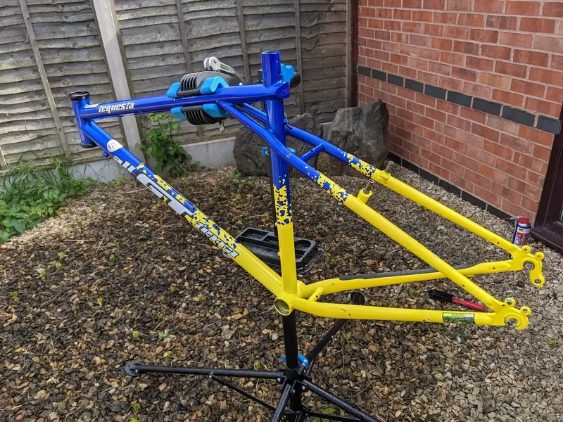

I tried tidying this up for a trip next week, thinking it just needed a bit of a clean... and ended up completely stripping it down 😄
The BB that came out of it doesn't feel great so I'm trying to pick out a replacement.
The one I took out measures 110mm long, the shell of the BB on the frame measures 68mm wide, all good, right?
Why does the catalogue say it's a 73mm BB then? Anyone have any idea whats going on? Is it not a 94?

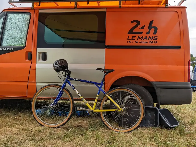

As is tradition, I finished this very last minute, brakes cabled the morning we left and adjusted when we got there.
Broken STX shifters replaced with XT thumbies and Dia Compe, broken STX rear brakes replaced with LX (I think).
New tyres, grips, pedals, saddle, everything else is stock.
My first time to Le Mans for the 24 hour race and my first ride on the Team Scream, great memories.
That's strange. I thought Tequestas were 73mm BB.
If you're willing to share the frame number that should help confirm the year:
