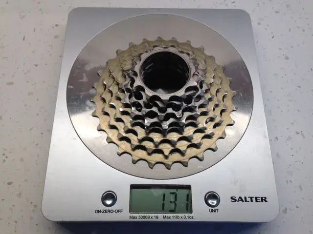

This post is primarily a big fat 'Thanks Bud!' to PipMeister, who, being an utter gentleman, offered me something that he bought new in the 90s, at the Cycle Show Olympia, from the Stif stand.
I hoped I'd be able to fit it over the weekend and have a weigh-in, but;
1) I couldn't get hold of the calibrated scales
2) bought a bike for my old Mum, and fixed that up
Regardless, I'm still super-excited about... this...
Woop!
I thought the silver cogs were Ti, but a BETTER magnet revealed they were steel. Crazy light!! Thanks again Pip!!!
