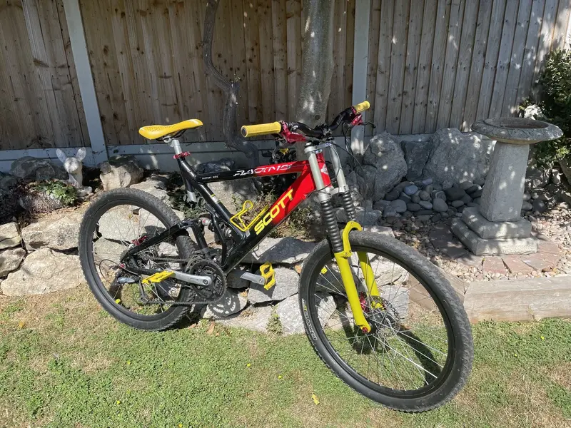

Having been into MTBs in the 90s (before I could drive) I had a Trek 830 antelope which was stolen, replaced with a Carrera then I bought my first first Scott vertigo comp which I sold (and regretted ever since) so when one came up for sale 10 years ago, albeit a later one with snd Ali rear triangle, I jumped on it and it’s now my dedicated off-road bike. Still despite being a 25 odd year old bike it still rides brilliantly.

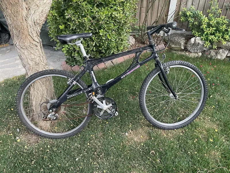

Fast forward to a couple of days ago, another bike I really wanted back in the day came up for sale locally so I snapped it up, a Kirk revolution. I’m planning on a complete rebuild (it’s stripped already) but I’m torn between going for an authentic retro build or just “building it” it’s only going to see road use with the occasional track as I live in a semi rural location. Any way have some pics.

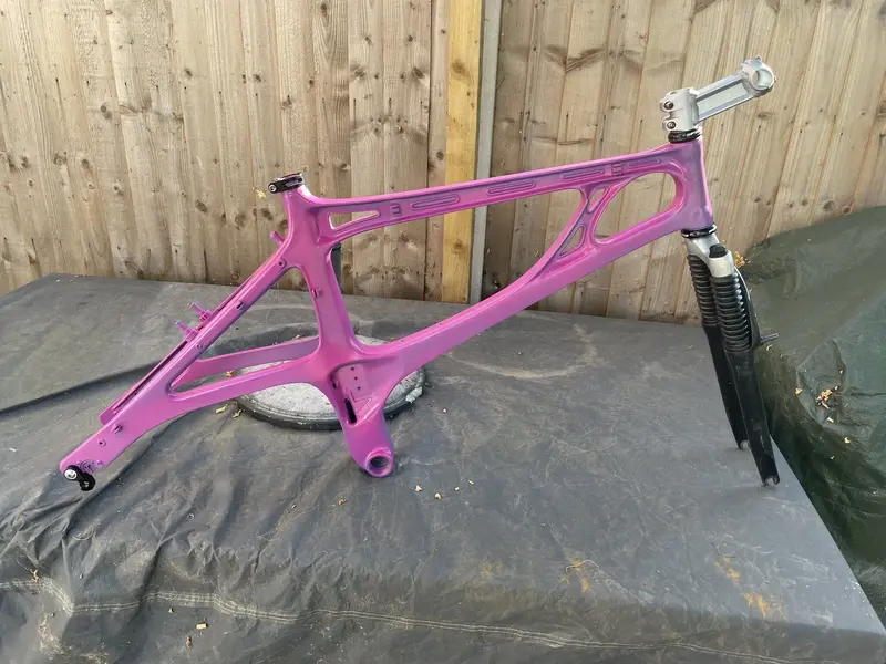

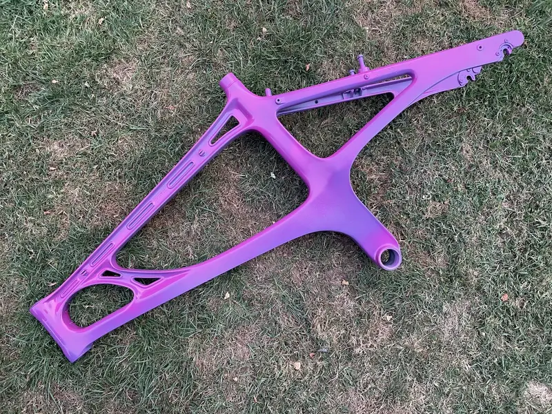

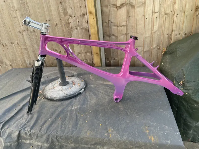

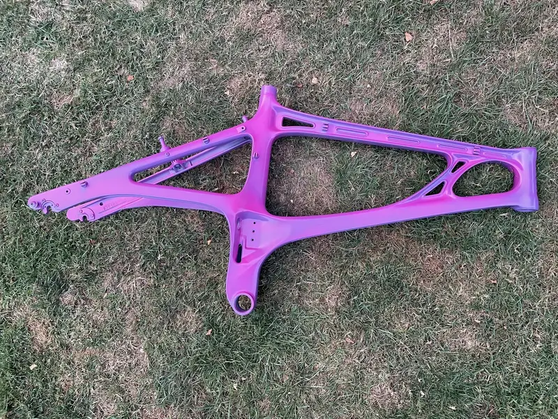

Well I stripped the Kirk frame down, the shifters didn’t work, the brakes were past saving, the rear wheel was grooved from rear pad wear and I had to use an angle grinder to the cranks off, but here is the painted frame.
My daughter chose the colours (she’s 5) and I hope to pass the bike on to her at some point. I painted it purple whilst was upside down, then pink from above once flipped over which had given it this cool neon look. It’s has 5 coats of lacquer to protect it.
So far I’ve got an ibeam stem, some Indy S forks and some Araya rims on Polestar hubs with an 8 speed cassette and an XT rear mech. The front was an LX which I’ll re use as it’s frame specific and in good condition, just needs a clean and a re-grease.

Looks cool. Weren't these cast at 10000 Deg C in a top secret bunker?
Yeah something like that. Injection moulded frame, the brake mounts, dropouts and rear hanger are all bolted on and the threads for the BB are bonded in. It’s quite a bit of engineering for the 90s

Started building the frame up today. Only the headset, forks and a Club Roost Ibeam stem, oh and seat post clamp because it takes a few seconds to slip on 😂
Forks are some old Indy C’s I had laying around. Not the best fork in the world, but after a service and a clean, they’re back to their best.
