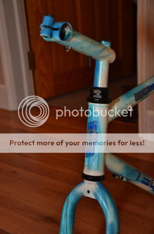

'90 GT Tequesta Nimbus.....
New headset fitted

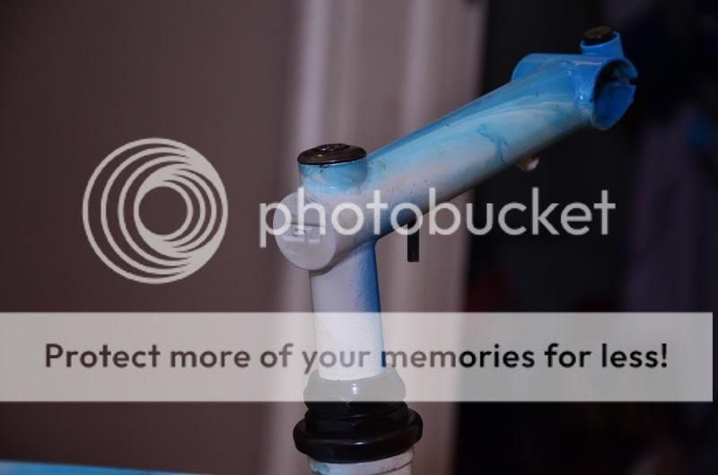

Stem paintwork touched in
Some bad chainsuck still to sort out. New bearings fitted to bottom bracket (+ clean out & re-grease)

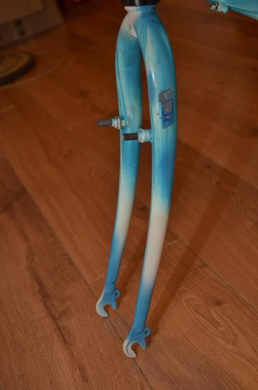

Fork paintwork cleaned up and touched in
New seatpost installed (with plenty of grease!!) and a Miche quick release clamp from the spares box. Starting to look a little more respectable.....

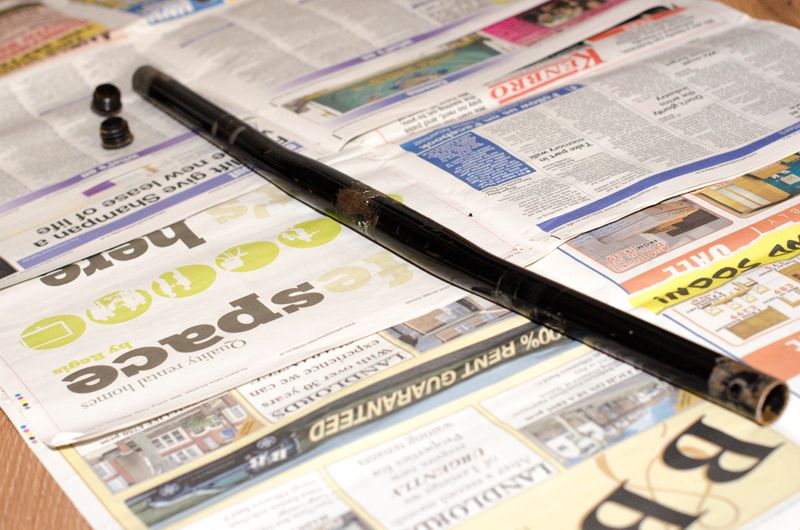

Just sorting out the handlebars now - going to stick with the original steel bars as they're uncut and original. They just need paintstripping and a minor amount of rust sorting before a re-spray in gloss black.
Handlebars prior to refurb - not too bad, little bit of rust around the stem clamp area and a bit of shifter/brake lever scuff.....but way better than some of the Tequesta steel bars I've seen on other projects
Attacked with some Ambersil gasket stripper (works well as paint stripper)

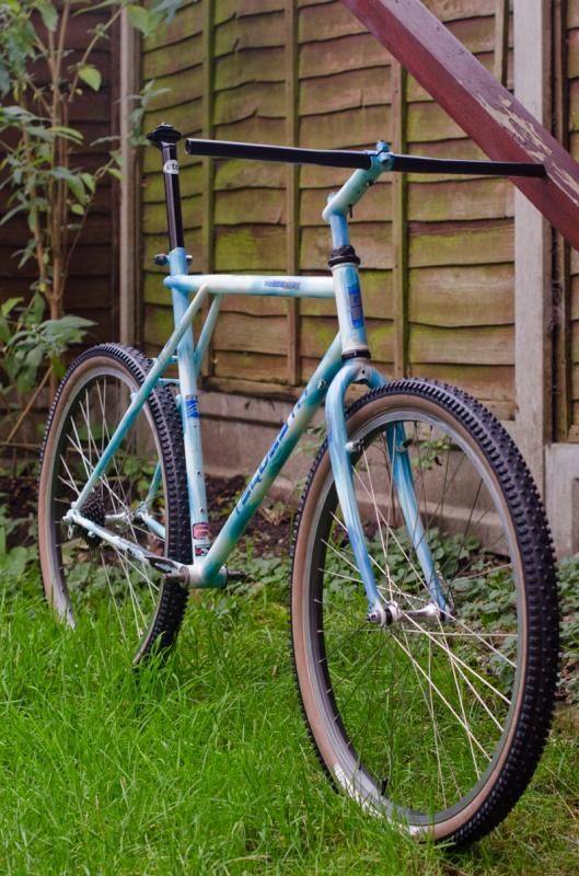

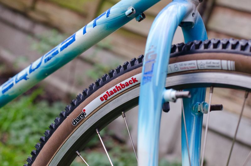

Cleaned up the rust with 60 grit paper and applied Kurust, followed by coats of etch primer, filler primer (avoiding filling the GT logos with paint) and 3 coats of gloss black. Also gave the wheels a good clean and polish and fitted my new charge splashbacks.
Starting to look like a bike again......

Bit of a budget build this as the bike originally only cost me £35. I've spent waaay more than this now though but I've kept it sensible and relative to the cost and quality of the bike.

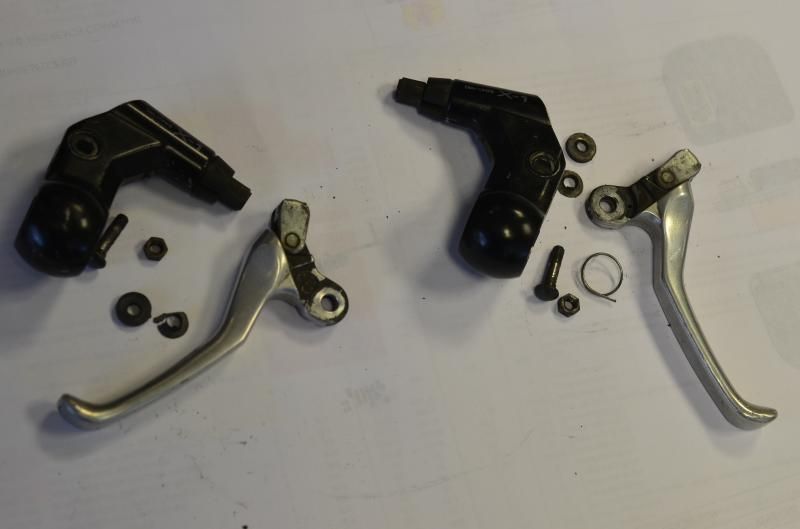

Gears and brake levers are next on the agenda - just need to replace a return spring in a lever as it's missing on one side.....as with a few things on this bike it seems that over the years this have been dismantled, played with, adjusted badly and generally not re-assembled correctly.
Not sure what I'm going to do for a replacement spring yet - canti brake return springs are the right diameter so I may be able to cut one down to suit. The wire diameter is larger so the spring rate may be too much but we'll see....
Also going to re-spray the levers as they would've been black originally.

Made up a new brake lever return spring by cutting down a spare canti brake spring.....works a treat! New one is on the right :)

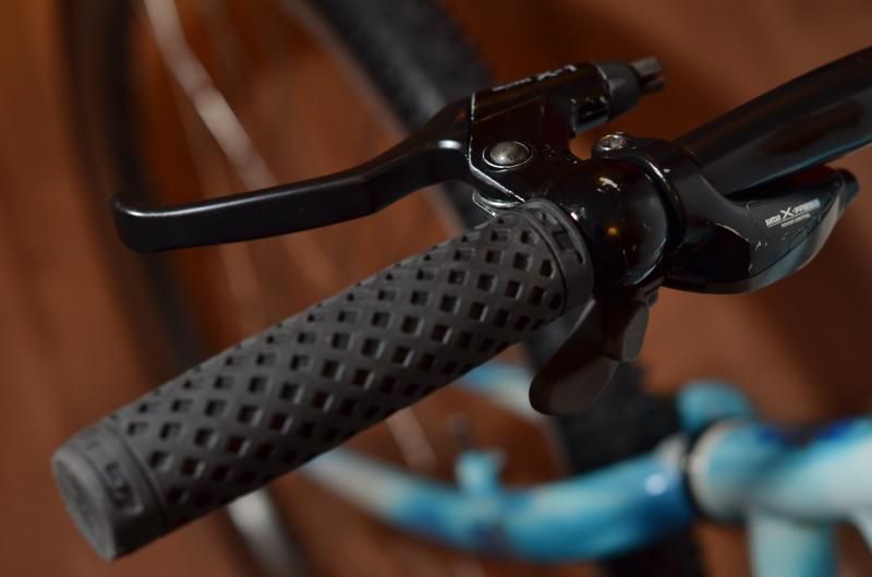

Carefully refitted the gear shifters, followed by the brake levers and then the waffle grips.....taking great care not to zig-zag scratch the bars (nothing more annoying!)
Waffle grips close up....
Coming together well.....! :)
