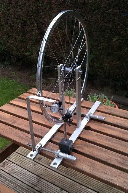

Dial gauges are nice once you get down to the final part of truing, I have them on my stand, but they are a bit of a luxury and as Rampage says, no use for dishing a rear wheel at all. For this I almost always use the frame the wheels are going into.
I say go for it. I started building my own wheels a couple of years ago and I find it very satisfying.
For a while I used a frame clamped to my bench for trueing, then I ventured forward to build an adjustable jig, from some scrap aluminium machinery parts. It wasn't as daunting as I thought it would be. (I was lucky that the parts worked out well.) Cost was £20 for the dial gauge off ebay.
One top tip I can give is to take extreme care when lacing up. Those stainless threaded spoke ends will scratch your precious alloy rims in the blink of an eye. Bitter experience... :facepalm:
