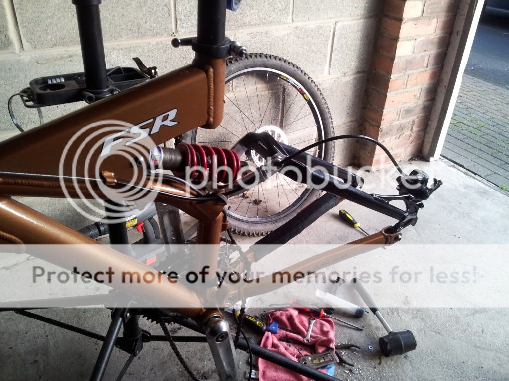

2003 seat stay will not fit without mods, the top of the stay where it bolts to the linkage is about 2mm wider than the 98 FSR linkage.
Now the FSR linkage can probably be adjusted by giving it a bit of a bend, but that still leaves how to actually mount it.

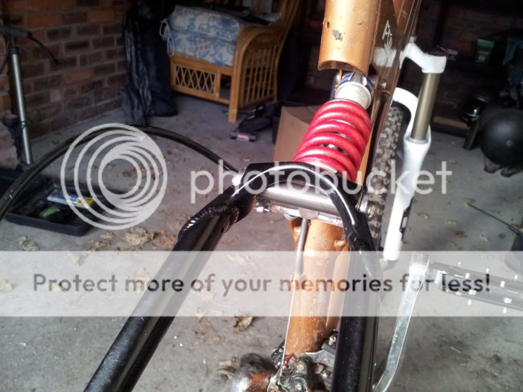

Dont think so, if you look at my photo, the top of the seat stay has two holes with threads cut into them, this section is wider than the stock 98 linkage by approx 2mm (ish)
Now the two holes can be drilled out a little so the stock 98 bushes will fit, this seams easy enough in theory, they probably need to be enlarged around 2mm, plenty of metal around that part.
The stock linkage would need widened a little, i1m not sure what it is made of yet, but it looks like it could be simply forced open a little to take the new wider seat stay, or i could machine down the actual seat stay maybe 1mm per side

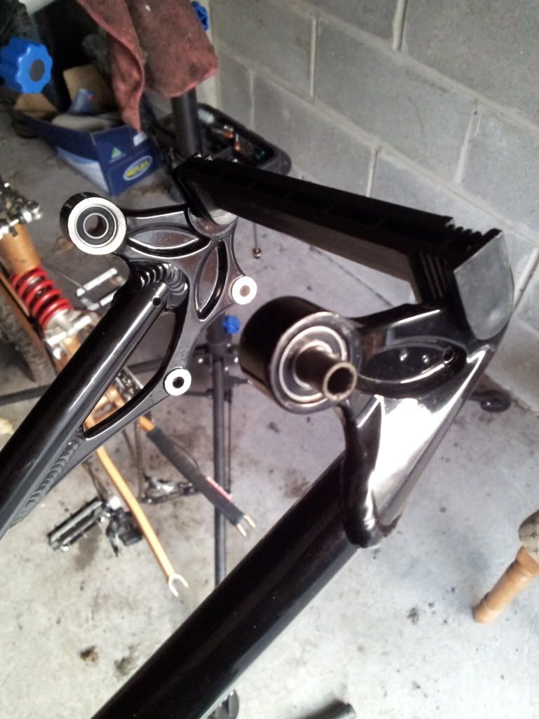

These parts of the stock 98 bush are the exact right size to slip into the 2003 enduro bearings, win!
So the chainstay can be bolted up super quick once some spacer washers have been added to key the new stay in the middle of the chainstay joint.
But the shock linkage to seat stay will cause a problem as i originaly thought.

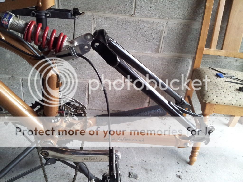

I spent HOURS cutting this down a little at a time by hand, with a hacksaw and 3 different metal files, i got it so it would slide into the linkage, then i drilled out the holes to 16mm, this allowed me to add in the 98 plastic bushes.
Here you can see it all bolted up, with the stock 98 bushing fitted and running through the new seat stay.

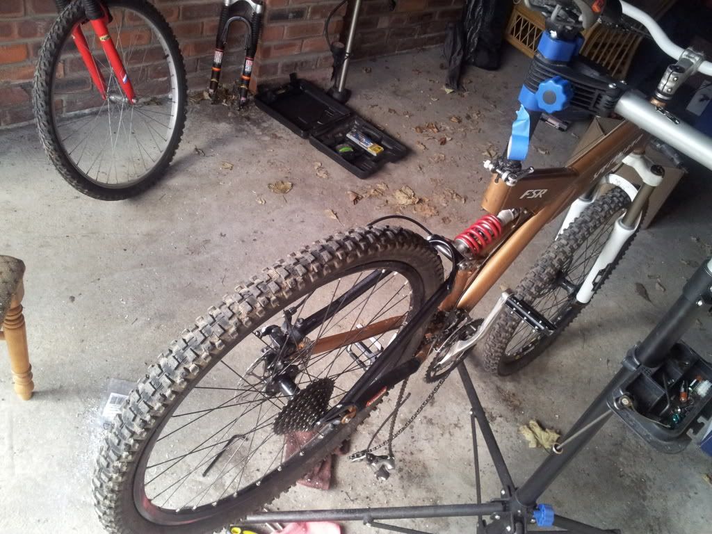

Lets add the rear wheel anyway!
The rear wheel will only fit if i let the tyre down (wtf?)
It would appear that the enduro dropouts are around 2cm in towards the crank compared with the 98 ones, i can only assume that the enduro has LONGER chain stays to compensate for this.
