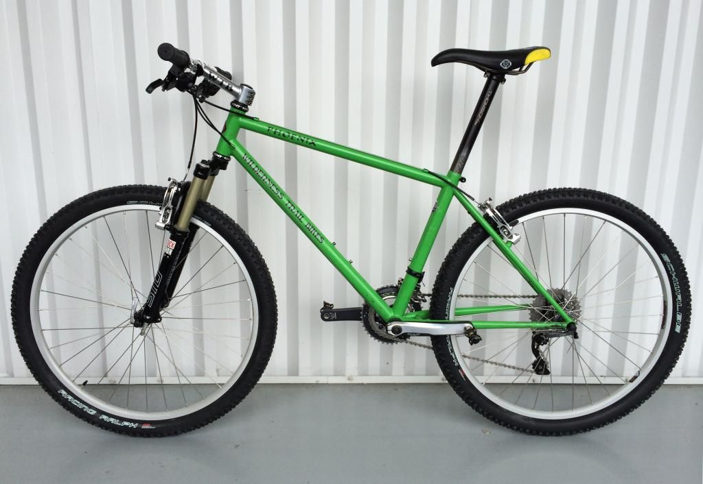

This bike came to me from outside Seattle, Washington after I came across it in a craigslist ad. The previous owner said he purchased the bike directly from Mark Slate. He also indicated it was a '97 but there's no serial number on the frame to confirm. The frame has been repainted once in Kawasaki green. However, the paint was thin without a clearcoat and hasn't held up well, so eventually I'll have it repainted. It came to me with heavily used XTR M950 groupset and other equally heavily used late 90s components.
Originally, the plan was to build it up with as many period correct WTB parts as possible and refresh the period correct XTR M950. However, with some of the WTB parts I tried I was a bit disappointed with the quality compared to the earlier classic components. I ended up keeping the titanium flatbar, the Powerband stem, the Powerbeam rims, and the SST saddle. After seeing Halaburt's 1996 Phoenix Restomod, I also decided to go in the Restomod direction with the latest XTR groupset in 2x10 and a mid '00 Rock Shox SID.
Frame: 15" Wilderness Trail Bikes Phoenix, 140mm rear spacing
Fork: 2004 RockShox SID Race (80mm of travel currently but with the correct spacers will be reduced down to 63mm)
Headset: Chris King
Stem: WTB Powerband Ahead
Handlebar: WTB Titanium
Grips: WTB Original Trail Grips
Front & Rear Brakes: Avid Arch Supreme
Brake Pads: Kool Stop Thinline
Brake Cables: XTR with Wheels Mfg Ferrules
Shifter Levers: XTR SL-M980
Brake Lever: Avid Speed Dial Ultimate
Front Derailleur: XTR FD-M986
Rear Derailleur: XTR RD-M986
Derailleur Cables: XTR with Wheels Mfg Ferrules
Cassette: XTR M980 11-34T
Chain: KMC X10SL
Cranks: XTR FC-M985, 175mm, 30/42T
Bottom Bracket: XTR FC-M985 (To be replaced eventually with Chris King, black)
Pedals: Crank Bros Eggbeaters w/ custom Titanium Axles
Hub Skewers: XTR-M950
Rims: WTB Powerbeam, 32H
Hubs: XTR-M950 (To be replaced eventually with Chris King Classic, black)
Tires: Schwalbe Racing Ralph
Saddle: WTB SST Titanium
Seatpost: Thomson 31.8x400 (To be replaced eventually with Syncros 31.8x425 Titanium)
Seatpost Binder: Specialized Titanium

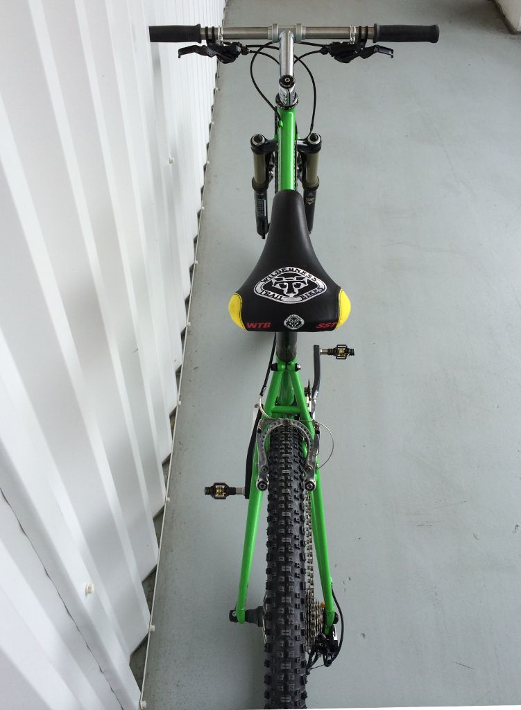

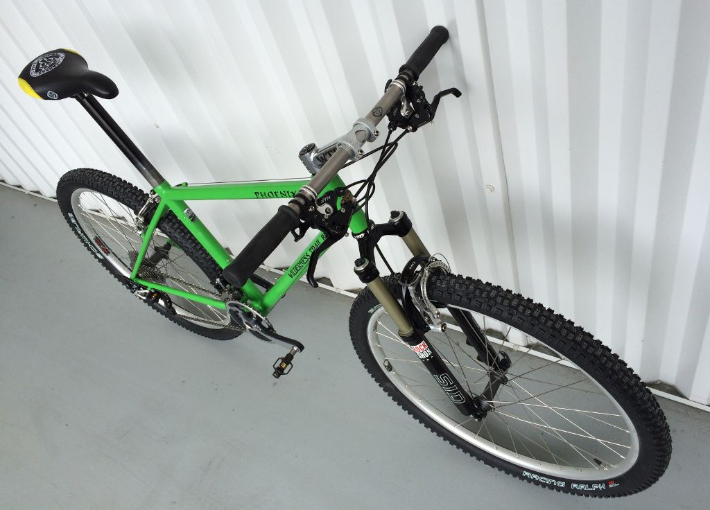

Weight:23.2lbs (As pictured below)
There are still some items to finish up, like the repainting the frame, replacing the hubs, and finding a new seatpost but even as I've been in the process building it I've continued to use it as a regular rider.
