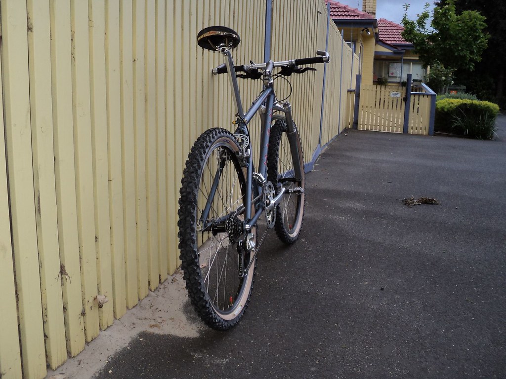

Can't wait to ride it though, if i get the bits I'm waiting for this week it might see some action this weekend!

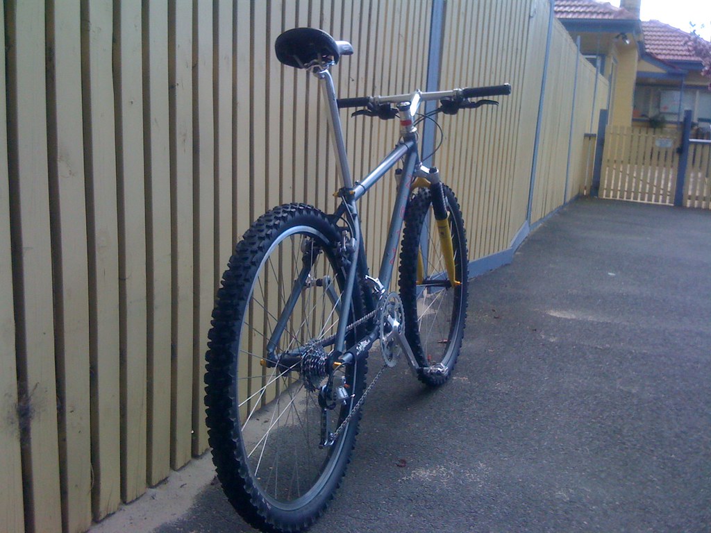

Well bits finally arrived so i could at least get the drive train sorted out and go for a bimble!
Rides well and although I couldn't really give it the beans it changes tack fairly well and feels very nimble! Can't wait to give it some stick off road.

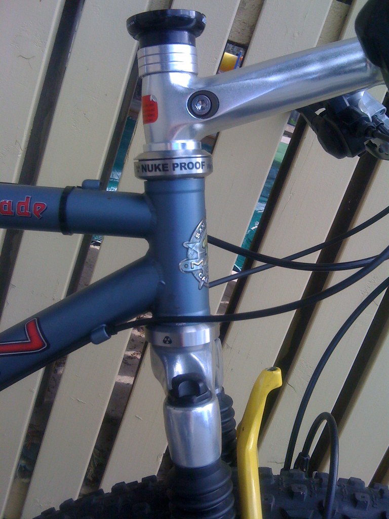

Ignore the comedy stack above the headset, i didn't want to cut down the steerer of these Quadras since I am going to use different forks, I bought Steve's Psylos and i have a set of Dukes I might trial out to see which one i get along with. Also I haven't bled the brakes or fitted pads so it was an old school foot on back wheel braking session haha. Have to find my magura vice clamps so I can make up the cross over hoses.

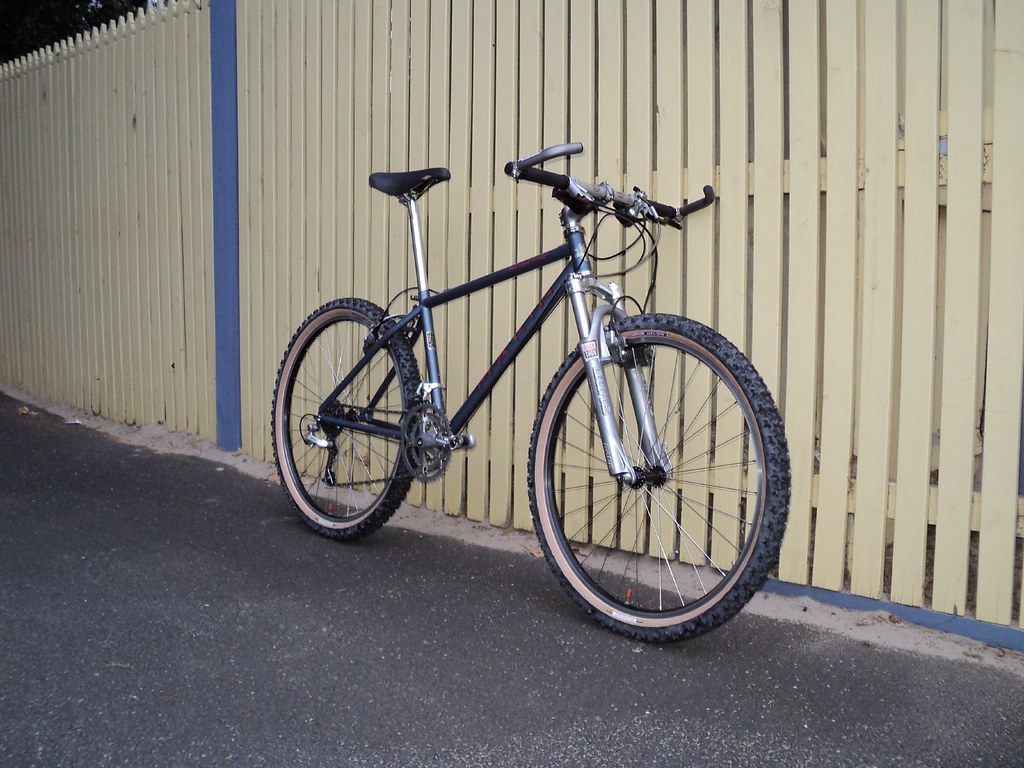

October and latest specs!
Edited Spec (30/10/11) :) I may have the seatpost resprayed to match the stem and get the decals done, kind of cheating but I can't find that damn post anywhere. thing is a Ritchey post is a rebadged Kalloy like this one anyway!

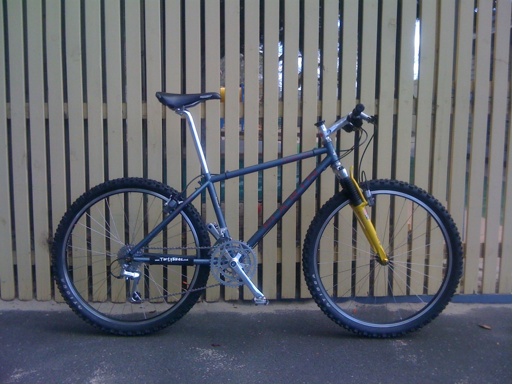

Still not quite finished awaiting some Ritchey handlebars and some Ritchey TGV grips, (now fitted) then bar getting a rare Ritchey matching seatpost, I reckon she's done. Gave it a thrashing this weekend in the mud and she handles superbly and with the shorter stem steers like an exocet handy when me and Pfennig nearly hit a couple of damp kangaroo's looking mightily pissed off!
So current speceroos are:
Fork: Rock Shox Duke Race 80mm with Blackbox remote lockout
Headset: Nukeproof Warhead ST 1.1/8
Stem: Ritchey Logic
Handlebar: Ritchey Pro
Grips: Ritchey TGV
Barends: Ritchey Logic
Brakes: Magura HS33 with Evo Mounts and Booster
Brake Pads: Magura Black
Brake Hoses: Magura Standard
Brake Levers: 2005 Magura HS33
Shifters: Shimano STX 8 speed
Front Derailleur: Shimano Deore FDMT60
Rear Derailleur: Shimano Deore RDMT60
Derailleur Cables: Transfil Black Snake
Cassette: SRAM PG850
Chain: Wipperman Connex
Cranks: Shimano M730
Crank Bolts: Brand X Self Extractor
Chainrings: 22 Onza Buzzsaw 36, 44 Shimano XT
Chainring bolts: Brand X Gold Ano
Bottom Bracket: Shimano UN54 68 x 122
Pedals: Shimano M520 Silver SPD
Hub Skewers: Ritchey Titanium
Rims: Specialised Alex
Hubs: Shimano Deore
Tyres: Ritchey WCS Alfa Bite 2.1 Kevlar
Tubes: Tioga
Saddle: San Marco Rolls
Seatpost: Kalloy 400mm x 27mm
Seatpost Binder: Brand X Gold Ano
