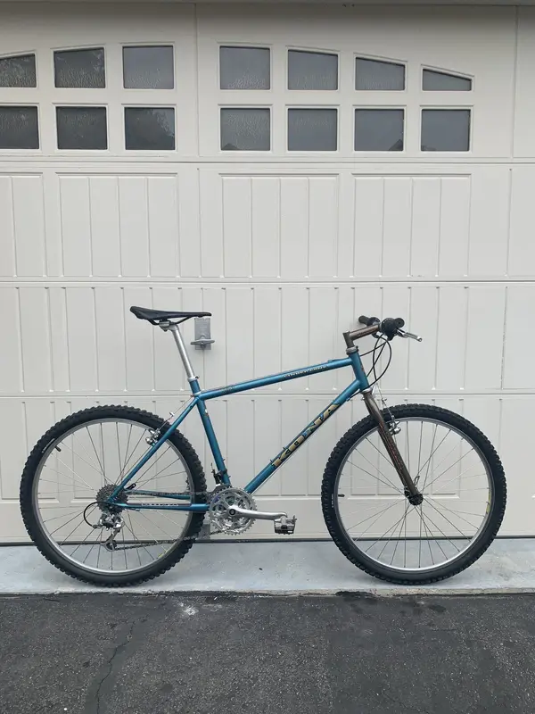

Picked this up over the weekend. Aside from the downtube decals it is in amazing condition! Looks like it has hardly been ridden and any scuffs are likely from storage.
I’m in touch with Gil to get some new decals. I don’t really see the need to touch the original paint because it is in such good shape, so I don’t want to get into repaint stuff.
Are these decals on this era of Kona typically applied over the clear coat? Any tips on removing them carefully for those who have done it?
Sounds like Gil can add a layer of clear laminate to improve durability.
Very nice.
I would be tempted to leave the original decals too, maybe just touch them up if that bothered about them.
I realized that this morning that this is probably a 1995. Was just going on what the seller mentioned.
These are like my fav bike graphics/decals our of any era of bike. So I have this desire to want to fix them up. It is really just the "N" on this side of the bike, and similar on the NDS, not the entire decal. But not confident that I could just replace one section—unlikely that the color match would be that good I think. The rest of them I can live with for sure, the wear is minor.
Possibly an option to get as near as possible colour vinyl sheet, cheap enough on Ebay as you don't need much, and cut to match, don't think there is a clear coat.
I was also thinking that might be an option for the replacement decals, just to sub in the one letter I need to replace on each side, and the other ones could potentially be taken care of with a bit of touch up paint.
