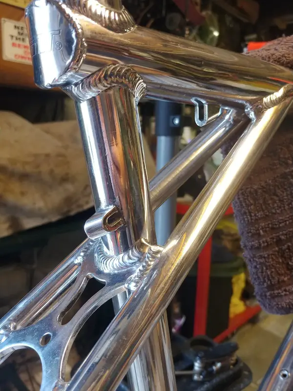

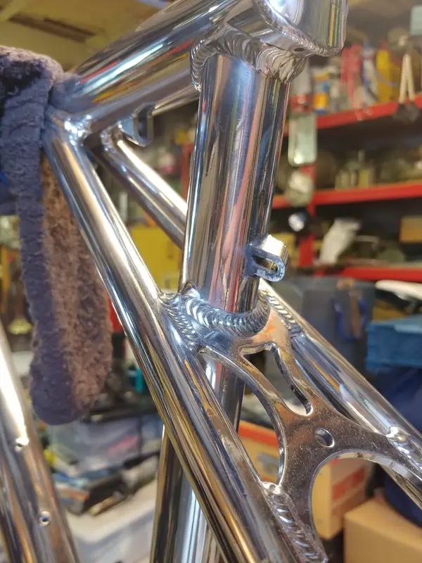

Hiya Mickeysinn, thanks for your reply..
There is a braze on near the head tube, to carry the rear brake outer cable, it is ally welded to the frame about 3.5in from where the headtube joins the downtube, then there is a run of bare brake cable, which goes to an ally braze on to the underside of the toptube, within the small triangle.
Originally the frame was fitted with a 5in length of ptfe tube, to guide the cable inner from this braze on, around the seat tube to the canti cable (pictures attatched).
As you can see, the holes in these 2 braze on's are elongated, so a normal cable end just slides through..
I'm thinking i may need to designe/make some kind of inserts, to fit inside these elongated braze on slots?

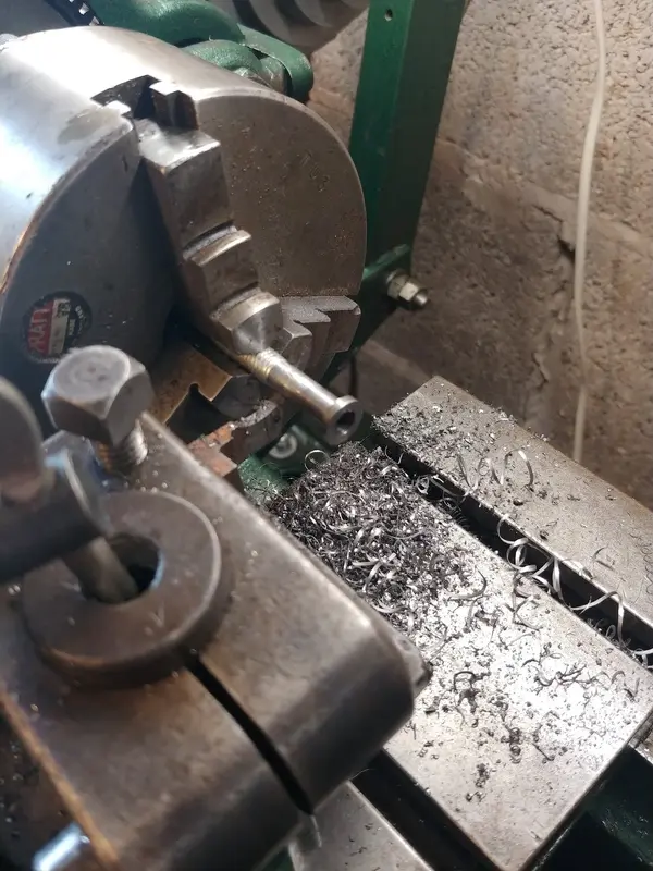

Yup same set up as mine although it mine is backwoods ...Ive just fitted cantis on to too.
so the two bits aren't actually stops just guides.
I can make one up for you if you like wouldn't take long on my lathe!?

Looks like great minds actually do think alike afterall..
Ive just fired up my old girl 😁
Nice chuck btw....mines a bugger....or more likely just buggered 😆
