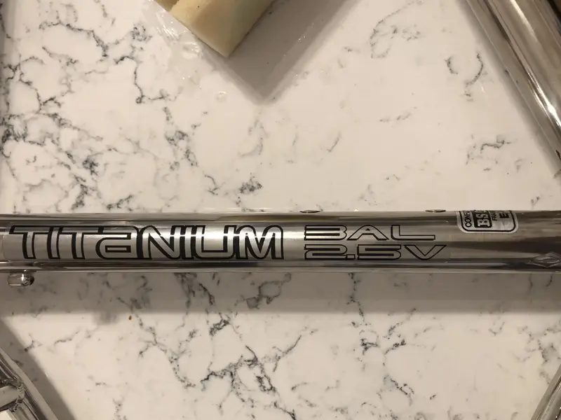

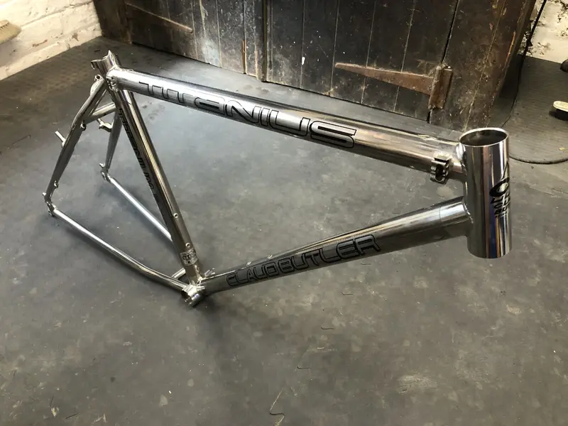

Quick last weigh-in after complete strip gives us a base line of 1701g… ;)
Right, on with the graphic application… soapy job this one as the clear panels won’t take any prisoners… :shock:

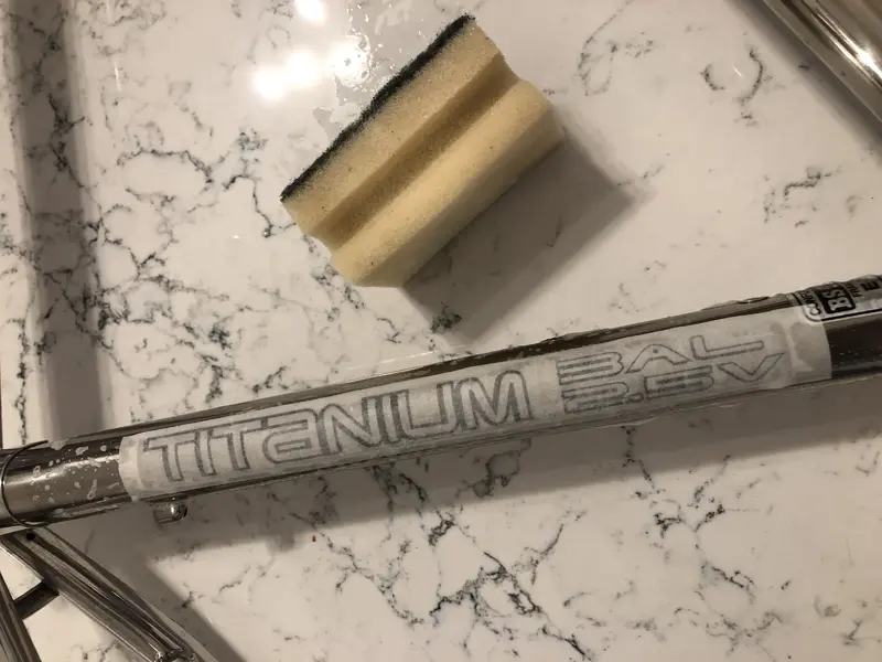

If you’ve not attempted this before, don’t worry, its not rocket science and easier than you might think.
Job one, pop a little washing-up liquid on a clean washing up sponge & add water.
Apply a liberal amount on the area where you want the sticker.
Apply the sticker, then carefully wipe over the carrier paper with the wet sponge.
When the paper is sodden (a few minutes) carefully peal back & remove the carrier paper.
Adjust the placement of the sticker, then hold in place carefully with one hand whilst easing out the water gently with a piece of kitchen roll folded up into a pad in the other.
You can’t get it too wet… the only consequence is it takes longer to dry out
You may have to go over it a number of times during and after, if it drys with some edges up, don’t panic, carefully push/rub them down. :cool: IMG_5710.jpg IMG_5694.jpg IMG_5693.jpg

Re: 1995 Claud Butler Titanius #F4100632
You’ve applied water slides :shock:
How are you going to protect them, when I’ve used slides all of mine have been sealed under at least three coats of clear
Go and get your readers... :roll: . these aren’t water slides, they’re good old printed vinyl with a thin layer of clear polycarb laminated on top to protect the print... artwork by me, production by Gil of course.
The wet application is pretty standard. :cool:
Okay this is a new one on me - your placing normal sticky Decals on a frame that’s soapy wet and they stick :shock:
I just can’t square this in my mind - all instructions I’ve ever followed for applying normal self adhesive decals have insisted the surface is clean and dry
