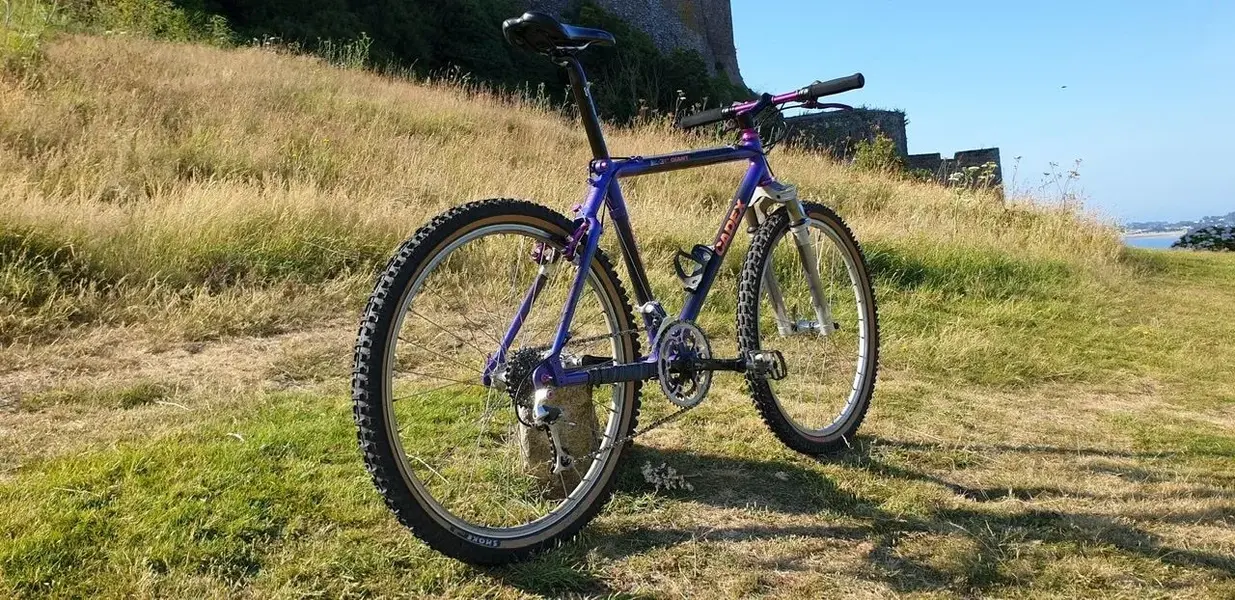

Just built this front wheel for my slowly going nowhere Dawes Escape build... couldn’t resist the temptation to see how it looks in the Cadex though... this bike is going to be a looker, I think. :cool:

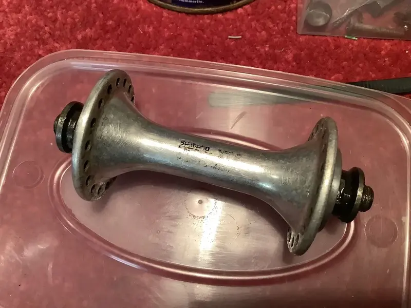

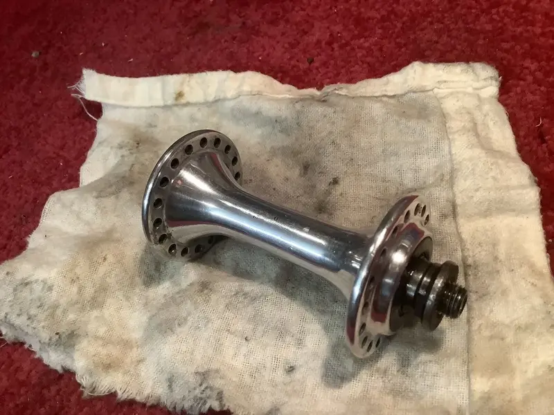

Slow progress... lots of projects vying for attention... Rescued the front hub (36 hole deore XT) from the knackered campag rim. Cleaned up and polished it. Cones unsurprisingly are well worn but fingers crossed it’ll be smooth enough with fresh grease and new balls. Would be good to re-use it if possible.
Tomorrow I’ll put the hub back together and measure up for some spokes. Found a good DX rear hub in the parts bin in matching 36 hole flavour to make a set and have ordered some brand new cheap, black Mach 1 rims off ebay.

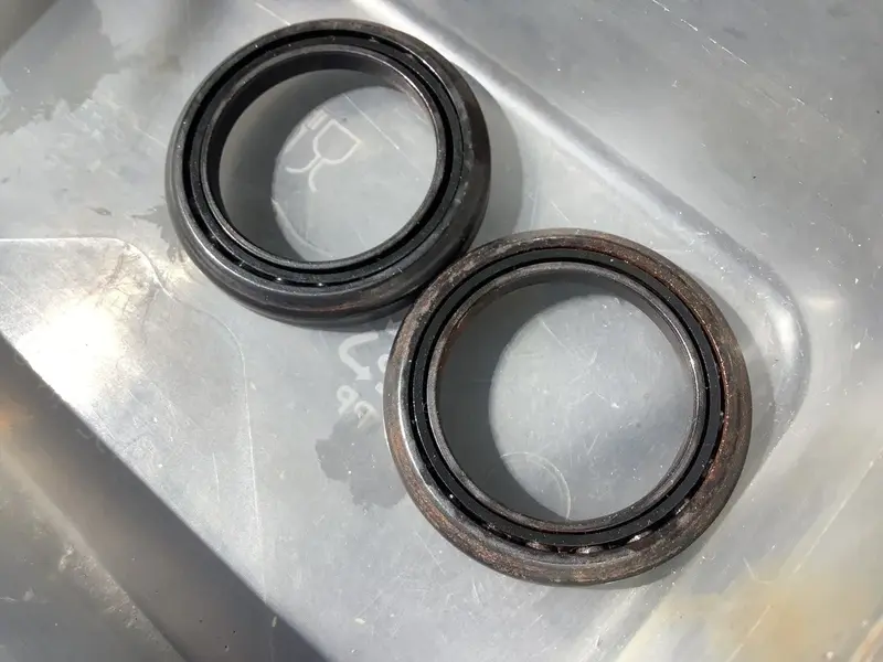

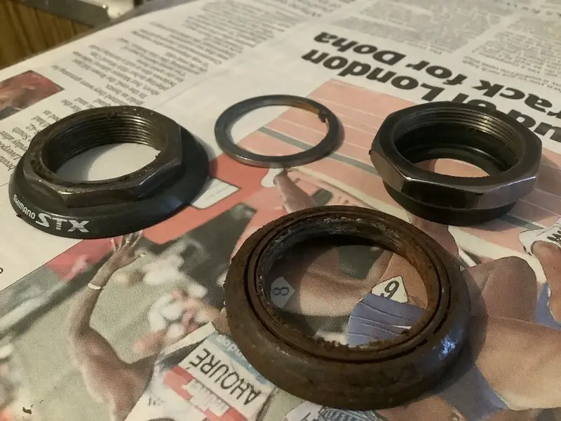

Headset is an STX with cartridge bearings which have seen better days. Presume it’s not original... For now I’ve given the bearings a good soak/clean and will try to squeeze some fresh grease in them once they’ve dried thoroughly.

Packed some fresh grease in to the bearings, which actually seemed to work ok...unfortunately though once all back together it’s obvious they are well worn.

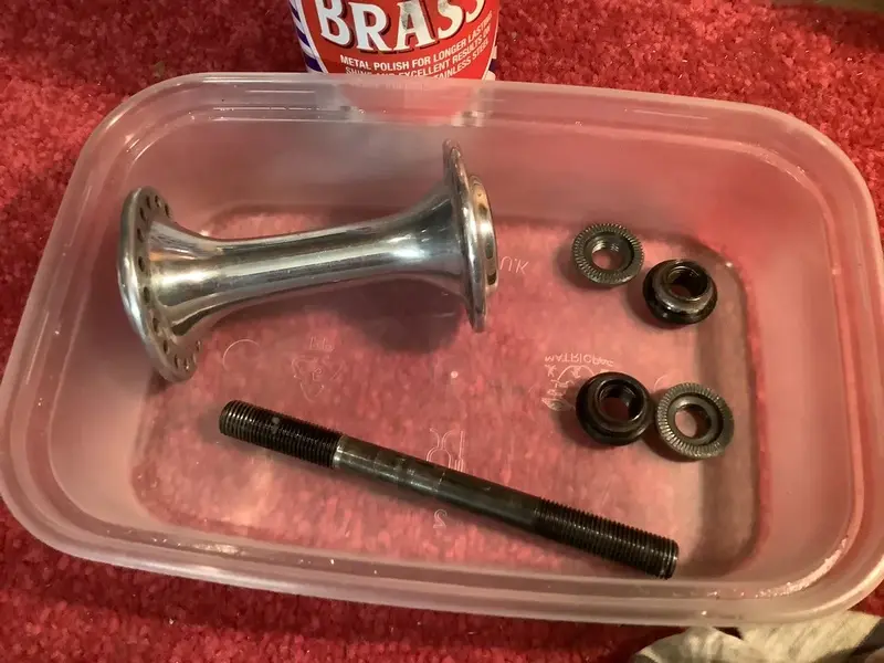

All right then... glass of cider and jungle on the radio... fresh grease and balls in the original front hub. Despite the obvious wear it’s actually come out pretty smooth - unlike the headset... gotta love vintage XT.

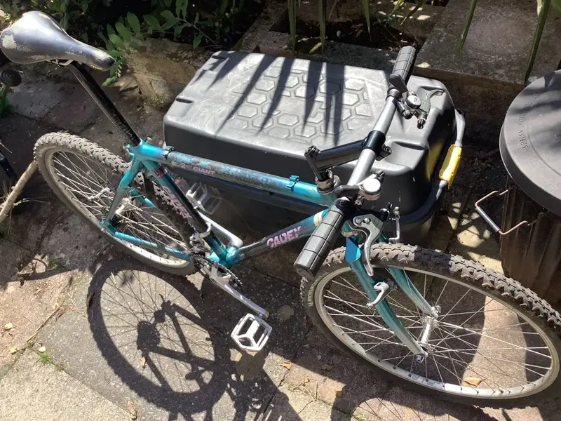

Saw a guy riding one of these (very quickly) a couple of days ago so decided to get it built. Might just fill a niche in the collection as a light, fast and go-anywhere rider. The blue clockwork can be the more trail focussed bike.
Decided to follow the path of least resistance i.e. use bits I’ve got no real use for and not really worry too much about getting it period perfect. Frame is pretty rough anyway so there’s no point in aiming for a BOTM build. As such I decided to retain the LX V-brakes it came with to save some bother.

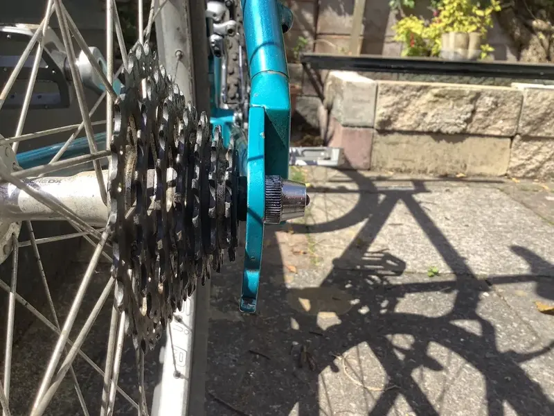

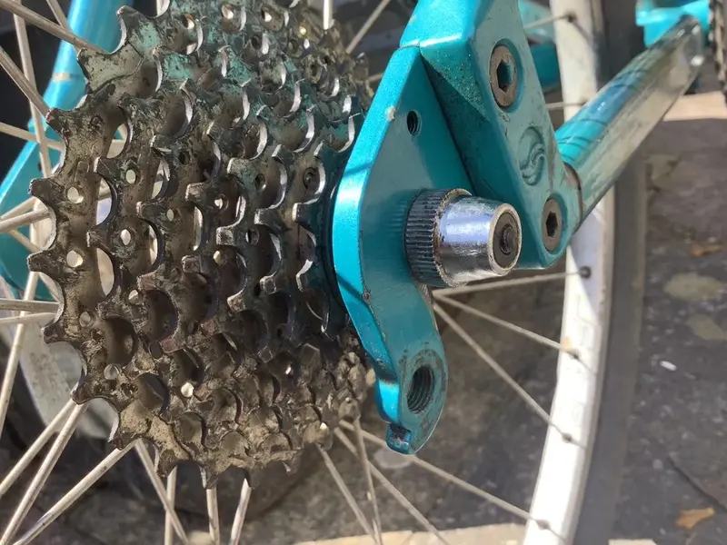

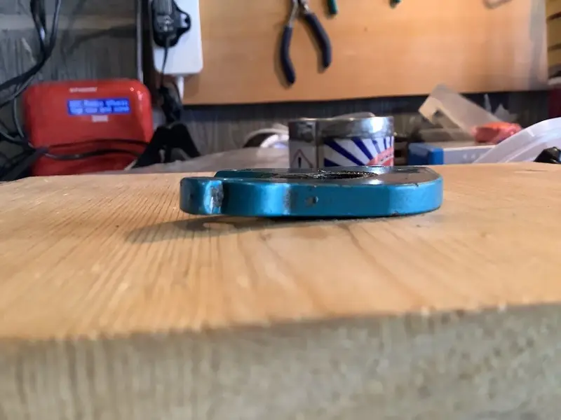

It’s coming together nice, I think. Will be very light. Unfortunately though I failed to notice quite how badly bent the gear hanger is. Fortunately as this is a bolt-on part it should be solvable one way or another, but the technique I would use with a steel part (i.e. hit it with a hammer to flatten it out) seems not to be doing much. I went easy, sandwiching it between two bits of wood, but bashing it didn’t do much, if anything.
Any thoughts on how best to attempt straightening? Not sure whether heat would help, and whether bending it (e.g. using a vice and gripping it with an adjustable spanner) or hitting it is the way forward... could try hitting it without the wood on a harder surface - not too bothered about the paint but would be nice not to ruin it completely...
