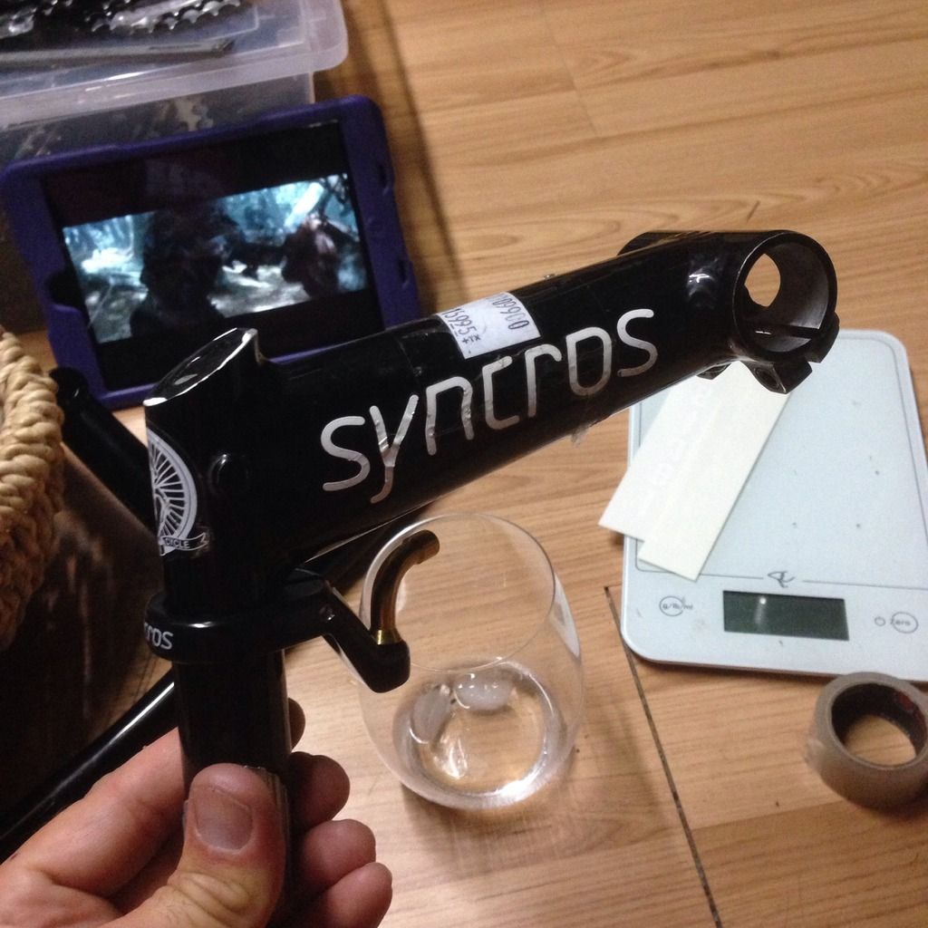

I started weighing stems! I don't really have a ton of options outside of a pile of Syncros stems and the one Salsa. Neat looking at the variations of the stems.
I think I can get close to the weight of the bontrager stem/bar.
Stems: 1 1/8 Quill
Syncros 2nd Gen Noodle 130 mm 10 degree rise - 251g
Syncros 2nd Gen Noodle 120 mm 5 degree rise - 240g
Syncros 2nd Gen Noodle 130 mm 10 degree rise - 261g
Syncros 2nd Gen Noodle 145 mm 5 degree rise - 267g
Syncros 2nd Gen 160 mm 15 degree rise - 250g
Syncros 2nd Gen 140 mm 15 degree rise - 230g
Syncros 2nd Gen 140 mm 0 degree rise - 227g
*all Syncros stems measured with pro series ti bolt and aluminum expander (saves 35g)
Syncros HangDoggy - 35g
Salsa Roller Stem 125mm 15 degree rise - 375g
Leaning towards the 140mm 15 degree rise Syncros stem with the HangDoggy. Close to the lightest and I think the fit will be better for me. Probably need a few rides to sort this.

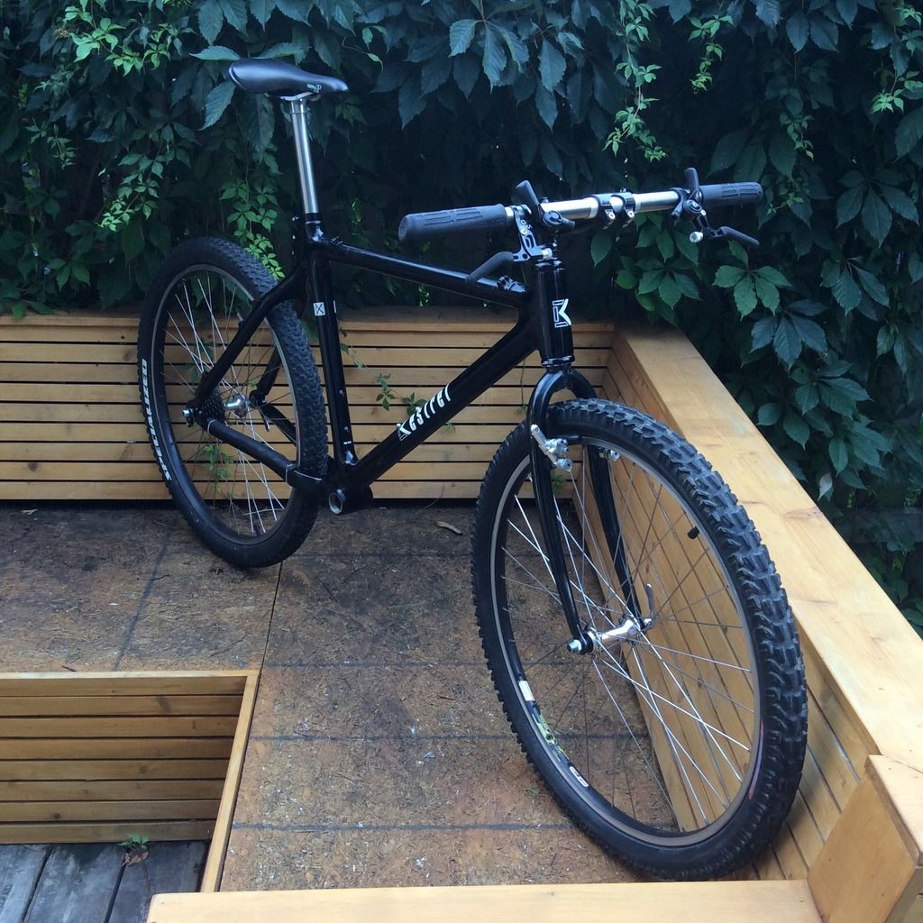

Just a bit of a sizing mock up. These aren't the wheels I'll use or the seat. The fit will be nice with a zero rise syncros. I saved 15 grams using a ritchey hanger over the hang doggy and another 4 grams using tioga grips over the ODIs.
Loving the black and ti :cool:
Next steps are to have the cranks and brakes redone in Ti colour and sort some wheels. So far my ringle/217s are the lightest but they are blue ... Won't match.

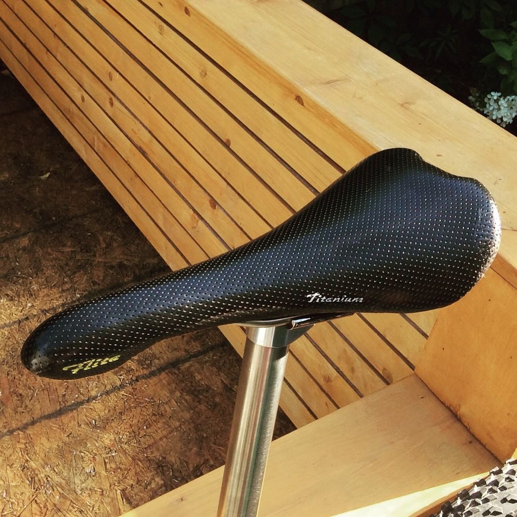

Weighed a bunch of saddles:
1992 Wheeler Ti - 253g
1992 Selle Flite Ti Perforated: 213g
1989 Avocet Racing - 402g
1990 Avocet Racing II - 368g (really a rebadged Selle Turbo)
1990 Avocet Racing - 405g
1991 Avocet Racing - 397g
1993 Vetta SP Vanadium - 207g
1992 Vetta SL - 199g
1992 Viscount Ti - 207g
I have a perforated 1992 Vetta SL on a bike in storage I can use, but until then ...
Perforated Selle Flite Ti ...
Like it :cool:
