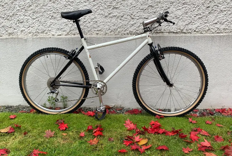

The chain is on!

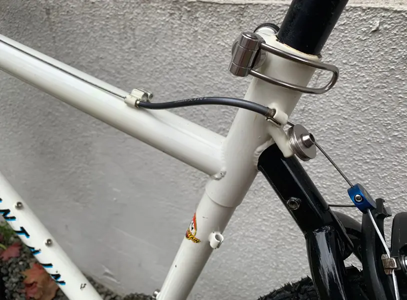

This is my first U-brake experience so I had to play around with the springs awhile to get it right. The cable routing on this bike is also very funky! That little roller is cool but the layout is problematic. I couldn't get the oversized 6mm XT housing to make that last bend cleanly. A little piece of 90's XTR housing worked without too much induced friction so that's that...
Soon to the mountains!

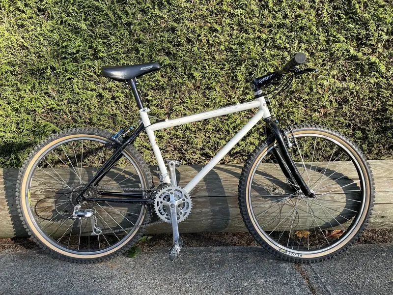

The bike is basically done. It rolls, stops, and now shifts.
Finally ready for a proper fall trail ride!
-The 5mm Shimano housing was worth the wait, it cuts nice and feels like quality.
-Black Oury grips added
-The Dear Head friction shifter works great on the 8spd cassette but is rather touchy. I may go for a more standard 7spd indexed set-up.

-Paul Funky Monkey cable hanger (modified to fit 2mm cable)
-Brodie magnesium spacers for the Gorilla booster for a secret exotic touch
Hi Bside,
I'm curious about your Funky Monkey mod.
I'm thinking of trying to make one compatible with http://boulderbicycle.bike/Vintage-...-1-set-inners-and-the-6mm-housing-MT-092.html
Were you able to retain the barrel adjustment feature? Or did you have to toss the barell adjuster all together?
My Thanks,
AGH
Rolling up to a one year update from my last post.
There have been lots of little changes...

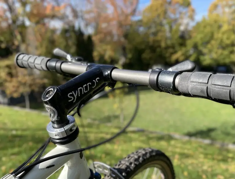

-Black Syncros stem w noodle!
-Gorilla Head lock
-Brodie U-brake booster (mid 90's version) and Scott Superbrake pads
-m730 XT pedals (awesomely massive!)
-Wolber AT18 wheelset w DX hubs (Wheeltech)

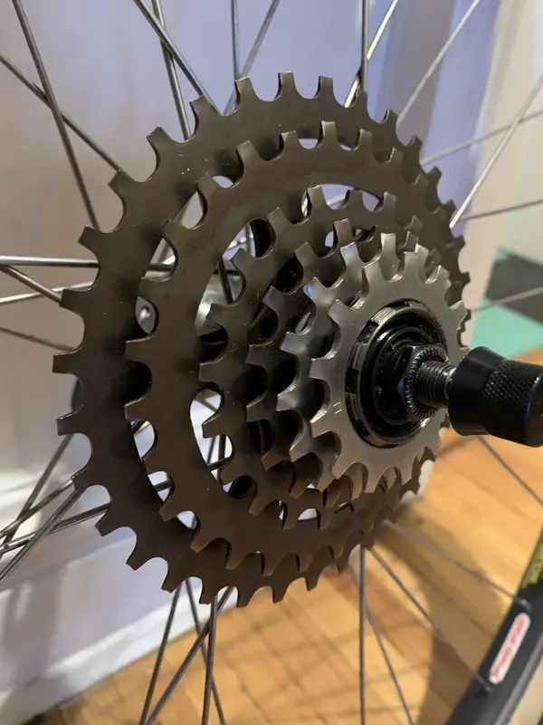

-Uniglide 6 speed cassette
-XT thumbshifters
-XT derailleurs
-Blackspire chainrings
-American Classic seat QR
-T-Gear ti twist wheel QR's
pics are coming

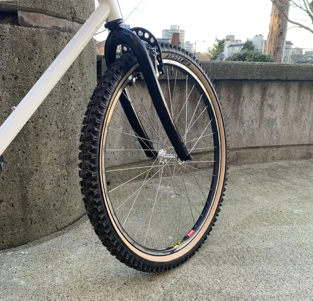

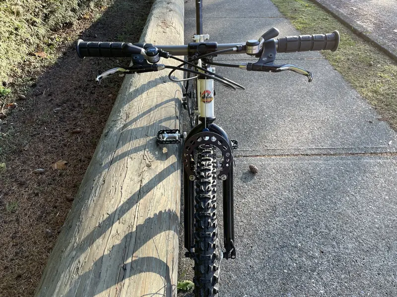

Current spec:
*1990 Rocky Mountain Blizzard - 18.5" - 2237gr – serial #673
*Tange Big Fork -Rocky branded
*DX headset w Gorilla Headlock - NOS
*Syncros stem w noodle 120mm - Canada!
*Titanium flat 22.2 handlebar - maybe Merlin?
*Oury grips - NEW
*XT front cantilever brake w NEW KoolStop pads
*Gorilla front arch
*XT U2 rear brake w NOS Scott Superbrake pads
*Brodie CNC rear arch
*XT 2.0mm brake cables/housing – NOS
*Onza chill pills – NOS
*XT brake levers
*XT 6 speed SIS shifters – NOS
*Shimano 5mm SIS housing - NEW
*XT Front and Rear Derailleur
*6 speed custom uniglide cassette 14-34T – NOS
*KMC X8.93 chain – NEW
*XT cranks w Blackspire rings 24/34/42T – Canada!
*Syncros double row BB - Canada!
*XT big pedals
*Wolber AT18 dark ano rims / DX hubs w NOS T-Gear Ti QR’s
*Panaracer Smoke classic 2.1 tires – NEW
*Rocky Mountain leather saddle / Velo
*Syncros 1st gen seatpost - Canada!
*American Classic seatpost QR
