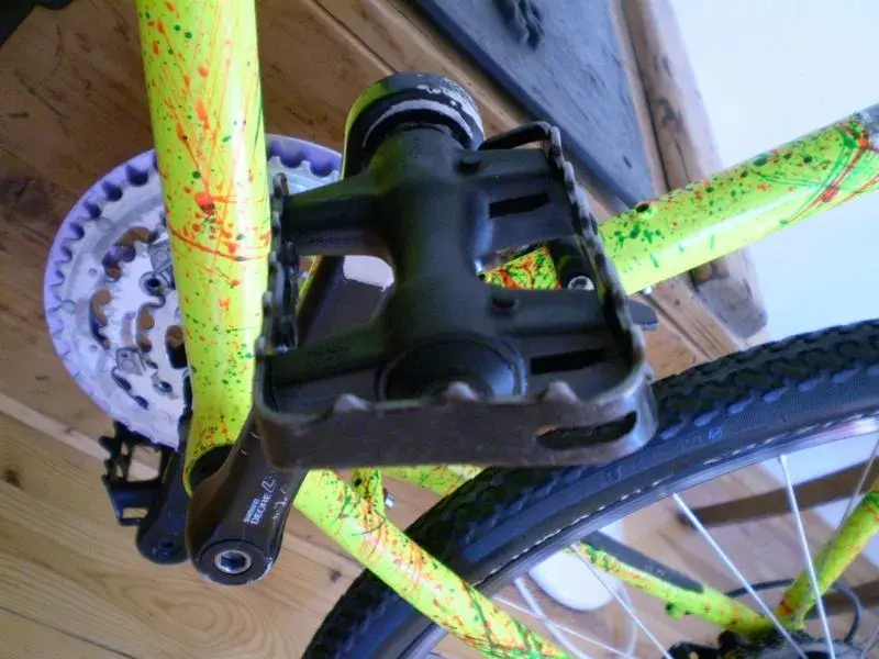

I still can't believe it but i really found a matching single pedal. I was very close to giving up the search and simply buy a complete pair for crazy money.
It's like Wyclef Jean said: "The good things come to those who wait."
I'm really happy today. :)

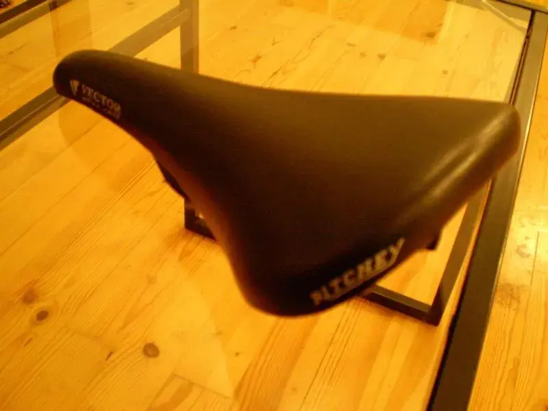

So now i am the proud owner of a TAQ 33 aluminum patent seatpost.
I have also bought a Ritchey Vector Plus Rail saddle a while ago which looks superbe..at least to me.

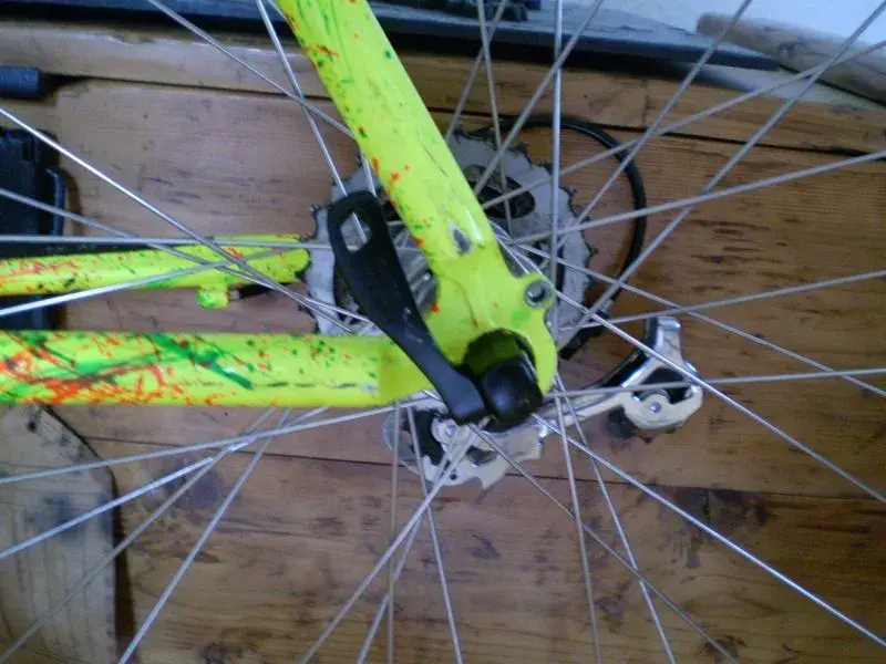

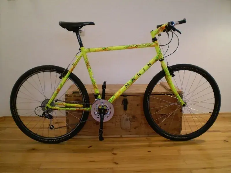

Since there were no parts missing i spent the whole night with stuff like cable adjustment, missing tools, the idiots guide to set up a front mech and of course searching for all that little stuff that has to be somewhere around here like link wires and so on...
..and finally this build is finished. :cool:
It's raining outside but i gotta go now ride my bike :!:

Looks fantastic mate :D
Would still get rid of that bash ring though.
Let me know how it rides.

Thx for the comments.
@Chris: It was a slow first try out ride. All the time i thought i had forgotten to tighten something and i was ready to take a free flight over the handlebar :)
But there is nothing else to report that the bike rides really well.
I was surprised that the shifting really works spot on.
The bike is doing fine..but i'm out of order..got a bad cold from riding in the rain. :roll:
