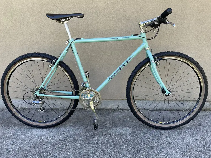

Couple changes made recently, firstly I had to remove the Klein MC1 as it was needed for an actual Klein build and managed to grab an excellent condition silver Syncros Cattleprod and lightweight Kona bar for pretty cheap. The silver stem actually suits much better I think especially with the silver seatpost.
Not sure why I waited so long to fit amberwall tires, I think they really brighten it up especially with the black rims :cool: 😁
Hi all - very new to this. I see that the orginal pics had a bottom pull front derailer and it was modified to a top pull FD - is that right?
Hi @Hannly Welcome!
You are correct. Back in 1991 top tube cable routing was gaining favor with component makers still to catch up. Some frame makers used a pulley near the bottom of the seat tube so the inner cable could be routed down the seatube, through the pulley and then directed back upward into the derailleur anchor screw the usual way, while others like Bianchi elected to run a longer piece of cable housing from the top tube cable stop, then through a cable management loop brazed mid way down the back of the seat tube, then through the modded cable stop piece attached where the Shimano cable anchor screw was, then the inner cable could finally be anchored with a small screw into the bottom bracket shell!
Crazy! I never liked the way this looked as the vertical section of black cable housing never sat very straight (OCD) so what I did was add a simple cable adjuster from a spare derailleur complete with a nut to the loop brazed midway down the back of the seatube allowing the use of a top pull front derailleur.
Much cleaner I think :cool:
